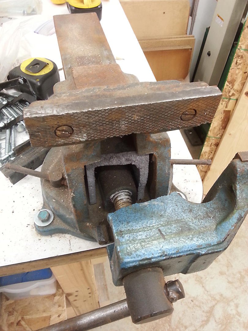

About 45 years ago my brother gave me a made in Poland (we're Polish) vice for Christmas. This 6 inch jaw heavy duty monster has served me well over the years taking all the abuse I could dish out. But today I think I pushed it a little to far, or maybe it's just getting old and weaker like me. I had some 1/2 inch, 1/16th" wall tubing that I wanted to flatten the last 2 inches of. Started out OK but then I realized that I needed a little more leverage. So I grabbed an 18 inch long pipe to help crank her in. It did flatten the piece out enough to put the jaw teeth marks in it but I could still see a little gap and so I cranked a little more and snap (refer to the picture). I can tell it's some kind of cast metal and there's plenty of room for some surface weld to stick out but I'm not sure if this kind of metal can even be welded. Or should I turn it into a boat anchor and look for a new vice. Comments (satirical ones also welcomed) please.

I don't know about an an anvil, but we have both broken a vice.
   / Can this be welded? #3
   / Can this be welded? #4
That's scrap. You better box it up and send it to me. I'll dispose of it for you. :)

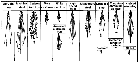

That looks like cast iron but you could grind on bottom for a spark test and see if it's cast steel. Either "can" be welded. If you've never done it, pass it off to someone else to weld.
Edit: Ops! Looks like I was a minute behind.
Thanks for the replies so far. These might seem like a dumb question to some of you , but how do I tell if it's cast iron or cast steel? And I should have mentioned that I only have a Mig welder and an AC arc welder.
   / Can this be welded? #6
   / Can this be welded? #7
Likely cast iron. Another way to tell is see if you can cut it with a cutting torch. I think a good lasting repair will be questionable at best.
   / Can this be welded? #8
Take Your angelgrinder and do a spark test to determine type of metal
painti132.gif.
My personal preferans on cast iron is silver solder, if cast steel 7018
   / Can this be welded? #9
Any chance you could fabricate a new piece from steel using the broken end clamp piece being held in with steel??
   / Can this be welded? #10
I would bet it is cast iron but too know for sure you would need to do a spark test. I have a color chart like the one posted here but I don't know where mine is. I have welded a lot of cast with nickel rod (ni-rod) and have had good results, the best results ??????????? I feel the best way to weld cast is with oxygen/acetylene and cast iron rod. The cost is prohibitive though unless you do a lot of it. cast rod is $8.00 a pound and comes in 50 pound boxes and I have not found a welding supply that will break a box. In one of shield arcs links you can buy one pound for $29.00, sounds a little like robbery to me. What ever method you choose you will need pre heat and a slow cool down. Many years ago I once put a cast piece in my kitchen stove for a slow cool down.
