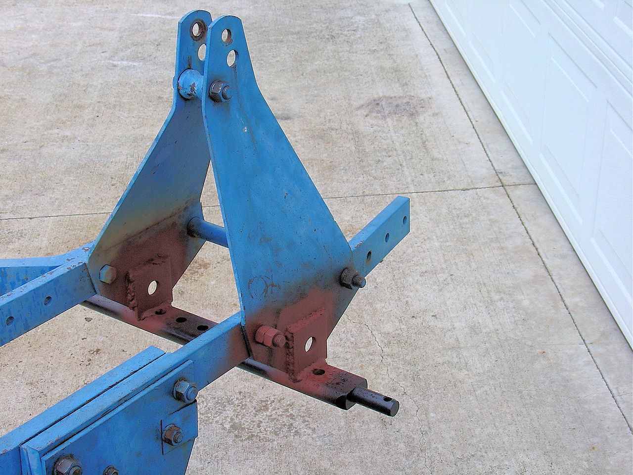

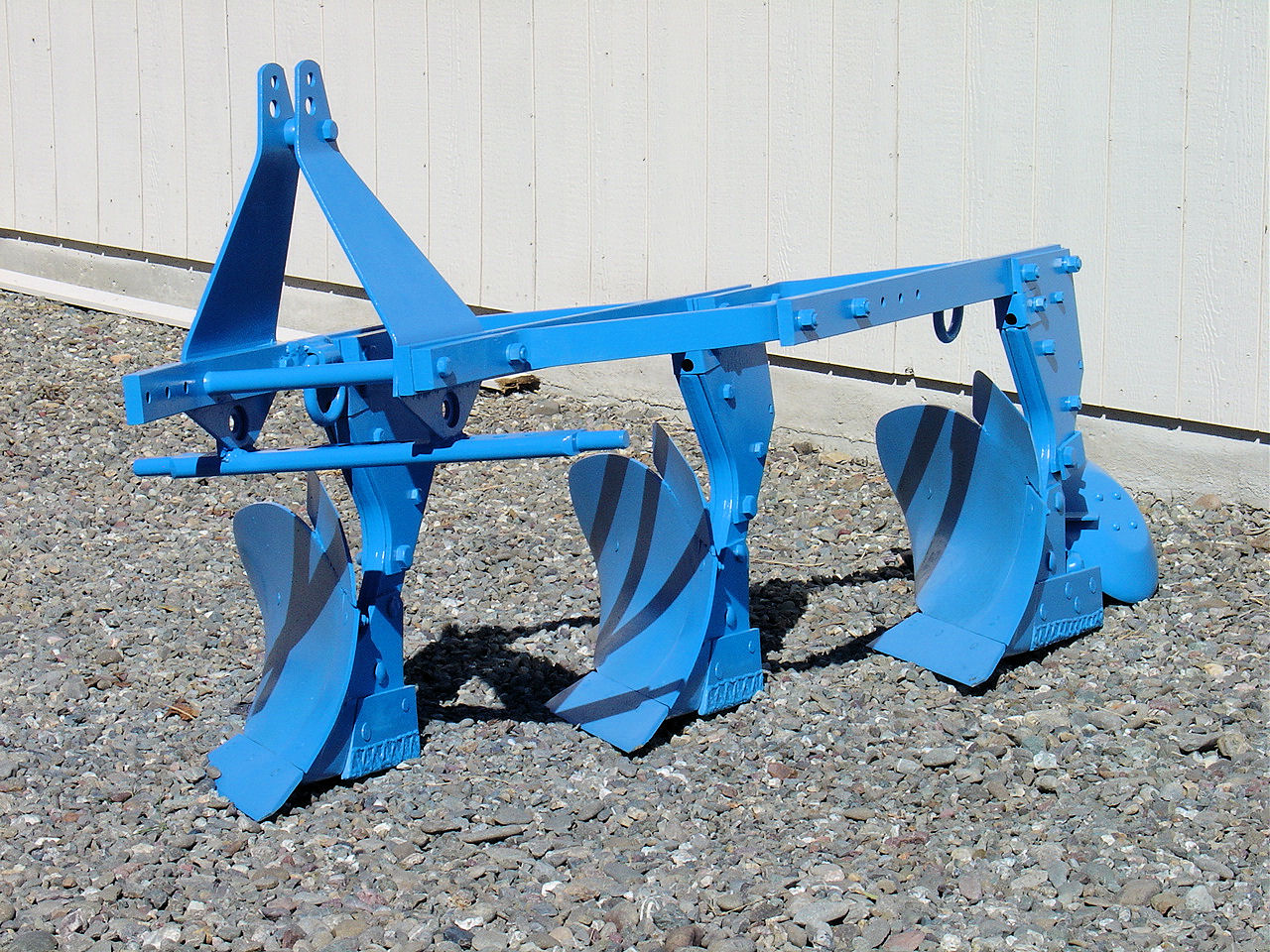

That measurement all depends on the tractor. For example, my L3650 would lift higher than my M7040.
Plus, most tractor's 3PH has adjustment holes for putting the pins in different positions to adjust the lift arms.
Here is a photo of a CAT 1 Ford 101 plow that was modified for CAT 2 if that is of any help. Wish I could help more.
