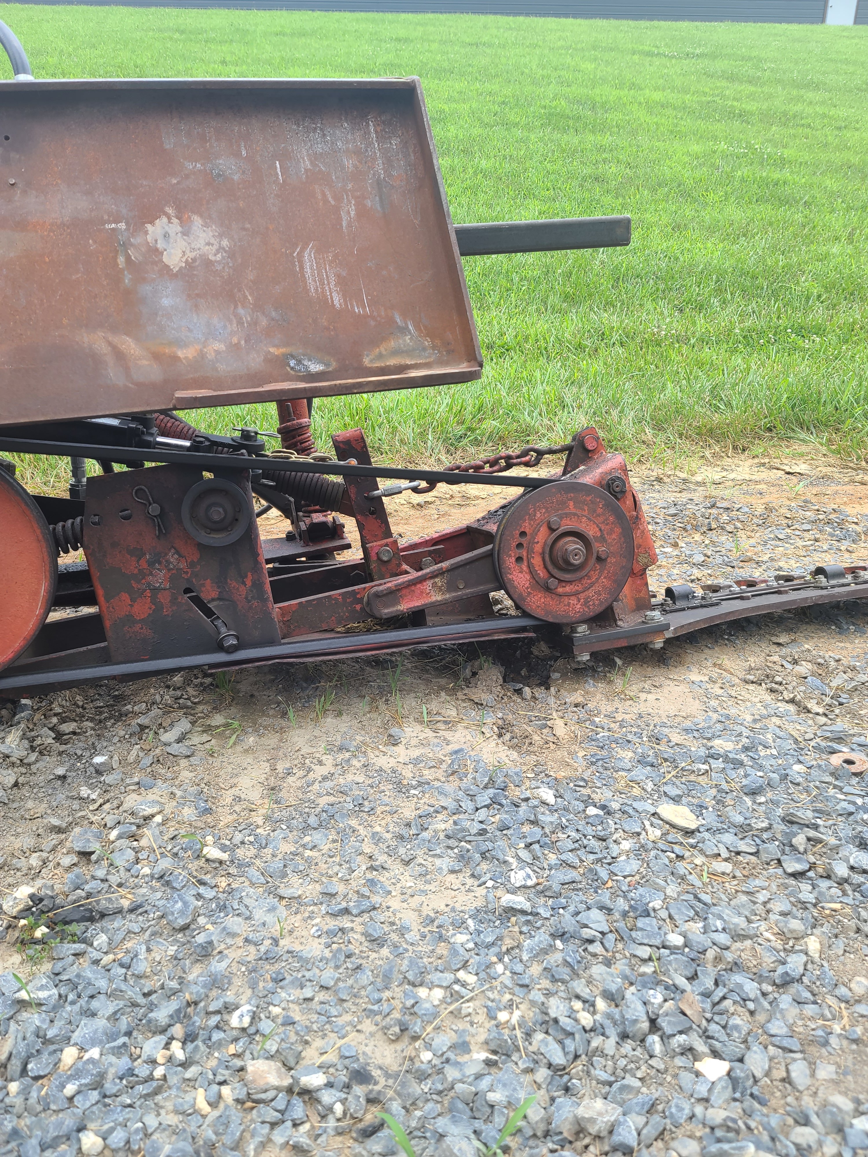

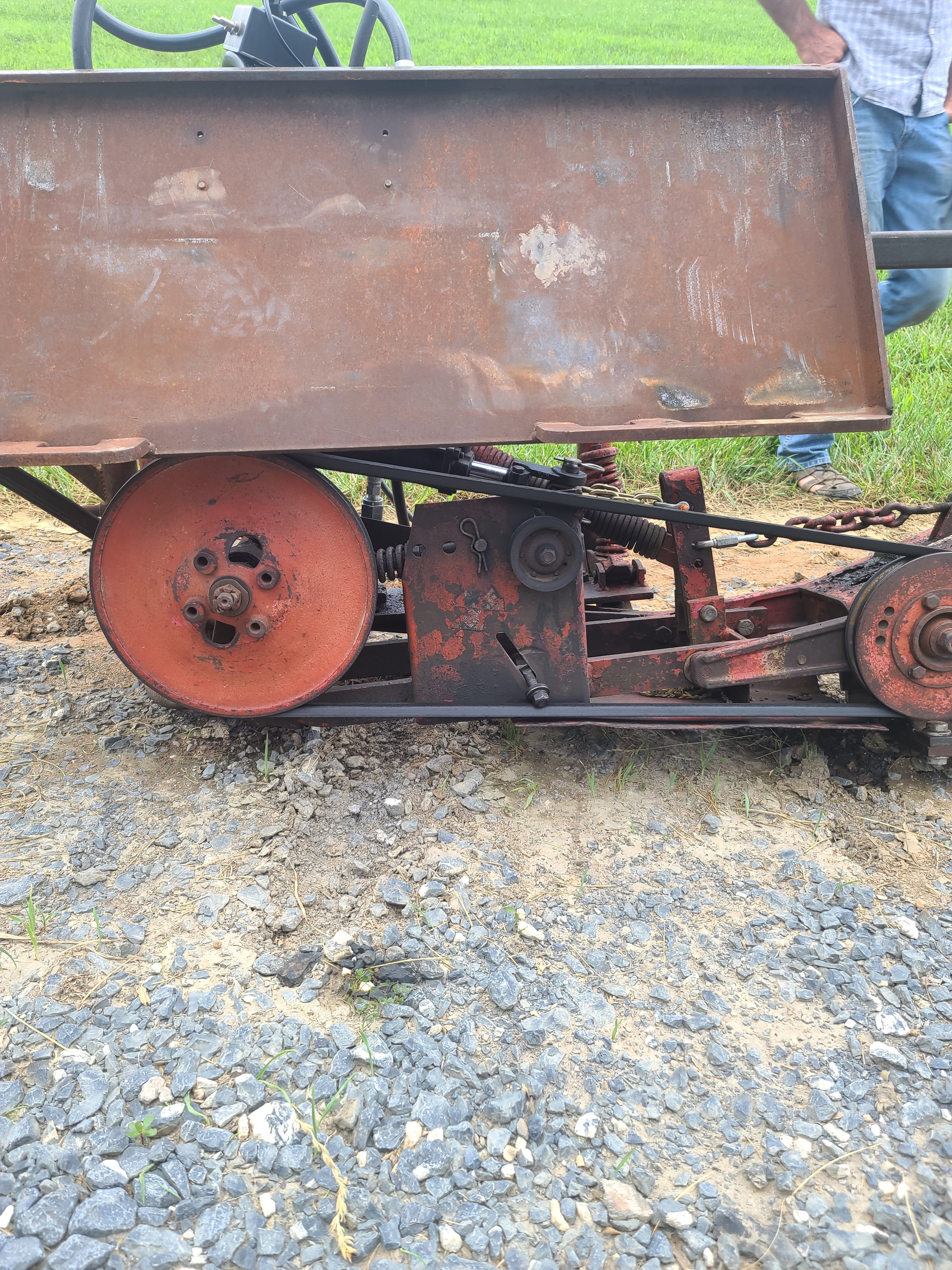

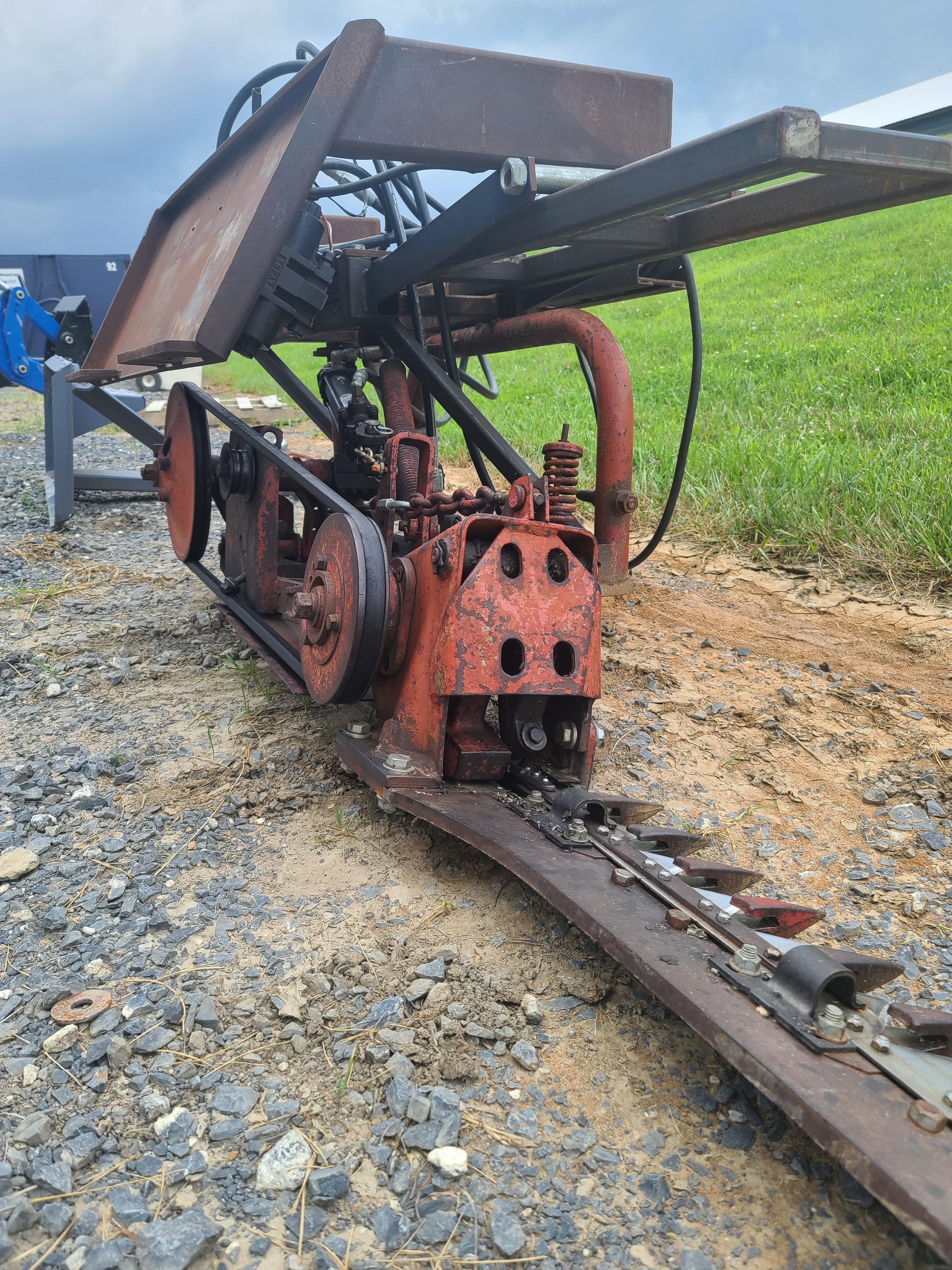

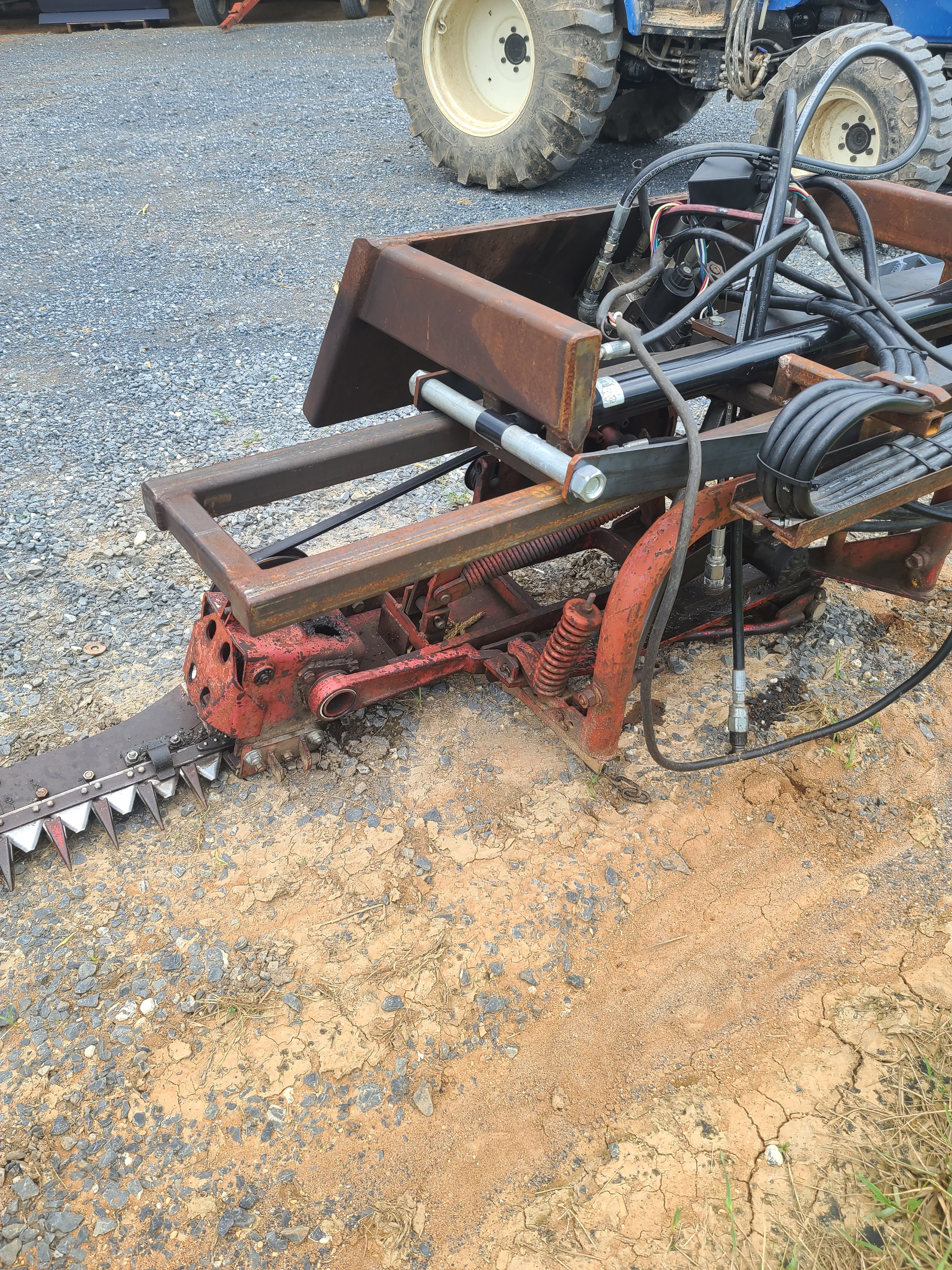

I am trying to assist my neighbor in identifying his sickle mower. I wasn't able to spot any identification marks.
We are hoping to source some parts to fix it if possible.

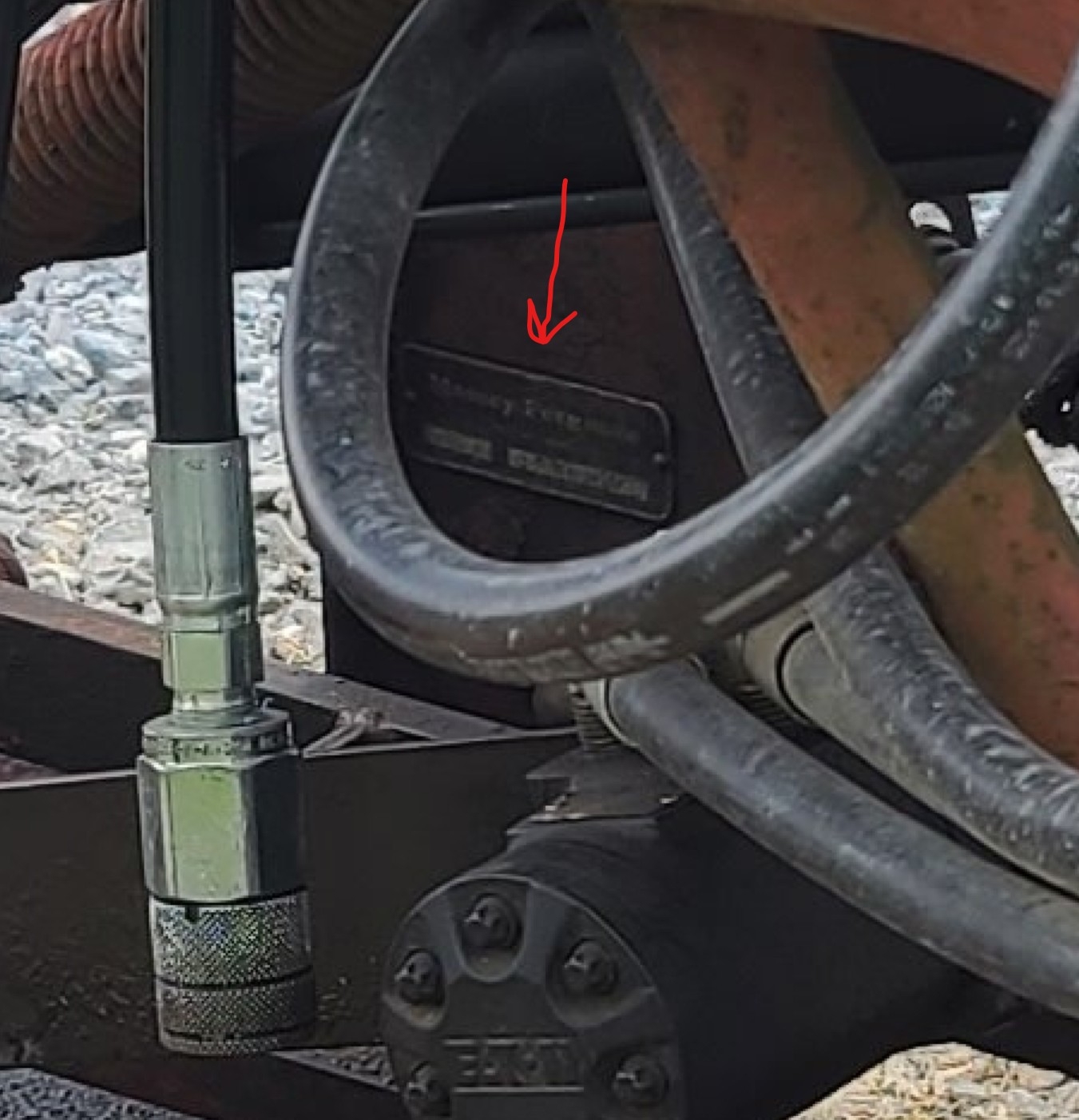

Read the tag.The tag that says Massey Ferguson left of the hydraulic motor in 2nd picture. It's a Dyna-Balance mower?
Barry 1, That's kind of a snarky statement - I looked all over "all" of the pictures and saw no tag saying Massey; perhaps the op didn't either?

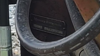

   / Can someone identify the make and mode of the 7ft sickle mower? #4
I'm not at all sure it says "Massey Ferguson" but it looks to me like it could:
Those more familiar with that brand's trademark could probably be more sure.
   / Can someone identify the make and mode of the 7ft sickle mower? #5
Massey Ferguson visible in the photos. Perhaps those on a phone can't see it large enough. Looks like an older MF 41 Dynabalance.
   / Can someone identify the make and mode of the 7ft sickle mower? #6
Looks exactly like mine and it's a massy . Got some parts . . .
