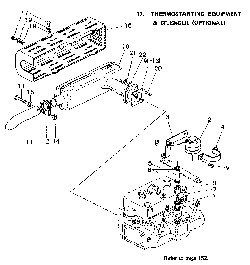

Can someone explain a Thermostart. I have a YM165D and it has a thermostart. There is a small bowl that feeds into the air intake. What do I do to use this.

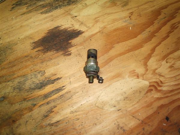

The thermostart element has a heating element in it like a cigarette lighter. The small reservoir has diesel in it. When you turn the switch to the thermostart position the element gets hot and diesel drips on it causing a small fire which heats the air in the intake manifold makes it start easier. I just had to replace my thermostart element because the heating element was burned out.
If I'm not correct someone will help straighten us out.

Here is a picture of the Thermostart that I had to replace in my 2020.
