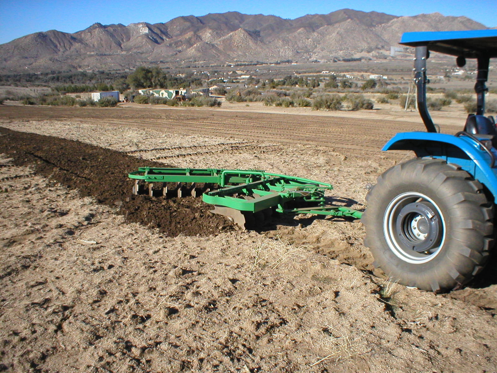

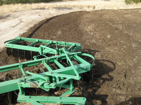

Hi I have been asked to disc this 7 acre field. The weeds are about knee height. I don't have a disc, however the gentleman has one on site I could use, if my tractor can pull it. The disc's measures 21" diameter, almost 7 feet wide. My tractor is M7060HD12 with R-4's.

If I looked it up correctly your tractor is 70HP that disc used to be pulled by under 40 hp 2wd tractors.
That looks like a pretty flat field and dry, if it has a wet hole be prepared to pull the hitch pin drove away and then chain back to it to pull it out.
Even with R4s you could most likely pull it in 2wd if you wanted to.
If that's heavy sod with those light disc add some weight and figure 4 passes,

Your tractor will pull those in that field and barely even know that they are back there. :thumbsup: You may find that you will want to take your loader off though. :confused3:
This is a set of Killefer disks also. In fact that's all that we have. A 6', an 8' and a 12'.

Remove the FEL just for the "compactness" of it. No need to strap on any weights. Your tractor won't even break sweat pulling that disc. My little Ford would handle it in 2wd.
I've never saw a disc like that. Pretty cool actually. Not very effective in today's world but I'm sure it was a beast when it was made. May have been pulled by an "A" at some time, definitely by a "720". "4020" owners would just laugh at it. :)

That disc will be a breeze and you could probably pull it at high idle. The disc is so light it wont do much good, however and will likely not be worth the effort. I'll bet it won't even cut some of the grass. Sorry to be negative but that's my experience.

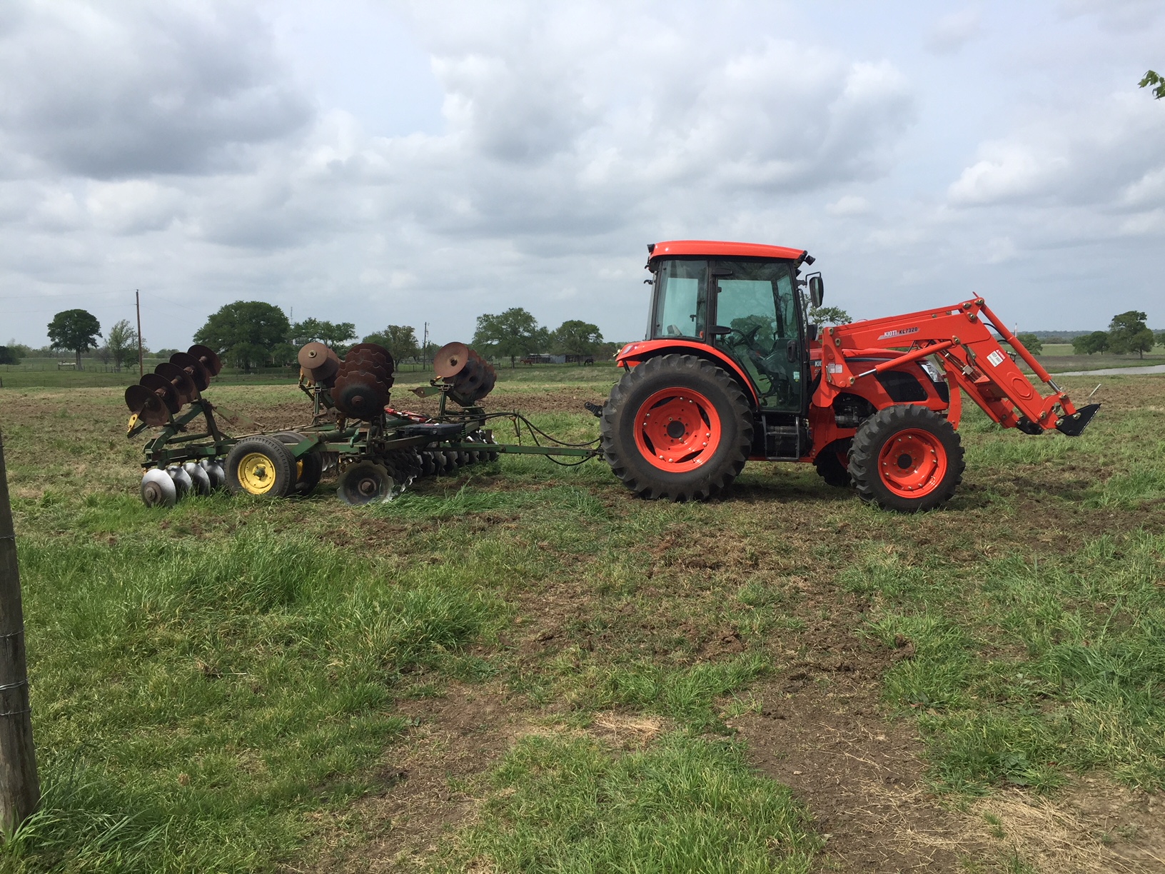

I have the Kioti 7320 which seems to be their version of the 7060 and am discing and planting 30 acres of old cattle pasture now. I borrowed the neighbors John Deere folding disc (12 foot wide folded and 20 when it is open) and I am not having any problems with it. When I started about a month ago the grass was very low and two passes with the disc really broke the soil up nicely. Then we had two good and heavy rains so now I am running the shredder cutting low before discing to get decent results. If the disc gangs on the 8' JD that was offered turn freely you will probably want to add some more weight to the disc (400 pounds would be a good starting point) to get it to really cut. Just remember that it is really not that many acres so treat it like a good learning experience if nothing else.discing.jpeg
