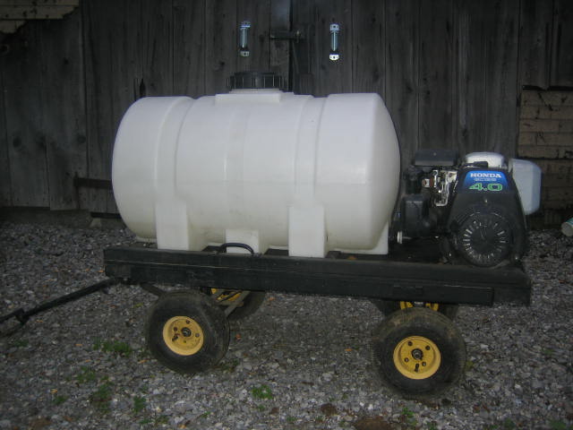

I'd try it before giving up. Couldn't the 20psi rating be to ensure the pump has enough water supply from a hose? I know my manual says to run the pump a maximum of 3 minutes without using the spray wand as heat buildup may damage the pump. A portable washer is handy to have. The flow rate on mine was higher than my well output, so I used a 35 gallon tank to feed it. No problems.
