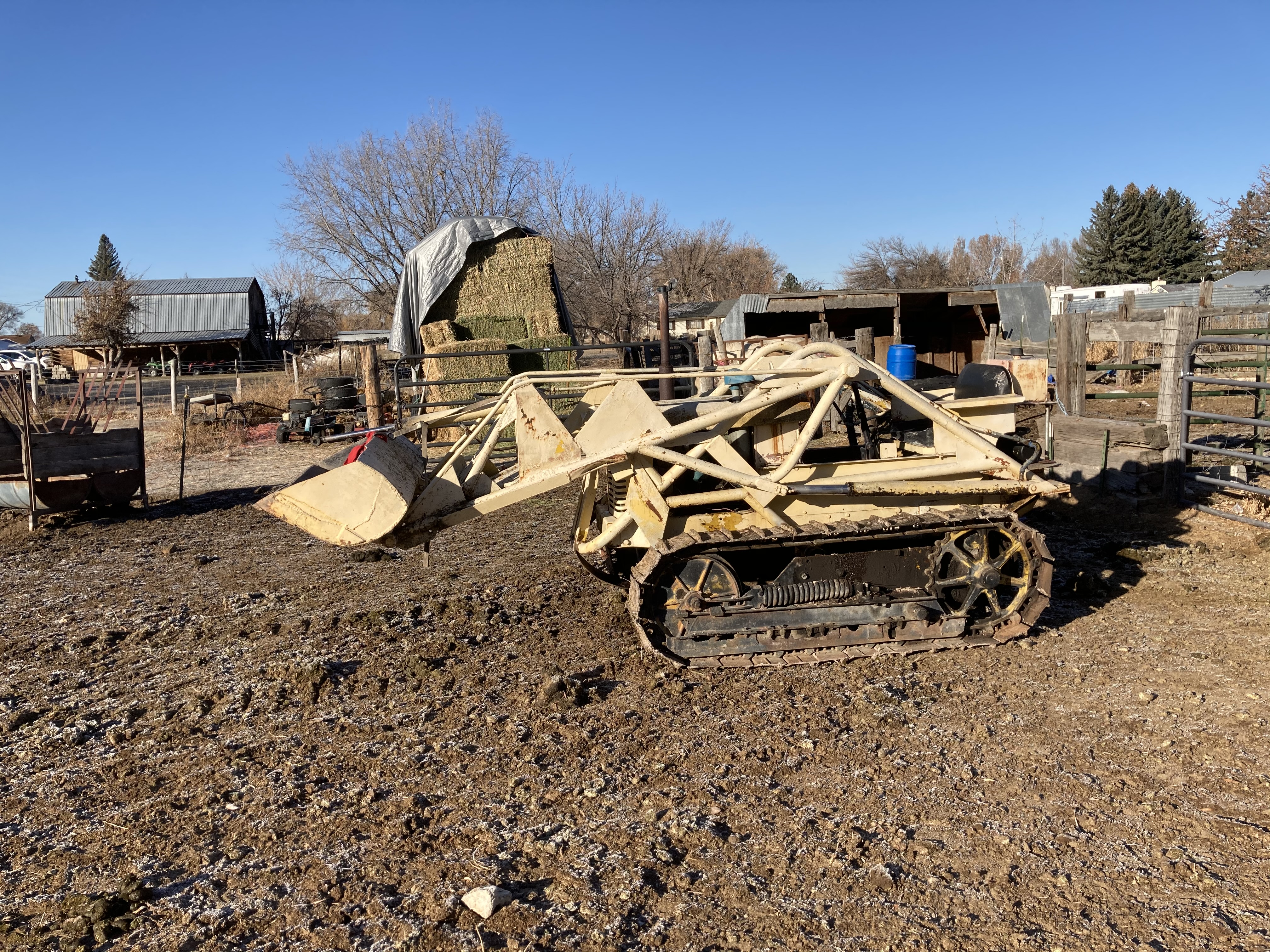

I posted about my new Terratrac GT30 crawler over in the "Projects" forum. Now that the initial enthusiasm and congratulations have worn off it's time to start the work of making it into what I need. The machine came to me with an electric hydraulic pump mounted behind the seat... Think dump trailer type pump. Not only is the wiring WAY wrong for it, but I'm sure the duty cycle would be wholly unfit for doing any real work. I'm going to re-build the hydraulic system with a real, engine driven pump and a real valve. I'm sure I'll need help along the way, so expect regular questions here.
The pump is from Surplus Center... 0.82 Cubic Inch. it should give me somewhere around 6-8 gpm at working engine RPM.
I have an old Jacobsen golf course reel mower that I'm scavenging parts from. It has a 3 spool valve, lots of hoses, filter, tank, etc.
I have two problems at present that I need to figure out:
1) The pump "does not have an out board bearing to support the shaft adequately under side load (pulley or chain drive) conditions." I was planning to belt drive off the fan belt, so I'll need to include some kind of bearing. I think I can figure this one out.
2) The real question that I have right now is that the lift cylinders on the sides of the loader are single acting. My valve is set up for double acting cylinders. How do I use a double acting valve on a single acting cylinder? Is it as easy as just blocking off the port that I'm not using on that spool of the valve?

You don't want to block the unused port in the valve, the pump would go over pressure relief every time you operated the valve in that direction. Plumb the unused port on the valve to tank, that way when you're moving the valve in that direction, the oil is just going thru the valve, out the extra valve port and right back to tank. Not the most efficient way to use a valve but you've got to use what you've got.
Put a filter of some sort on the unused port on the cylinder to keep dirt out, a rear end vent for example......Mike

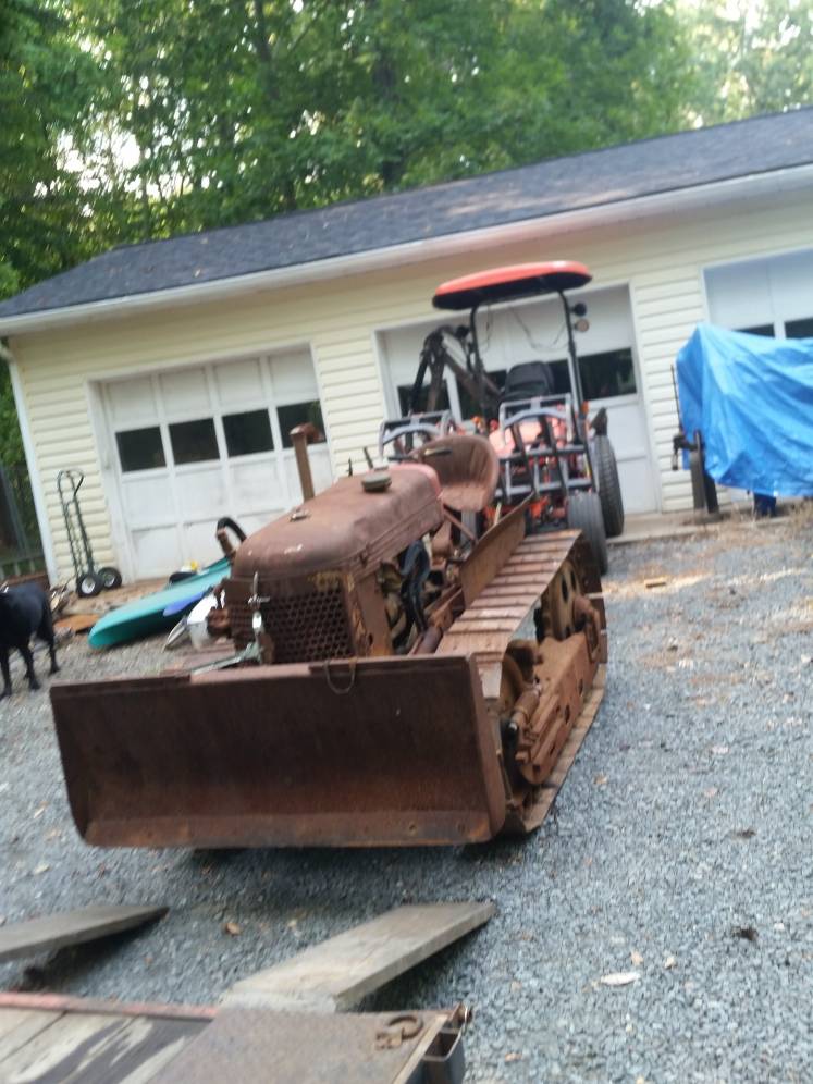

Thats a cool little crawler, I have a Oliver OC3 that I one day hope to restore.
On mine the hyd. pump is driven directly off the front of the crank, not sure if you'd be able to do that on yours. Mine has a heavy duty grill that allows a little more room for the pump.
