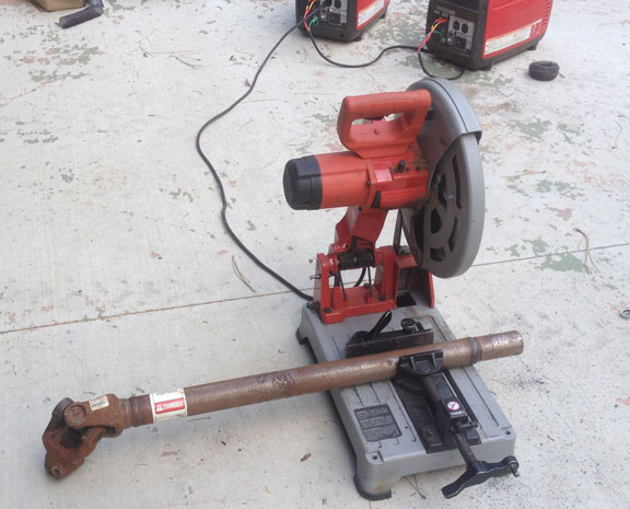

I did exactly what you are saying ( if I understand you correctly ). Here's how I'd describe the PTO shaft that I shortened. It has a yoke (with a u-joint) on the tractor end, and a simple PIPE connecting the middle, and a splined insert welded to the other end. I shortened it by cutting a section of the pipe out of the center. Then welded it back together.
385726d1407513845-can-i-shorten-solid-splined-pto-shaft-cut-jpg
Yes you can do this easily. Clamp the pipe sections in an angle iron to align it, and tack it lightly 3 or 4 times around and convince yourself it looks straight before welding the circumference.

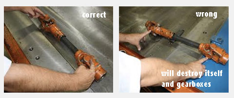

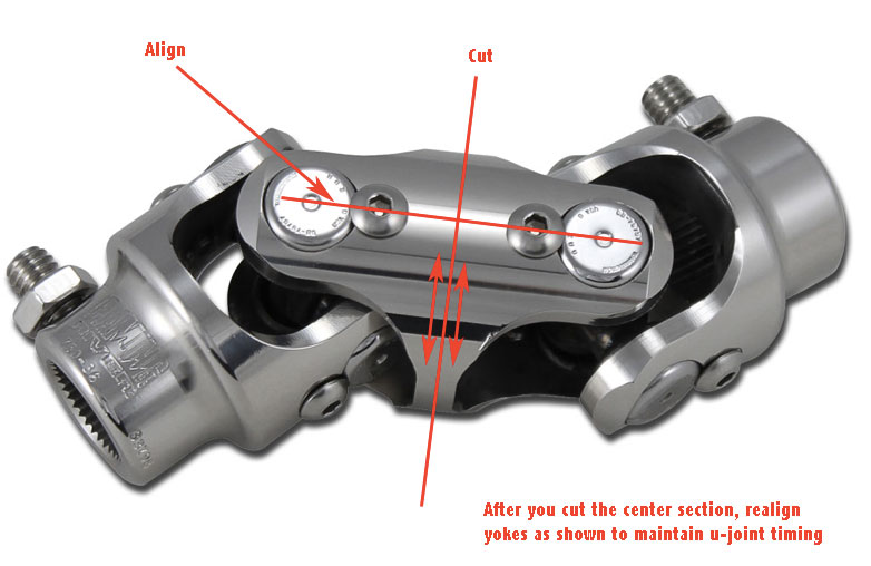

There is a very important detail here, FAR more important than a few hundredths of runout in alignment. You MUST maintain the "timing" of the U-joints. This is not a critical alignment, but you should be able to get it within 1/8" or 1/16" pretty easily and it will run perfectly quiet (for a PTO). It's not a driveshaft on a Cadillac.
But if you happened to weld the two halves together a full 90 degrees out (the worst possible chance alignment), you could destroy the shaft and all your u-joints and woodruff keys and crossbolts and gearbox in a matter of minutes. See the pic below, which shows a similar arangement of timed u-joints. You need to look at your shaft parts and end up with an alignment (of the yokes) like this.
385718d1407512214-can-i-shorten-solid-splined-u-joint_timing-jpg
When you bend a u-joint, it causes a pulsation in the rotational speed. For something like a steering shaft, this is not very important, but for a shaft rotating 540 RPM this is a big deal. When a pair of u-joints are timed, each u-joint 'cancels' the pulsation of it's companion u-joint. In the special condition that the input shaft and output shaft are perfect parallel, this cancellation is "perfect" (to "zero"). Normally any attachment that uses u-joints will try to maintain the input shaft and output shaft "parallel" over the course of their range of movement, and especially aligned "parallel" while doing the "work".
OTOH, if you set (in error, and welded) the u-joints 90 deg out of alignment, each u-joint's pulse would ADD ontop of the others pulse, and the pulses are DOUBLE intensity. Around zero degrees, it will be a quiet shaft.
Heres another pic, not welding but showing how u-joints splined together, the proper spline position must be chosen upon assembly. Typically a PTO shaft will have a "rectangle" assembly that ensures it can only be assembled 180 degrees out (=zero) and never 90d or 270d.
