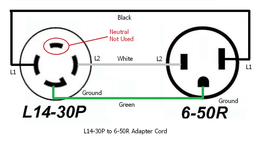

My generator has a 30A 120/240 VAC L14-30 female plug...
Can i make a convert or plug to plug my 60-50R male from welder? Is this considered 220 volts?

The problem with "small" generators and big intermittent loads (welding) is if generator throttles down between welds when you strike arc the current inrush for welder is probably more than the immediate recovery of generator (RPM/Voltage/amperage) and then a lag in voltage/amperage....This is caused by the rotating mass of the generator is not large enough (inertia) to maintain the load and generator bogs.... If generator has constant speed setting use that..... The rule of thumb from my paying attention to more knowledge people than me on a welding forum is when using generator it should have reserve of about 50% more power capabilities than the actual load... So if load from welder is say 40 amp at 240 volts (corrected: 9600 watts) generator should be rated at about 60 amps at 240 volt (corrected: 14400 watts) output capable...
And yes if you have the 4 prong plug twist lock ( L14-30) on generator 2 of the prongs will be L1 & L2 which will have 120 on each leg, one prong will be "ground" (safety) and one prong will be neutral IF You are using the two 120 volt legs as individual 120 volt loads... IF using 240 volts you do not use neutral, BUT you should have ground connected through for SAFETY...
Outlet on generator...
Wiring of adapter cable ..

Edit to add: Recommend making/getting adapt and not changing plug on welder, if you change plug on welder, you sort of dedicate welder to generator unless you change receptical in shop or where ever you plug it into wall...

I didn't cut the plug off my welder. I bought some wire and made a short pig tail . added the male plug for the generator, and a female plug for the welder to plug into
