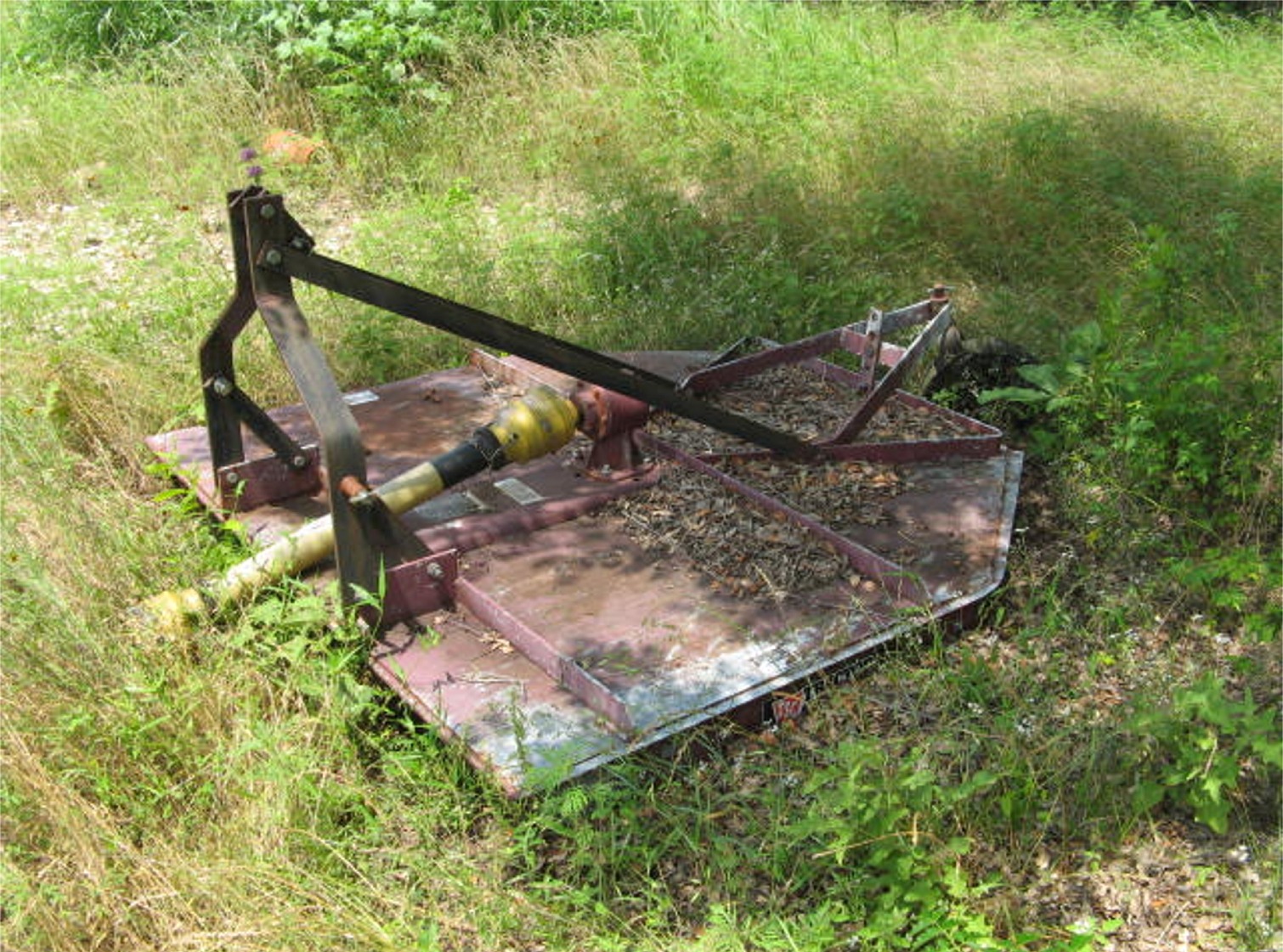

Unless it's a one-in-a-million TSC store, that won't be a Rhino mower. MOst likely a King Kutter brand. Light to medium duty. If the 950 will handle the weight, (and I THINK it will), you don't have to make a full width cut. Use 4' or 5' and let the rest lap over already mowed ground. That will reduce the hp needed in heavy grass to an extent. If it's "dirt cheap" (bought a load of dirt lately?) you can try it, then re-sell if it's not what you want. Maybe even make a few bucks! You MAY need a few front weights, or possibly fill the front tires with fluid for ballast if the mower proves to make the front end light.
Ideally, you probably want a 5'er. I use 6' mowers on 40 and 47 hp tractors. In SOME conditions, the 6' mower gives them all they want.

Here's a photo to clear up which one we are talking about.
   / Can I run a 6' BushHog?
I should add that the housing is what measures 6 feet across. Could that mean that the blade length is actually 5 feet? I would think you have to have some clearance from the blades to the housing. I'll see if he can get a model number to verify the size.
