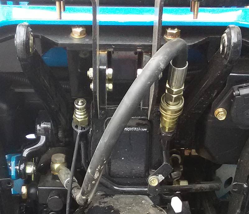

LS MT125 TLBM
There isn't a lot of wiggle room in getting the BH on and off with the way the QCs are positioned. It isn't difficult, but I'd like a bit more length. That and the way the 90 degree fittings are installed makes it slightly uncomfortable.
As it is now, the pipes on the tractor have straight fittings and the hose has a 90 degree L before the QC. That makes it a bit cumbersome to twist the hose to connect to the tractor.
I'd like to move the 90 to the tractor, then add a 12" hose before the QC, if that makes sense.
Current: Tractor > Pipe > QC --- QC > 90 L > Hose > BH
Proposed: Tractor > Pipe > 90 L > 12" Hose > QC --- QC > Hose > BH
I know it CAN be done, but is there any reason to be concerned about warranty issues?

could you just have longer hoses made for the BH? and tell them you don't want the 90 degree fittings? a LOT of parts stores now are making hydraulic hoses, but get ready to come off your wallet, they're not cheap.
   / Can I change the Hydro Connector layout? #3
I'd be curious to see a pic of how yours is set up. I do have the 90° fittings on mine, but real easy to get to, and the 90° actually makes it easier to push the fitting in. I did slightly move the hard lines (no more than maybe a 1/2") to put them "in line". I did notice that you leave your 3 point arms on when you have the BH in place. Does this make it tighter to work in the space? My 3 pt equipment gets taken off when I put the BH on. I find it much, much harder to get the FEL QC's reattached than the BH ones.

3PT doesn't get in the way of this at all.
I haven't tried to pull the FEL yet. I use it too much right now.
I wouldn't want to have anything made, but I could maybe add the 12" extensions to them. I still think I'd rather have the 90s on the tractor end though. I'm due for the 50 hour which they say means draining and refilling the trans fluid, so this may be the best time to open those fittings if ever.
