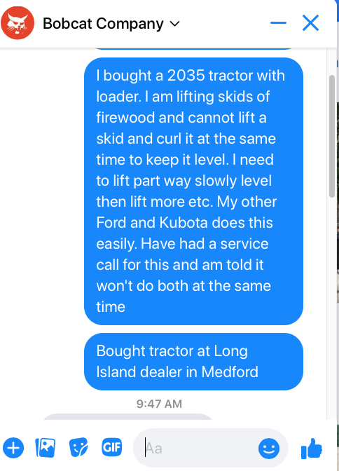

I have a new bobcat 2025 tractor. Under 10 hours still.
I had a Ford 1920 and I used it a lot to move firewood on skids!
I did 2035 tractor to demo for a few days.
When lifting a skid of firewood I would always start lifting and at the same time tilt the forks a little to keep the firewood skid level. I've been doing this for years and it works well for moving firewood skids and stacking them.
Now the new bobcat 2025. It doesn't seem to be able to do this.
I can lift. Then stop and tilt a little. Lift more stop and tilt a little more. I keep looking for the sweet spot where it will lift and tilt at the same time and smoothly. Cant tell you haw many half skids of firewood I've shook off the pallets!
I had a bobcat mechanic come and look at the machine today thinking it needed an adjustment and he didn't think it could lift and tilt like my old ford did.
He had never worked on a bobcat tractor before. Just studied schematics, tried tractor, and called someone. He said he would go back to the dealer and use their demo unit to try a few things.
Am I missing something or doing something wrong?

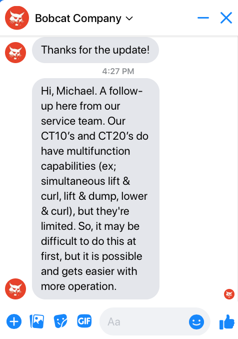

Got in touch with Bobcat Factory in Statesville, NC
Got this msg back from Bobcat in N Carolina
Did not really like the answer
