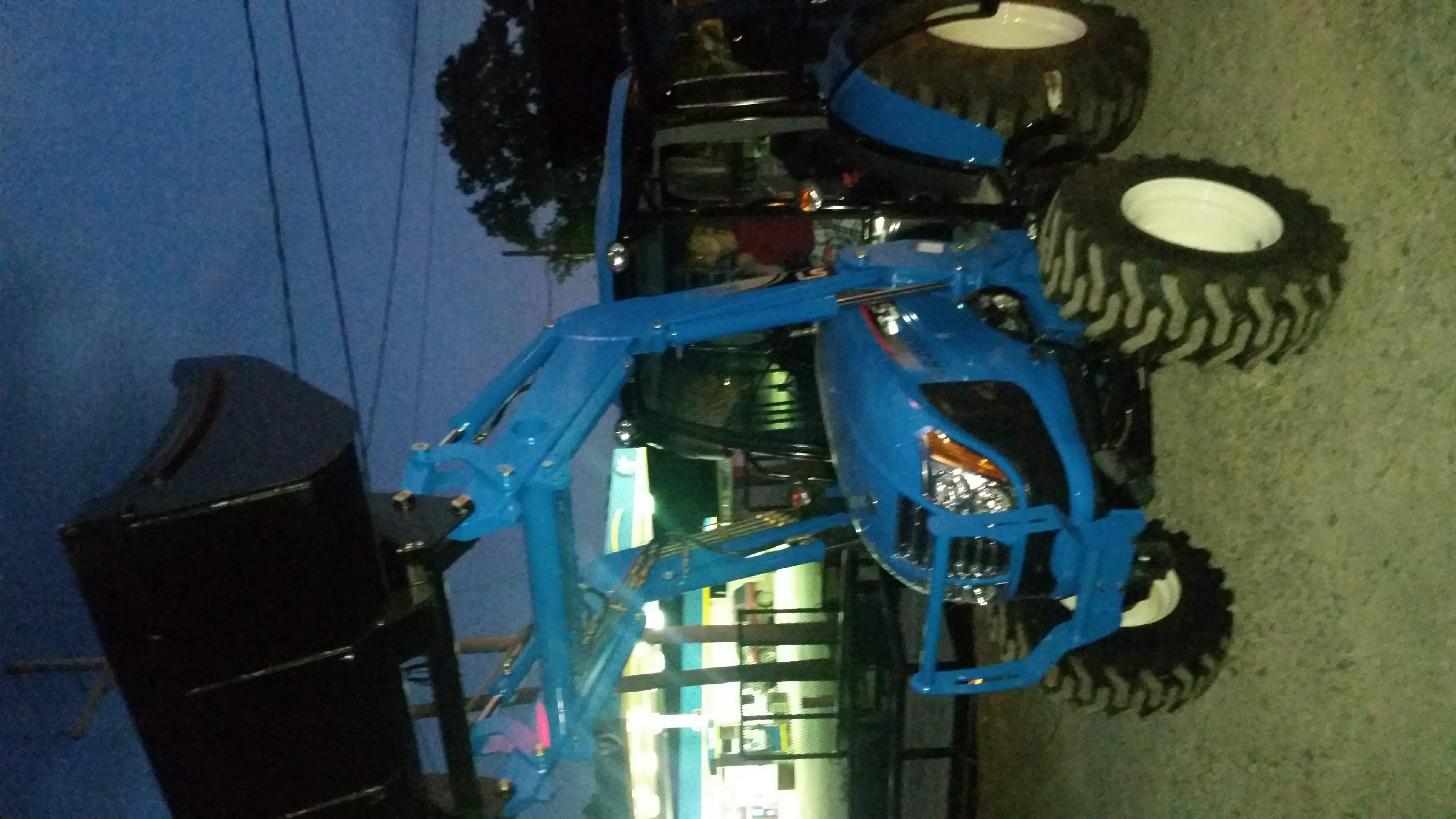

Thank you very much for the reply and vote of confidence. I have my deal all done just have to sign the papers and pick it up. I'm getting a 6' cutter, 6' grader box, and hay spear thrown in cheap. I did notice the range selector being pretty tight and a little clunky too, I'm thinking with a little use it will slick up. I too like a gear tractor for most work and I love having 16 options. I thought hard about getting an 8' dual spindle cutter and I may still bite the bullet for it instead of the 6'er. I have a 6' already but it's 35 years old, not sure how much longer it'll hold up. My other delima is R4 or R1 tires. It has the R4s now but I'm a little concerned about our wet springs getting in the feed lot. My 3930 has r1s and the front tires are so tall it never mattered how wet it was they find bottom. I've improved the lot with some dirt work and I'd like to think they would float on top, but I'm not really sure never had r4s. Not sure which way to go there...

Here's a pic I snapped yesterday

Congrats! That should work very well. A friend of mine has a Case D40 with R4's. I had it at my place in May to fix a couple culverts before I got mine and I nearly got stuck more than once. On flat ground it was fine but any muddy hills, forget it. I had to use the loader and hoe to claw my way out of one spot. My 4145 with the R1's climbed right up with no issues. Bear in mind that my rears are loaded and my tires are newer than his were but his isn't the only one with R4's I've seen with traction issues. Depends on your terrain and intended use. The R1's on the front of mine are relatively tall as well.

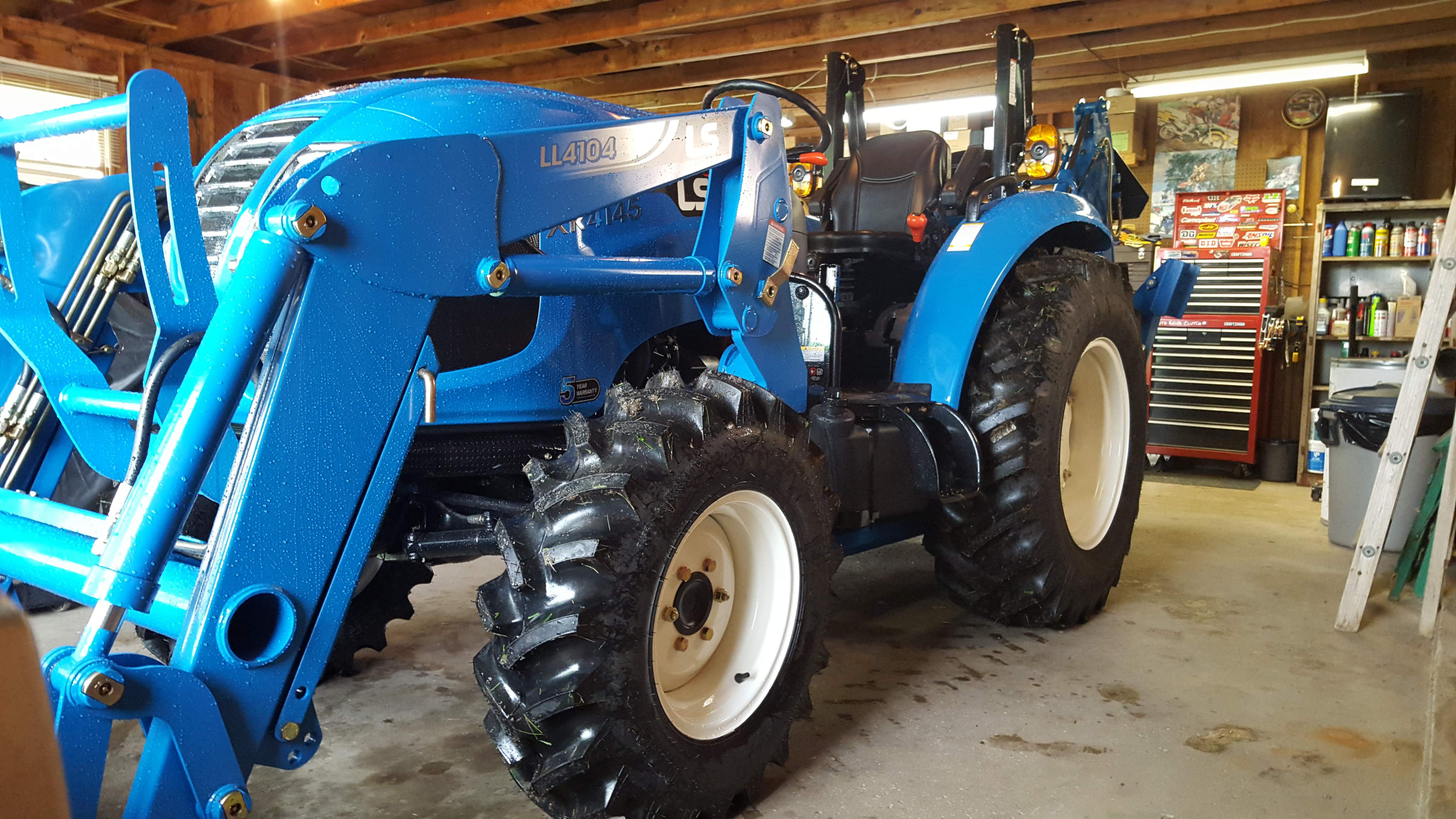

I think the R4's are a little wider tire and may stick out a little more but probably not much. It looks like you could easily unbolt the rears and swap sides to go wider but I think you'd have to remount the fronts to go the opposite direction to go wider there. Outside of my rears measures just over 66". I think the fronts are close to the same. They are just inside the loader bucket which is 72". I don't think I would ever need to go wider. The loaded tires keep the center of gravity down and it's pretty stable on hillsides. This is a pic of mine:

Thanks Supraman very good to have that info! And great looking tractor! Ive always thought the r4s make them look tough but those R1s look like a tractor's supposed to imo! I'm going with R1s, they should get them all swapped over today so I can have fun this weekend lol.
