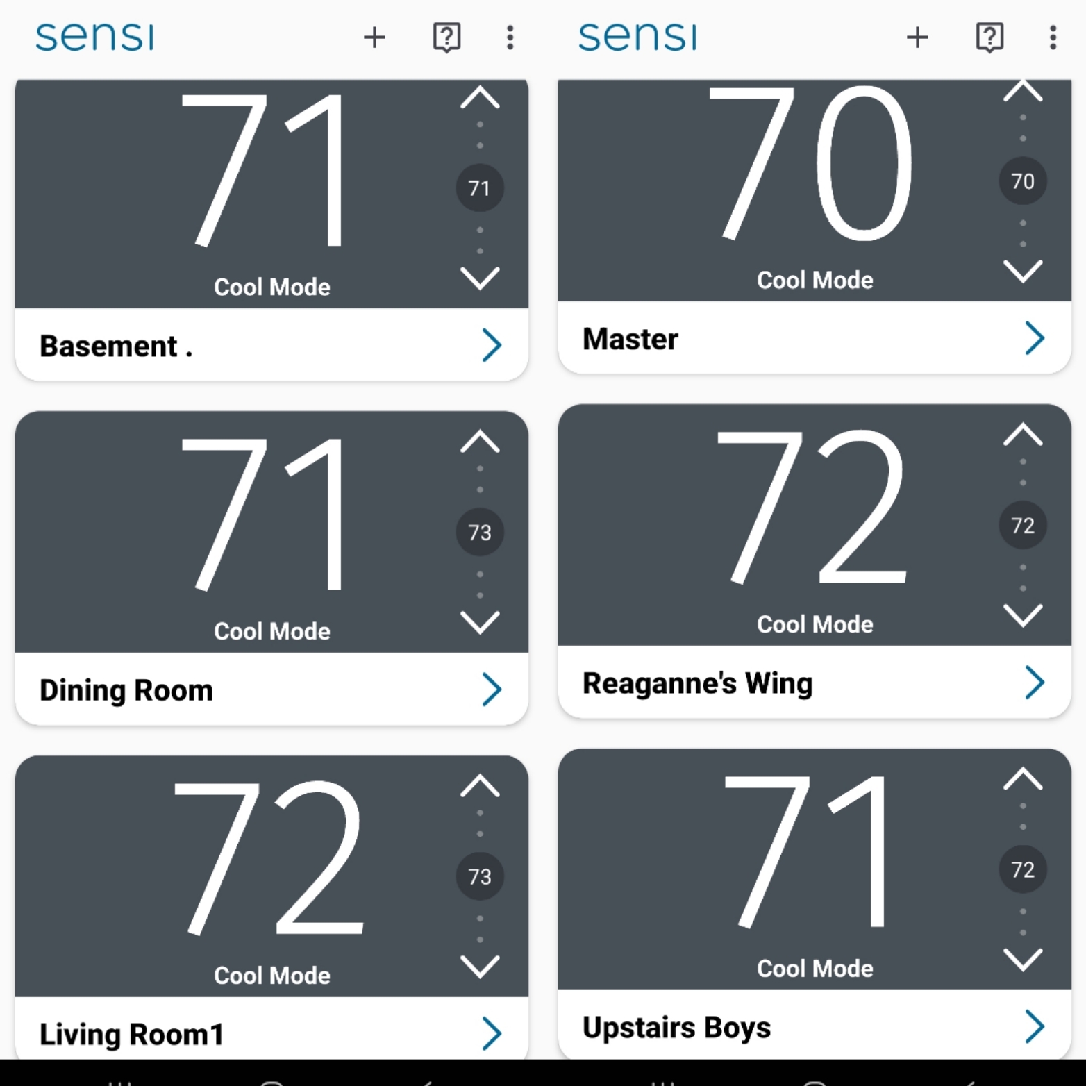

Sensi themostats have worked freat for us for almost 10 years now. Multiple zones house and business with schedule options. I'm using the basic models but they have others available.
link Sensi t stat
