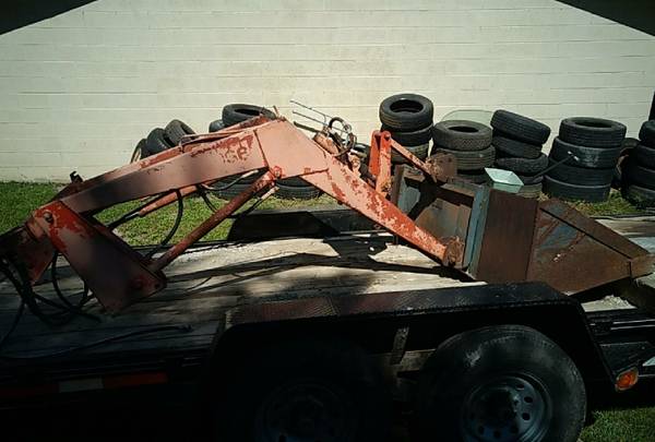

Too Many
I have a picture of this Case loader. A tag was riveted to it, but removed, every label is faded off. Nothing comes with it except the loader and bucket. No valve/joystick. No mounting brackets
Any idea what model FEL it is ? 36L ?
Was this a quick disconnect loader ? Is the attachment to the tractor missing ?
I've got a I2400D International with an auxiliary hydraulic pump driving a fairly large Ditchwitch backhoe.
I need an FEL.
This was something the guy has been given in a cleanup job of a property and knows ZERO-ZILTCH-NADA about it or tractors.
I'm wondering with that single hydraulic cylinder on the bucket, if this isn't an old "drop bucket"- cable, hinge, spring loader someone has tried to semi update.
Based on it being on a 16" or 18" foot trailer what size tractor do you reckon it is meant for ?$435 shipped to your FFL

Its made for 40 50 Hp tractors. something with side rails on the engine. The front tube will set on a rack at the front of the tractor and the rear needs to set on a plate about the bell housing. So you need to measure to determine if the dimensions will match your tractor. The single tilt cylinder is just for smaller tractors with lighter loads. something like a 5 by 4 roll of hay. nothing is quick all is pin on or bolt on to tractor subframe and the bucket.
this can be a useable loader if you can cobble and have the time. Bye it very cheep
