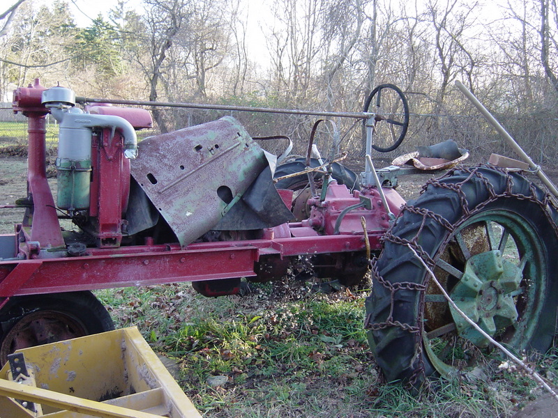

Can anyone ID this tractor?
   / Can anyone ID this tractor? #1
goneandbrokeit
Jan 26, 2006
198
Chain drive / crank start. IH?
   / Can anyone ID this tractor? #2

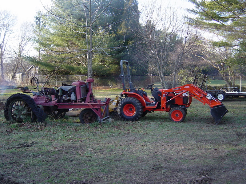

No expert on antique tractors, but, that looks like someone has done some "after market modifications". The channel on the frame looks pretty new while the rest of it looks pretty weathered. The look of the aged wheels just do not seem to match in the second picture. Did think the level steering shaft was pretty common on the old Farm Alls??. Will defer to someone who really knows this and provides comments.
Eddie
   / Can anyone ID this tractor? #3
Looks like a Kubota
   / Can anyone ID this tractor? #4
It looks like a 1930's Farmall F20 or F30 to me. The front end and the steering give it away. I'm no Farmall expert but I have seen those wheels on alot of the old 30's vintage Farmall's so they are probably correct.
Looks like it needs some sheet metal work, a tank, remove the contraption off the front end, a little TLC and you will be in business. :)
Here's a picture of a 1937 Farmall F20
1938 Farmall F20
1937 Farmall F30
   / Can anyone ID this tractor? #5
This may sound crazy, but I think someone tried to put a snow plow on that old tractor. The front of that added frame looks like it would hold a snow plow for a pickup truck.
   / Can anyone ID this tractor? #6
I think it is an F12, the extra frame on the front looks to have been added for maybe blade or possibly a corn picker?? farmers used to add what they needed to do a job.
   / Can anyone ID this tractor? #7
You may be correct. It does look more like a F12. I found this picture of one and the engine seems to be closer in size to the one you have. Like I said, I'm not a Farmall expert. I just know what they look like, not all the specefic's about models. :)
1935 Farmall F12
   / Can anyone ID this tractor? #8
I am also gonner say Farmall F12.
Looks like someone attach home made plow frame.
   / Can anyone ID this tractor? #9
One of the pics of it shows a tire chain on the left tire.
   / Can anyone ID this tractor? #10

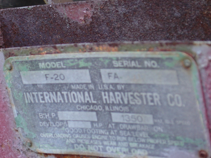

Years ago farmers rigged up a semi-retired F-20 with a saw up front for cutting firewood - belt powered off the tractor's pulley. Maybe that odd front framing is the remains of such an enterprise.
It is an F-20 or F-30. Engine, tranny, rear drive are wrong for the F-12/F-14. F-12/14 had straight axles with inside bull gears like C, H, & M. The pics show drop axles & outside bull gears.
