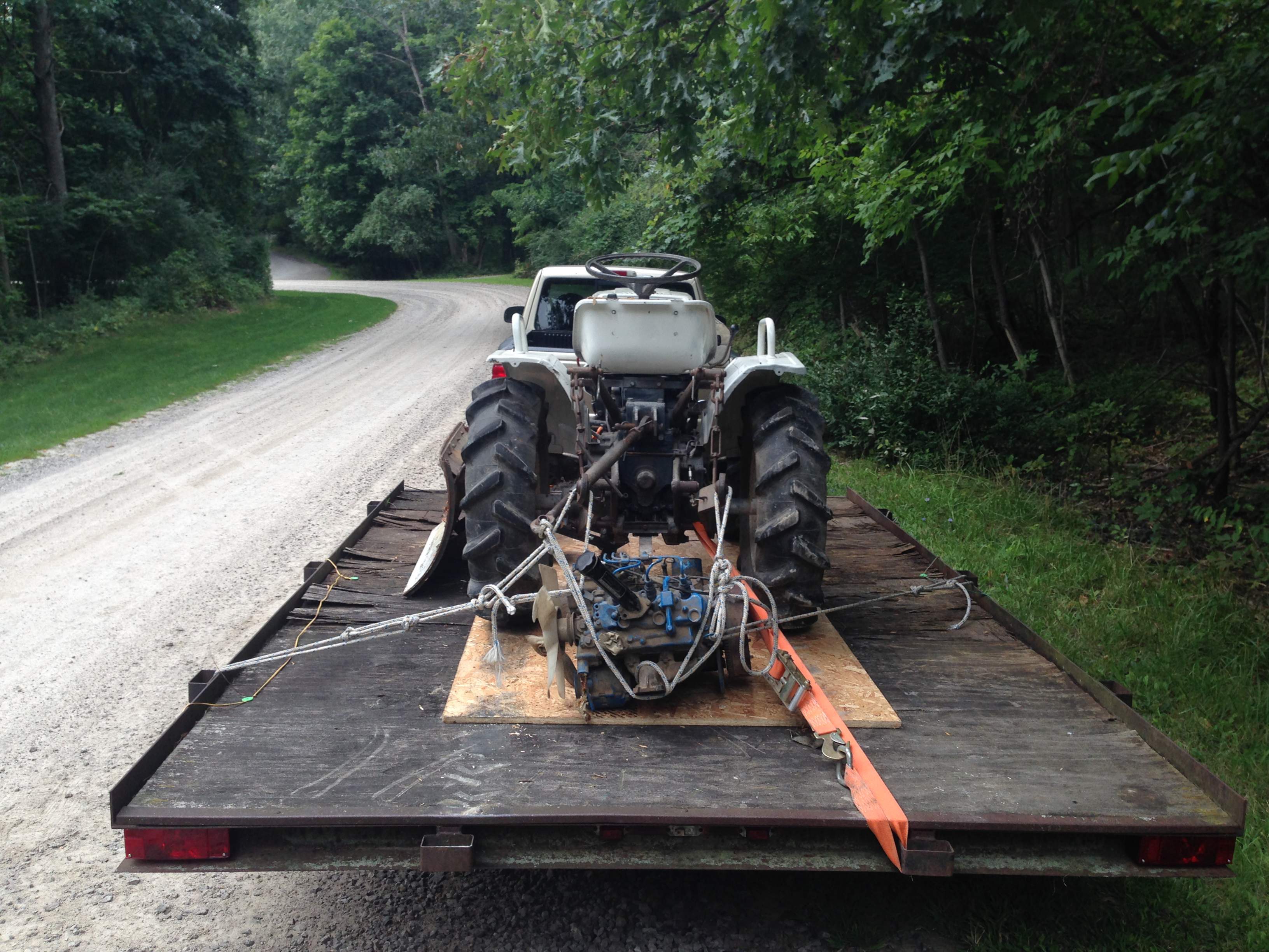

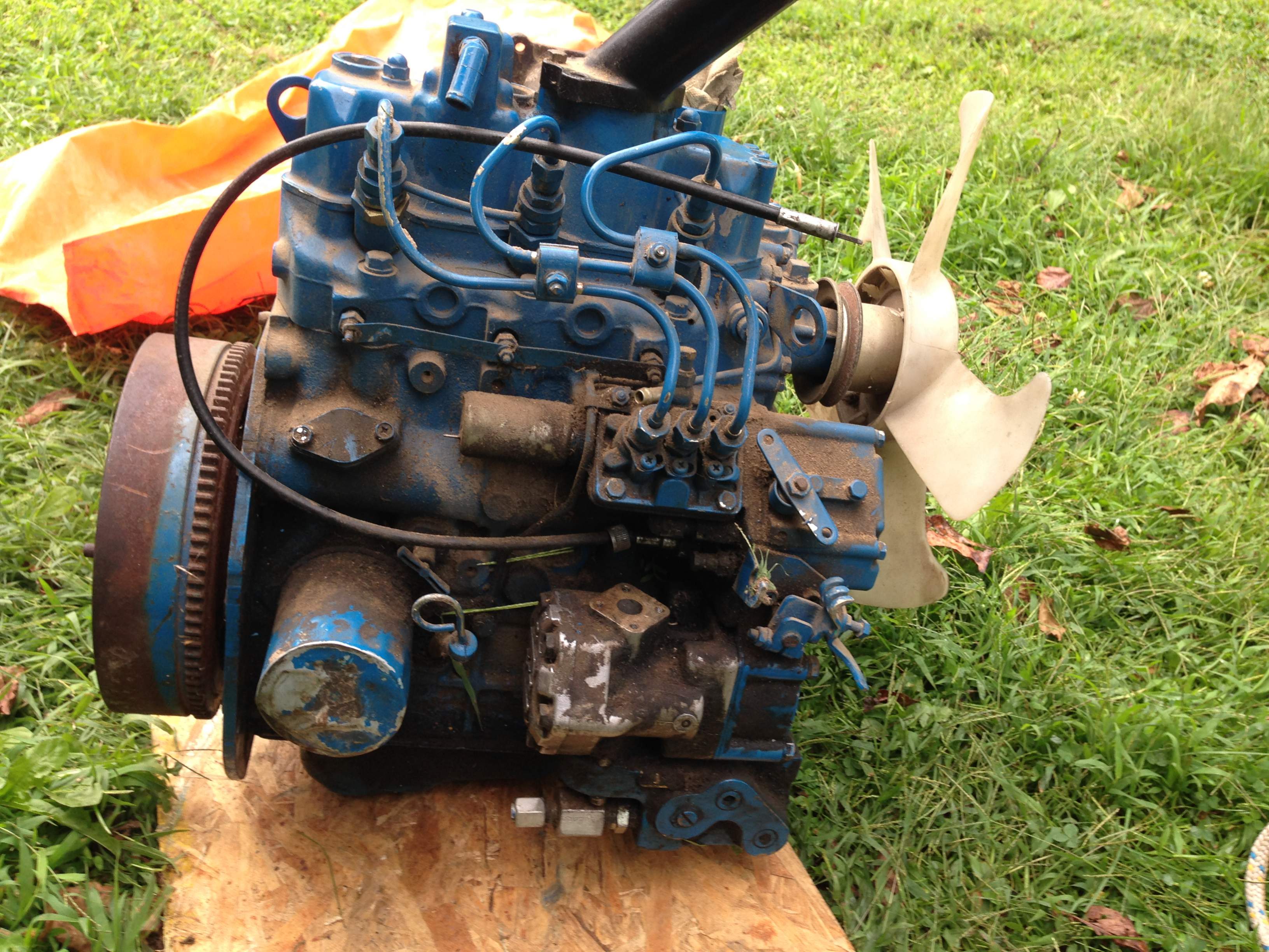

Hello All,
New member here and looking for some help in identifying an engine.

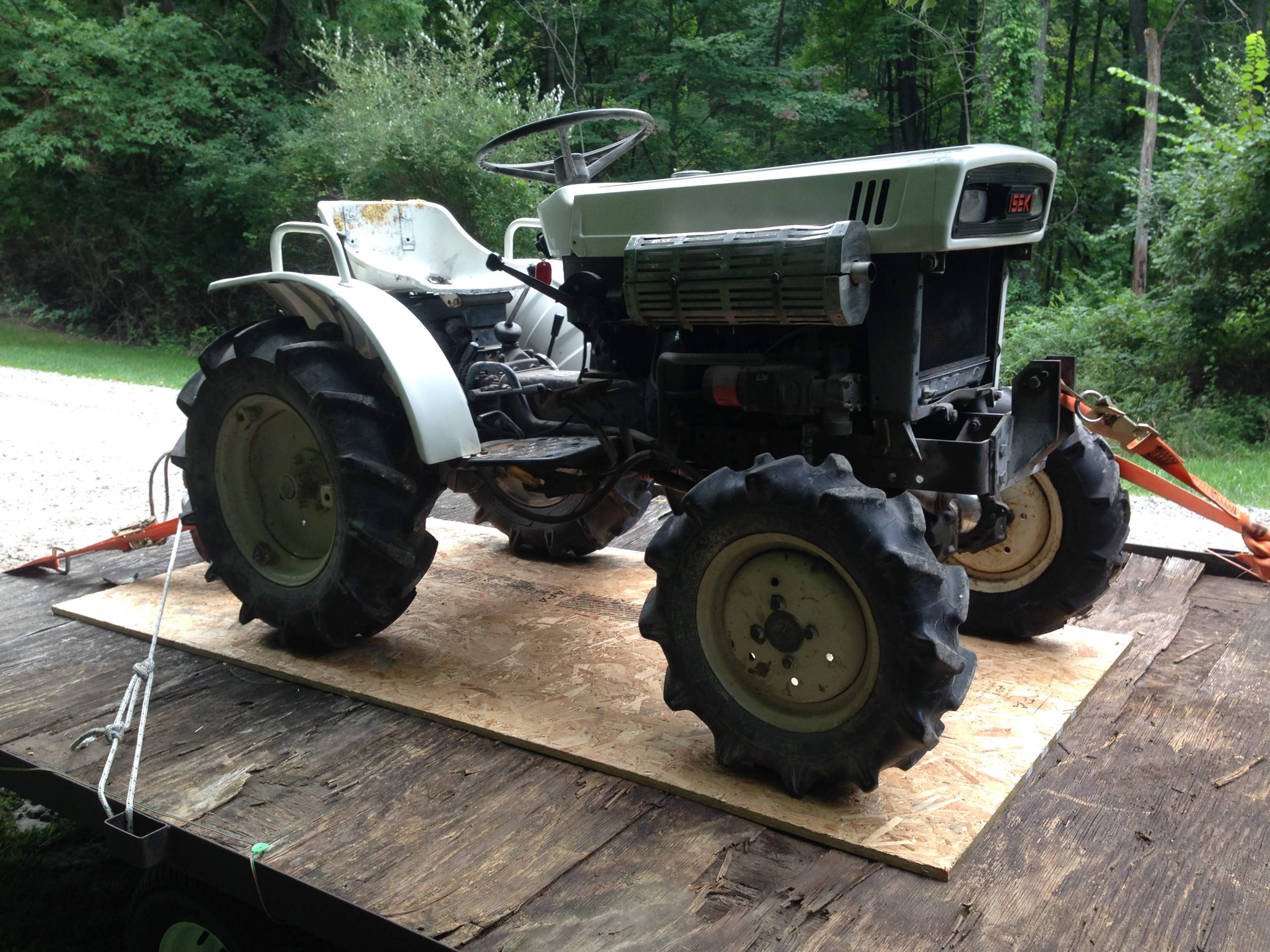

As part of a deal on an Iseki tractor it came with this engine and radiator. There are very few numbers on the engine but are as follows:
X139 SU04 - but that is all I could find..
Any help with the model / make would be appreciated. I was pressed for time yesterday and unable to do an intensive exam. The tractor and spares are about an hour from me and won't be able to examine closer until next week.
Thank you in advance!

Looks like you have a TX model Iseki ( TX1300 or TX1500?). Depending on model or year it should have a Mitsubishi KE70 or KE75 2 cylinder or a K3A or K3B 3 cylinder. I do believe the "spare" engine shown is a Shibaura. I realize you didn't directly say the engine was a spare FOR the Iseki,,,,just wanted to point out, I don't think it is a true "spare" to that tractor if that is how it was represented to you by the seller.

Does anyone know if the Shibaura S723 from a NH 1210 will basically bolt into a New Holland 1310? A friend of a friend has a 1310 with a bad powerplant. From my limited research it seems that there are a lot of cross utiliaizaion of parts between the two models. The 1310 end result may be somewhat underpowered but the final product my be an acceptable alternative.
Just thinking....
/ Can Anyone ID This Engine? #7
Pretty sure it will fit the 1310. Parts search show the 1210 and 1310 use the same crank. Probably means same block with different bore.
