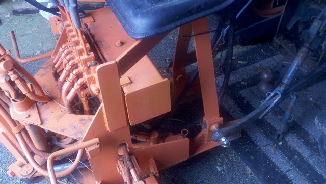

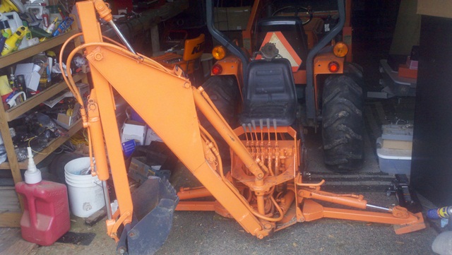

I'm having a heck of a time trying to identify my recent craigslist purchase. It's been spraypainted Kubota orange and there is a faint kubota sticker on the arm with a jack-o-lantern, but I'm pretty sure its not Kubota. Does anyone recognize this backhoe attachment?

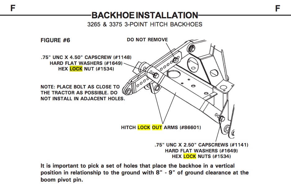

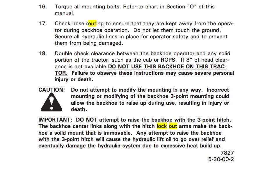

Here is a snapshot from a page of a Bradco Back hoe manual. They refer to them as lock out arms. They form a triangle with the heavy duty top link that locks the 3 point arms rigid.

I think this may be a Kubota B629... anyone else have one with the six levers?

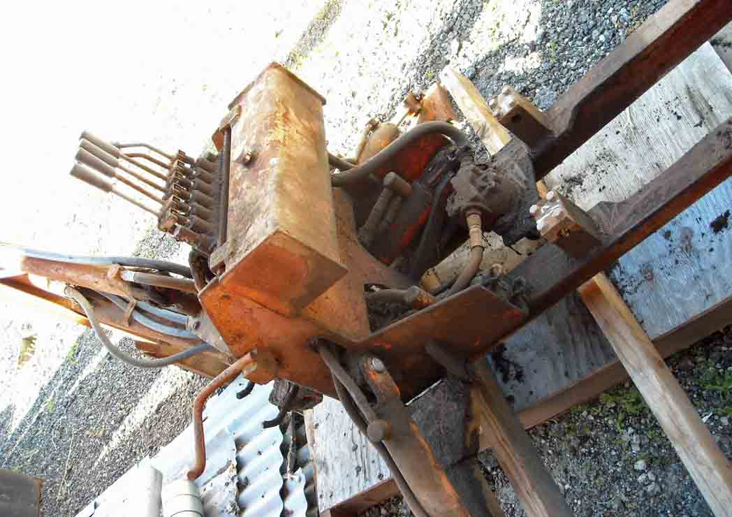

It's a K629 from the late 70s/early 80s. Here is a photo of one
with a subframe for a Kubota B8200. A friend of mine picked it up
for about $500. The subframe does not look factory-made, but
the owner who sold it had it mounted to a B8200 that he sold
separately.
I do not know who manufactured these for Kubota, but it does
seem to pre-date the Woods OEM era.

The 619 and 629 backhoes were made by Brantly, as best I can tell. I just picked up a Brantly version, and the manuals I find for those Kubota units are identical to the information I find for the Brantly. Mine looks just like yours, with minor differences in the subframe, and color, of course.
