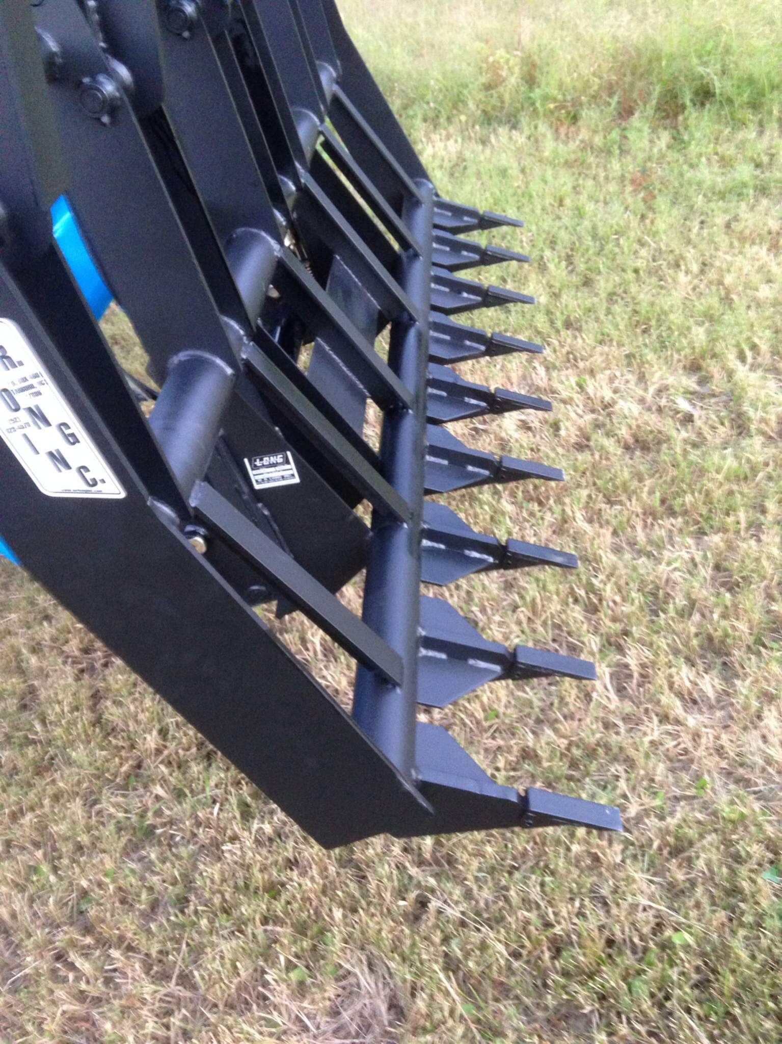

I am looking at a 84" Root Rake that is Installed instead of my Bucket for my Tractor for Clearing 3"-4" Pine Trees. This Item is Listed for about $1,800. I Know it will be Less Effective than a Bull Dozer with a Root Rake, But I can take it Slow and I enjoy spending my Time on my Property. It is listed at the Rakeshop.com I have a 72hp Kubota 4x4 with Weights on my Wells. Does anyone have any info on how Stout this Item is? I have about 30 Acres to finish Clearing. I have Cows and Goats on the on this Property trying to thin it out for me. I have Killed 1 Bush hog trying to Clear this land. I have Hired some Work out and it has Averaged, $1,250 a acre for Track hoe and Dozer pushing everything in a pile for 15 Acres. I have Also Tried the Grinder and Skid Steer that I知 Highly Displeased with being that they averaged $2,800 per Acre for 3 Acres and it has Left me with a Mess to push up and Nothing will grow until the Chips are Moved. I have Also bought a 75 model Ford 4000 Backhoe, (It works Great for Removing Old Stumps) But it is Very Time Consuming, I average about 1/3 Acre for 8-9 hours running time. I know the Rake will pay itself off just in the Burn Piles that I have Burning. I'm looking about clearing 1 Acre a Day if it Possible. I have No Rocks in my Area where I live in North Louisiana, just Red Dirt. Any Info on this will be appreciated. I have attached a Photo of the Root Rake. Thanks. rake.png:confused3:

I agree with Rocky that having a grapple would make things much easier to transport brush/trees to your piles. I find the tines on the rake you posted interesting in that maybe the curve helps with trying to pop things out of the ground?
I have the W.R. Long root grapple that has worked great for me, but have not fed it a steady diet of 3-4" pines. The lower tines are shorter and have spade points with replaceable teeth. It has a cross bar that limits its digging depth to 12-14 inches.
I also have a stump bucket from Titan that works real well popping on those smaller pines. The size you describe are a one shot deal. I posted a video on TBN digging out a 12" pine stump a little while ago, a search for Titan stump bucket should turn it up if you are interested.
When clearing up an area I use the stump bucket first on the bigger trees and clean up with the root rake, it's been a great combination. The stump bucket will also easily carry whatever tree/stump you dig up, but it also carries a lot of dirt. I usually drop it where I dig it up and roll it around with the grapple to knock off most of the soil.
