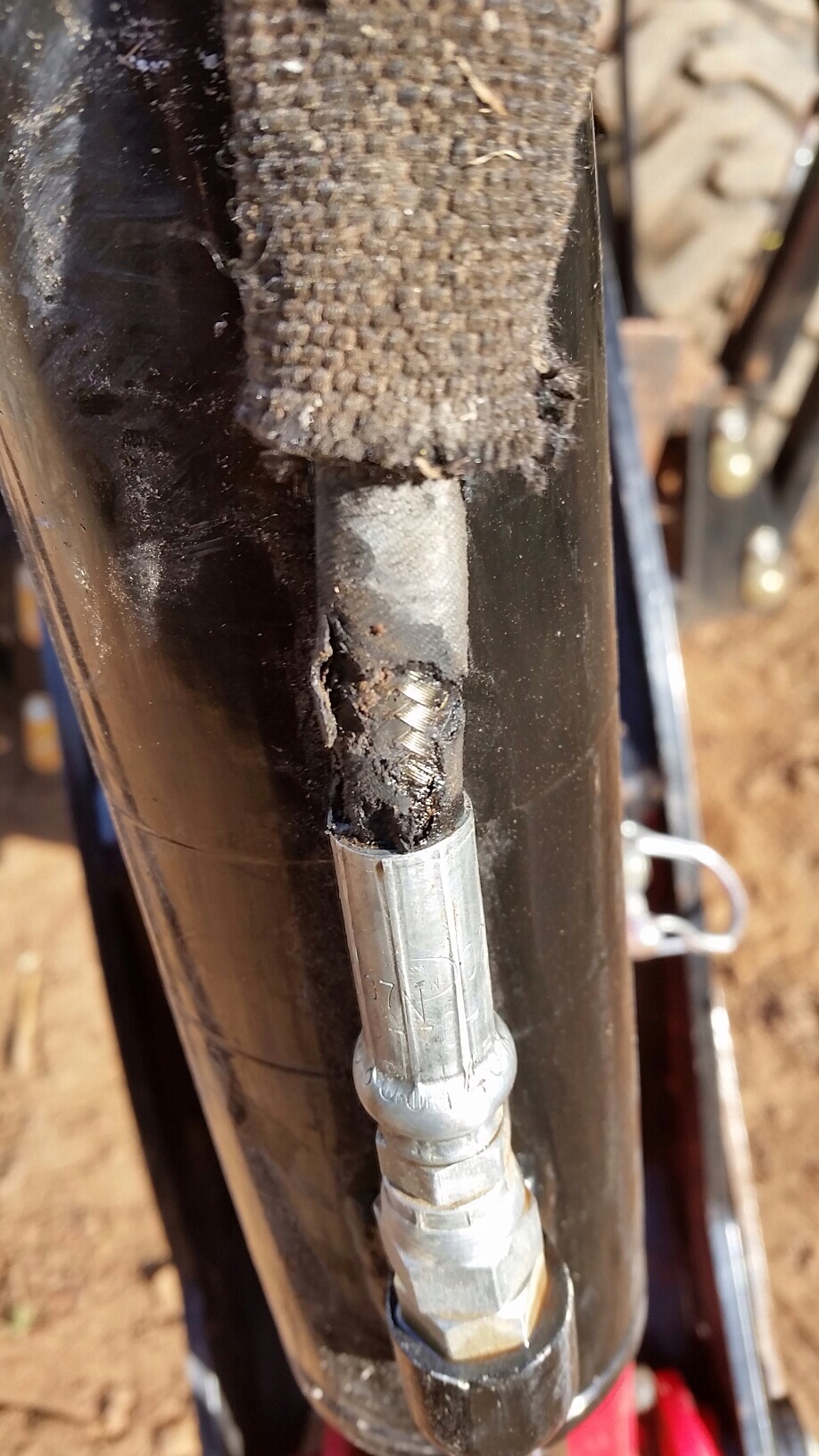

Hello,
I got a little to close to some tree branches and now I have a leak in one of my hydraulic hoses on my back hoe. It seems more like a tiny hole as opposed to a big tear. When I move the actual bucket is sprays out not shoots/squirts out. Can it be patched or do I need a whole new hose? It is close to the fitting.
Thanks
Jim

If the rest of the hose is in good shape and you have plenty of extra length, the old end cut be cut off and a new one installed.
/ Can a hose be patched? #3
You might be able to cut the hose after the hole and crimp a new end on, but it can't be patched.

Don't get hit with that stream of oil. It can bust thru your skin and give you more health issues than you want to know about.

I say no- get a new one they're cheap. Surplus center. That hose looks old to me anyway.

Do not mess around with high pressure hydraulic hoses. Get a replacement hose. If you do not want to mess around with adapting a 3/8" NPT hose to what looks like JIC ends, bring your old hose to a hydraulics jobber. Expect to pay $40-55.00 for a new hose from the jobber.

Better off to replace than cause bigger problem.

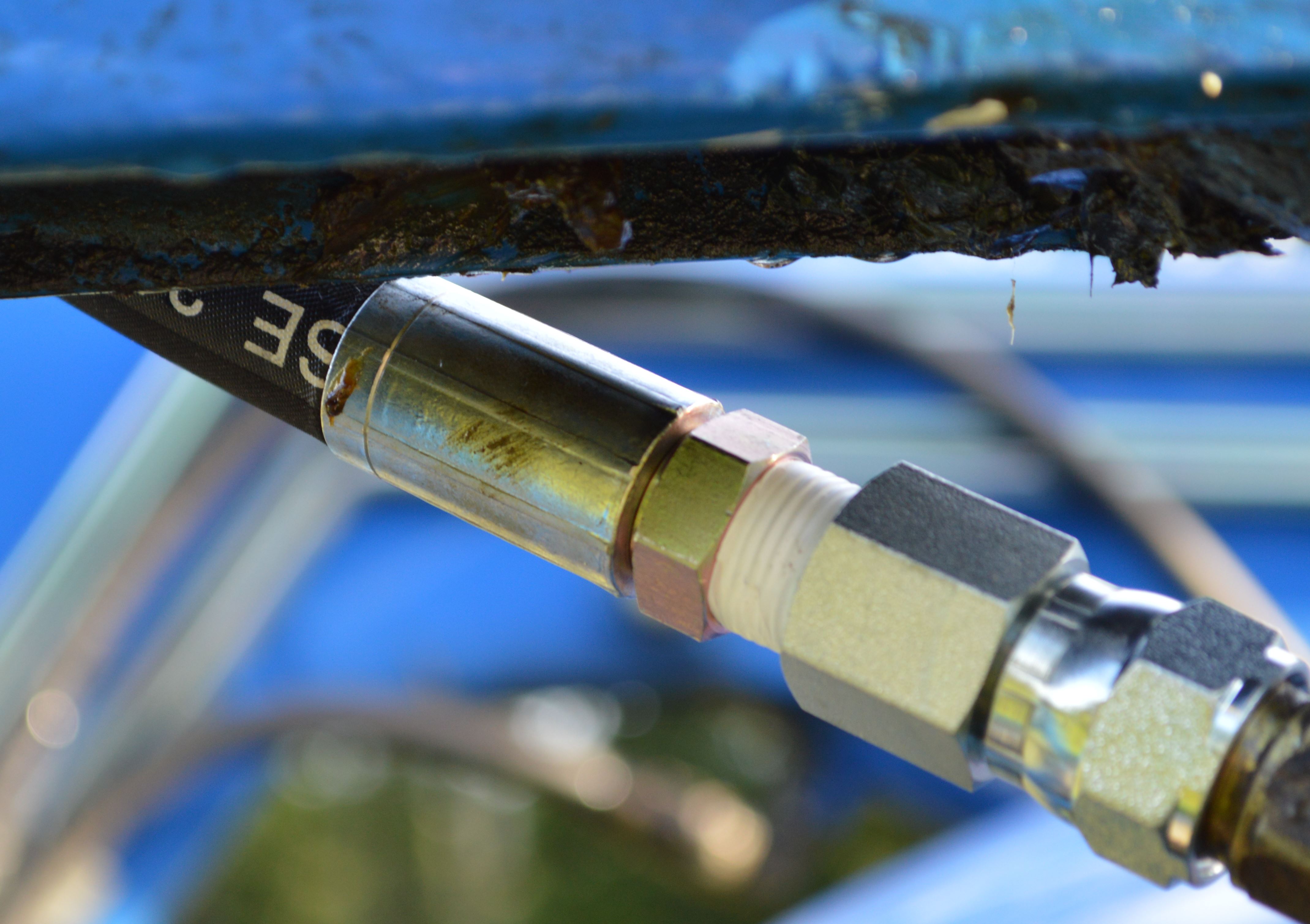

Go to someone who can do the complete hose for you- easier. (Parker in Bangor - in my area) I bought one at tractor supply and spent the next week tracking down fittings to make the connections. I used teflon tape for reassembly, no leaks. Before that I had tried some paste out of a tube, leaked like crazy. Good luck.
Really not supposed to use Teflon tape on these fittings. I know- I know, a lot of guys do it, but it can cause some grief if it gets into the system. Also, TSC is as worthless as Walmart when it comes to identifying and adapting hp hyd fittings. Try Surplus Center (web site) next time.
: Surplus Center
Hose I have found cheaper at the previously mentioned Hydraulichoses.com, but the tech page at Surplus Center will save a lot of frustration and needless adapter buying.
