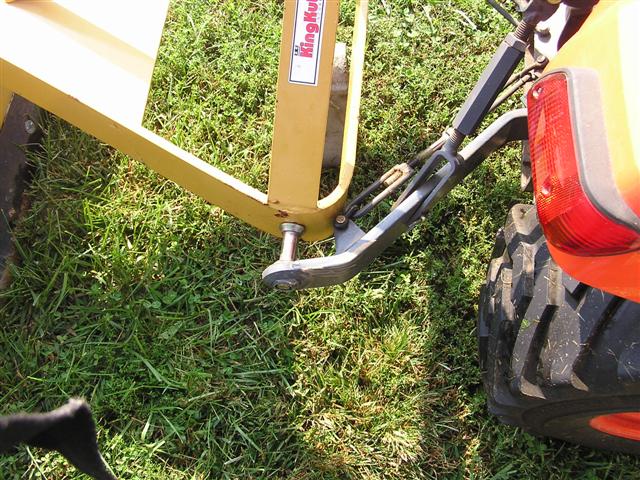

The RB-60 King Kutter rear blade (or any of the clones) that use a band of steel bent in a triangular shape for the bottom 3pt mounts will hit the attachment points for the turnbuckles on the lower arms of a BX2350 preventing you from hooking the blade up. I used an angle grinder with a cutoff blade to cut the band an inch or so in front of each pin, turned it over and welded it back on. Looks kind of strange, but it worked. This was the only type of blade I could find in my area, so I didn't have a choice but make it work. I can take pictures if anyone wants. As an alternative, the 3 pt quick connects may extend the arms far enough that this won't happen, maybe someone can chime in if they have used them on this type of blade.

Would it be possible to post photos of your ingenius modifications please?
Have you informed the dealer or manufacturer about this problem?

Sorry it took so long, couldn't find pictures of modification, had go to the barn and with the aid of a flashlight take new ones. Here's the before and the after.
