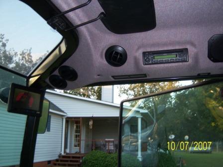

I'll start off saying I got this idea from WoodDawg.
I purchased this 7" screen and camera from Ebay for $110.00.

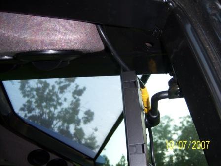

I installed the camera under the rear overhang of my 45da. After removing the top panel and looking for clearance, I found a good place to mount it. I ran the wire overtop the rear window and into the overhead panel inside the cab.
From there I removed the radio/cd player and pulled the wire out. I used the existing wires there to power everything. I wanted to be sure that this package could not be turned on without the ignition in the on position. So I found the right wires and made my connections.
I ran the wire to the monitor on down to the front right side of the overhead panel and came down to the rearview mirror mount. Since I have two outside mirror's, I decided to take the interior mirror off and use that mount for the monitor.
All said and done. I have only about 6 inches of total wire showing. The wiring got a little tricky. Trying to get them through the overhead panel. Even after loosening the top, It still didn't want to give much.
Just thought I'd share this incase anyone would like to do the same. And I want to thank WoodDawg for the idea! haha

That is way Cool! I want one now. I sure bet it saves on the neck not having to turn around to see how things are going in the rear. Great job!
   / Camera System #3
Great job, looks factory :D :D :D
It will be great for keeping an eye on things without having to turn around. Just don't forget to look where you're going!

Thanks guys! It does save the ole neck. And as for the tv tuner......shouldn't be a problem hooking that up! hahaha Does get boring mowing all that wide open grass.
   / Camera System
I got everything off of Ebay. I typed in "rear view camera monitor" and a whole bunch popped up. There are several different styles to choose from. I just went with the cheapest 7" monitor that I liked. haha You can also try searching for "back up camera monitor".
Funny though, There isn't a brand name anywhere. It's just a 7" TFT LCD Monitor and the camera came with it.
It works great when im not kicking up alot of dust. I was moving some dirt last weekend and couldnt see alot going on. But things were very dry.
