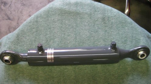

I'm looking to confirm some specs on your top-n-tilt kits.
Are you using a 2.5" cylinder with 10 inch stroke on the top link?
What's the stroke and bore size on the tilt cylinder?
Thanks in advance!

I just did. He recommends 12 inch stroke on the top link. $1100 for the complete kit and 20 week lead time.
   / Callout to M59 owners with Top-n-Tilt Kit #4
Yep, that sounds like a huge price difference until you break it down into one simple cylinder vs a complete set of fitted cylinders & hoses from Fit Rite.
For the top link cylinder alone the Princess Auto is $200 and AgriSupply.com has it for $150. Fit Rite has what looks to be the same cylinder for $300 - although he recommends a bigger diameter cylinder shaft for Cat. II 3pt like the M59 has & he sells that one for $330.
Princess and AgriSupply rate theirs at 3000 psi.. That's OK for the typical tractor hydraulic system pressure, but the top link is one place I'd like a higher psi rating to handle the compressive forces you get on the 3pt top link when hitting a rock or stump. Maybe thats where the Fit Rite costs more...., but if so he doesn't say so.

My local hydraulic shop will build a cylinder to my specs for about $200.

And I bet that it looks just like the one I have pictured. :rolleyes: and has a lifetime warranty just like mine. :thumbsup:
Most hydraulic stuff is actually built to handle 3-4 times it's actual advertised rating just for those surge spikes.
That $1071 actual cost also includes the shipping costs from California to Canada. The complete T&T set is $970. It is built specifically to fit his M59. These are not generic cylinders one size fits all. In fact what the M59 takes is a cat 1-2 top link from an MX series and the side link for an L4701 or earlier equivalent.
Generic works for some, and I see it all the time where people are willing to compromise. ;)
