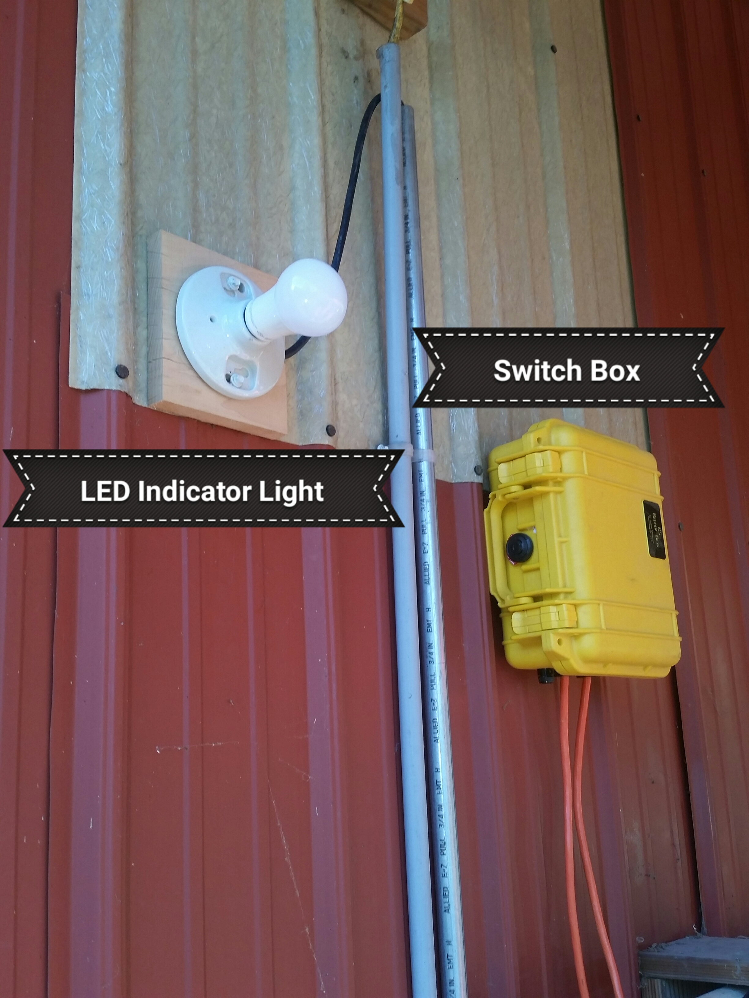

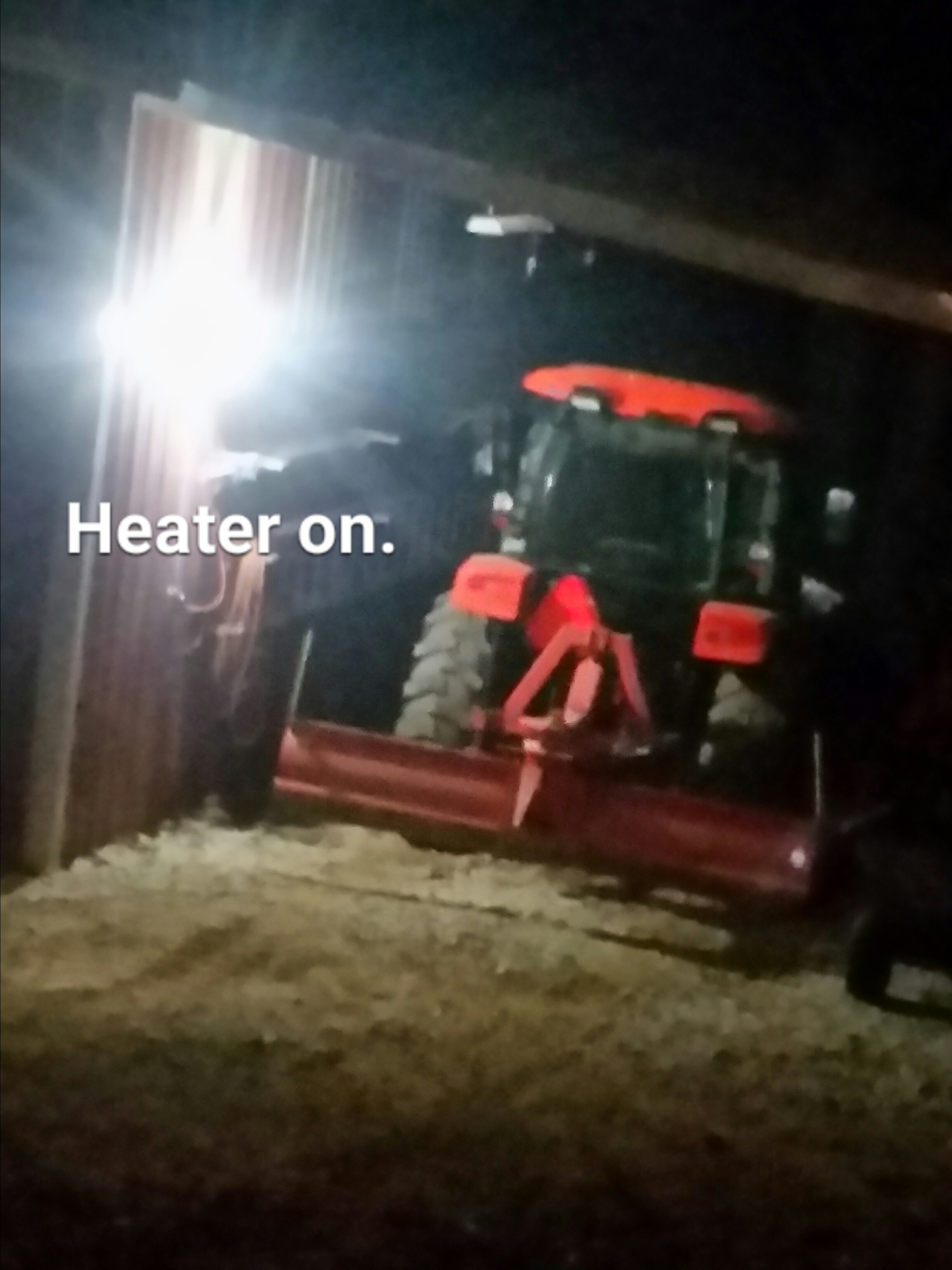

Anyway, I removed the electronics from the beeper box pelican case and put the wireless switch inside just to keep it out of the elements even though it was made for outside use. I mounted the box on the shop wall by the tractor so I just plug in the block heater and the shop mounted light. When I turn it on from the house I know it is on via the light. The remote works from quite a distance. I bought the switch on ebay for about $15. You probably don't need the pelican case, which costs more than the switch, but it's weatherproof and I already had it.
In the summer I can unplug the block heater and leave the light plugged in and then just have a remote light if needed. As you can see by the picture it lights up the area well. It's a 60W equivalent LED so pretty inexpensive to leave on..
