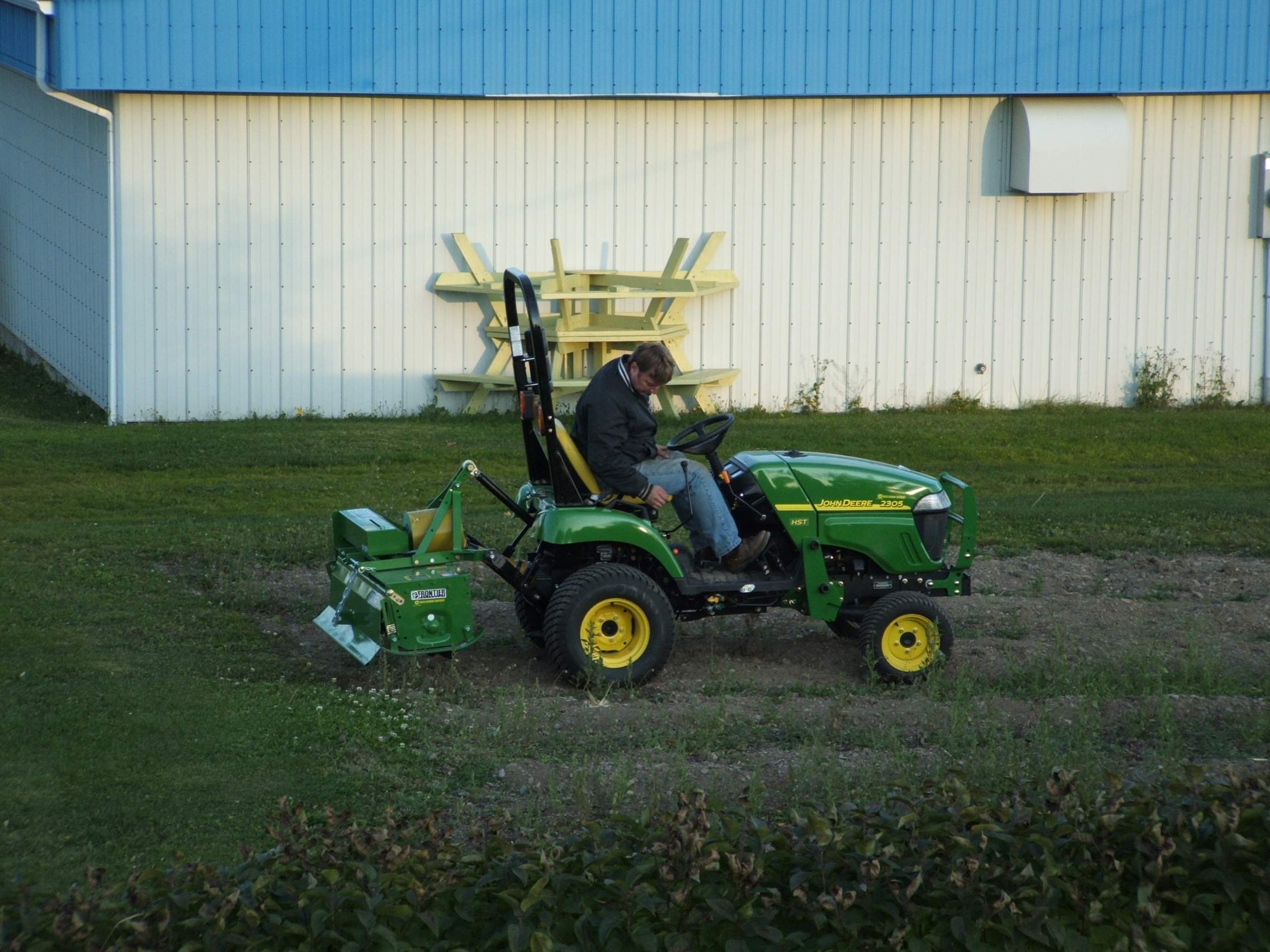

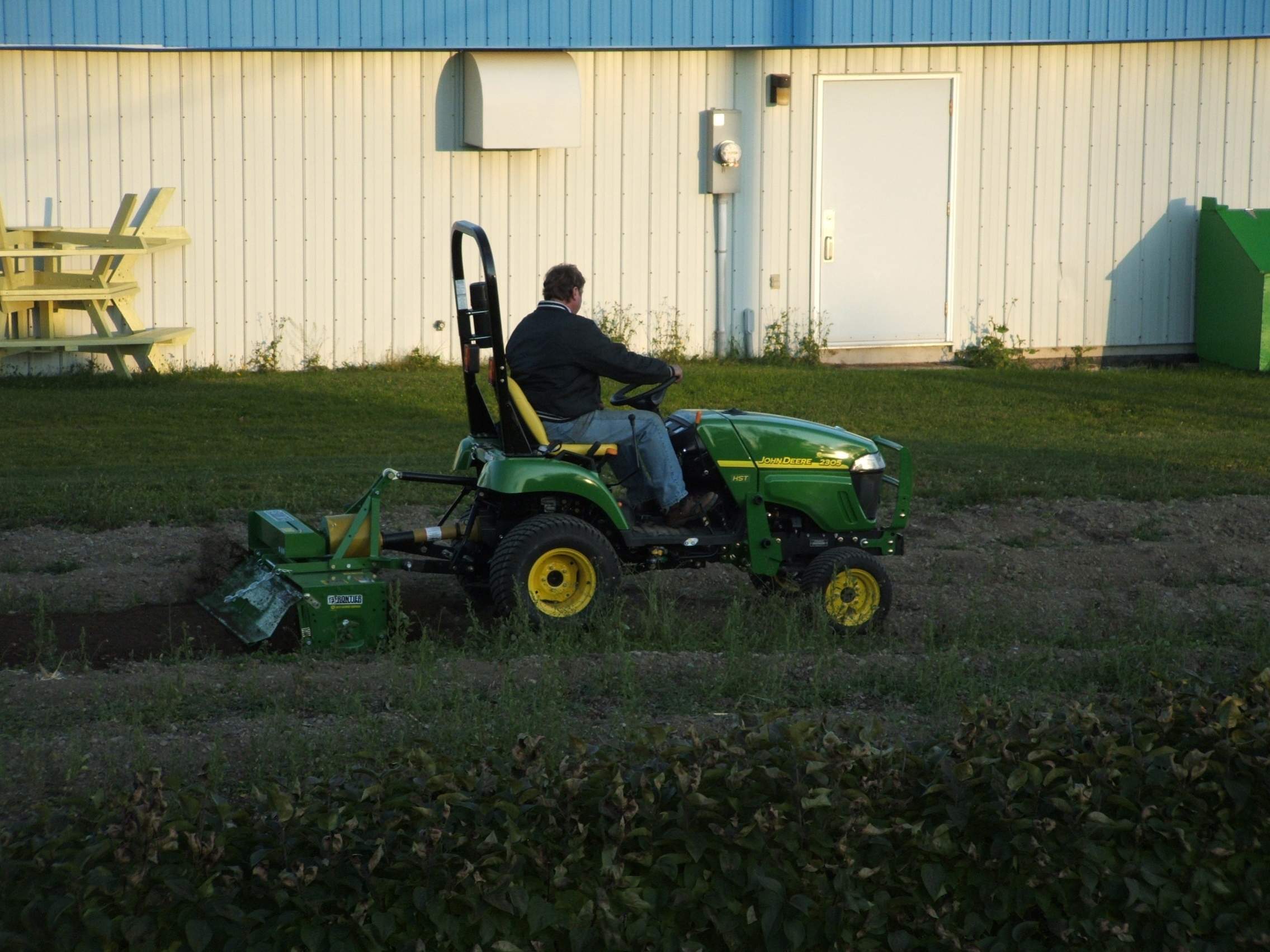

I use a tiller, a middle buster to make furrows, a single row cultivator to help remove weeds between rows. You may want to look at this site on youtube. He gives some good advise.
YouTube - EverythingAttachment's Channel
