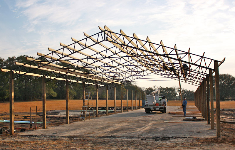

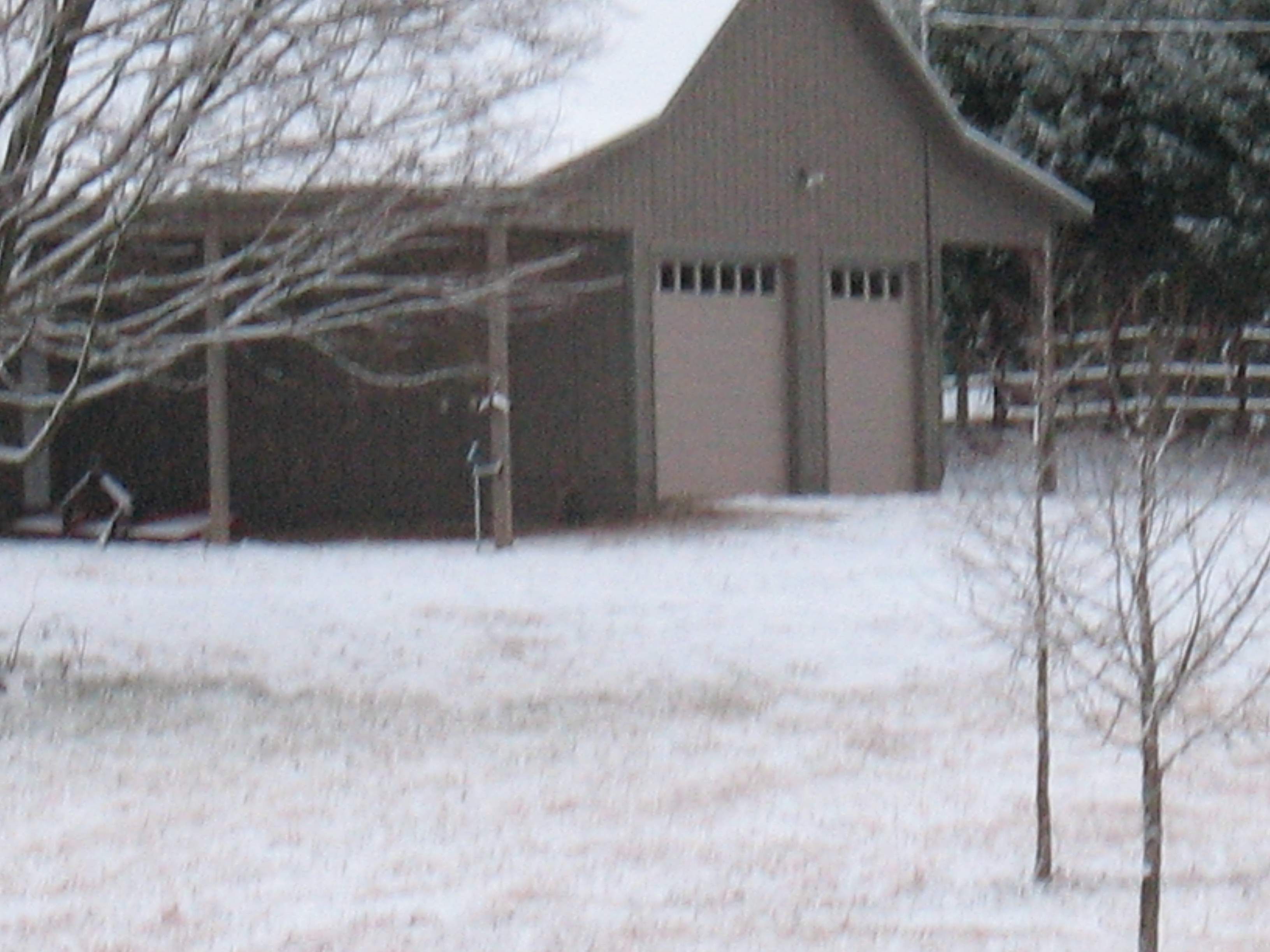

Well I have decided it is time for the pole barn/workshop. I called Morton last week to meet with their rep. As of today I have not received a call so I will give him a couple of more days before I call back.
Size will be 24x32, 28x36, or 30x40.
I would like to get it under roof with roof insulation. I am also considering the back and side walls out of metal and the front wall wood or brick. I have seen one close by like this and really like the way it looks. I will most likely hire the slab pour myself as I know a couple of good concrete guys. I don't plan on having water or sewer in the beginning but will plumb for it to be added at a later date.
Any one have a build like this? I attached a picture of one but the brick would be on the front.
Another reason is the security alarm I have in my house. The wireless alarms will not pick up through metal. So I would need wood or brick for the front. If this does not work out I guess I will buy a separate system.
I also have a local company that has built several pole barns, garages, and workshops that I plan to call this week. I want to go by and look at some of their builds and talk with the owners.
One thing they do is use the metal type truss system like the attached picture. I think the trusses are spaced every 8-10'.
Does anyone have a build using this type truss? if so, how do you like them?
Thanks
David

If you think wi-fi has a hard time going through metal, it's just as bad if not worse through brick (unless you have lots of windows).

Yep. Wifi and just cell signals in general have a hard time with a metal building.
Sounds like the brick/wood on the front is going to add a good bit to the cost.

That first picture you posted is what is called a Bailey barn among a few other names, they usually are a kit and the bays are spaced 12' apart and come in widths from 16' to 50' wide and with the 12' bay length you can build it as long as you want to, the 2x6 purlins are stood up edge ways in metal clips that are welded on the trusses, it's a good barn, I built a 32'x 60' with 20'x 36' lean to off of one side. You can google Bailey barns or a place called Panhandle Salvage, that is where I got my kit from, they build all the metal trusses out there in the Fl panhandle. Good luck they are popular down here. Charlie. Forgot to mention there are lots of pictures of all the different options on the Panhandle salvage website.
