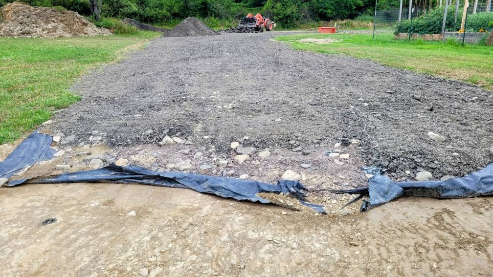

Part of my drive is reused road millings...works exceptionally well.
This is mid-build with the bio removed and drive dug down about 8 inches. Added geo-textile cloth base, larger rock / milling chunks for base layer and loose road millings spread on top layer.

We put asphalt millings 1.5 to 2” thick ( it was supposed to be more) over a good gravel base. So far, it has worked out quite well. The rain does not wash out like 3/4 crush with dust. I just used our plate tamper and water to compact it.
A year later, the tire path is like pavement and the edges are a little softer. The water seems to perk through the edges.
