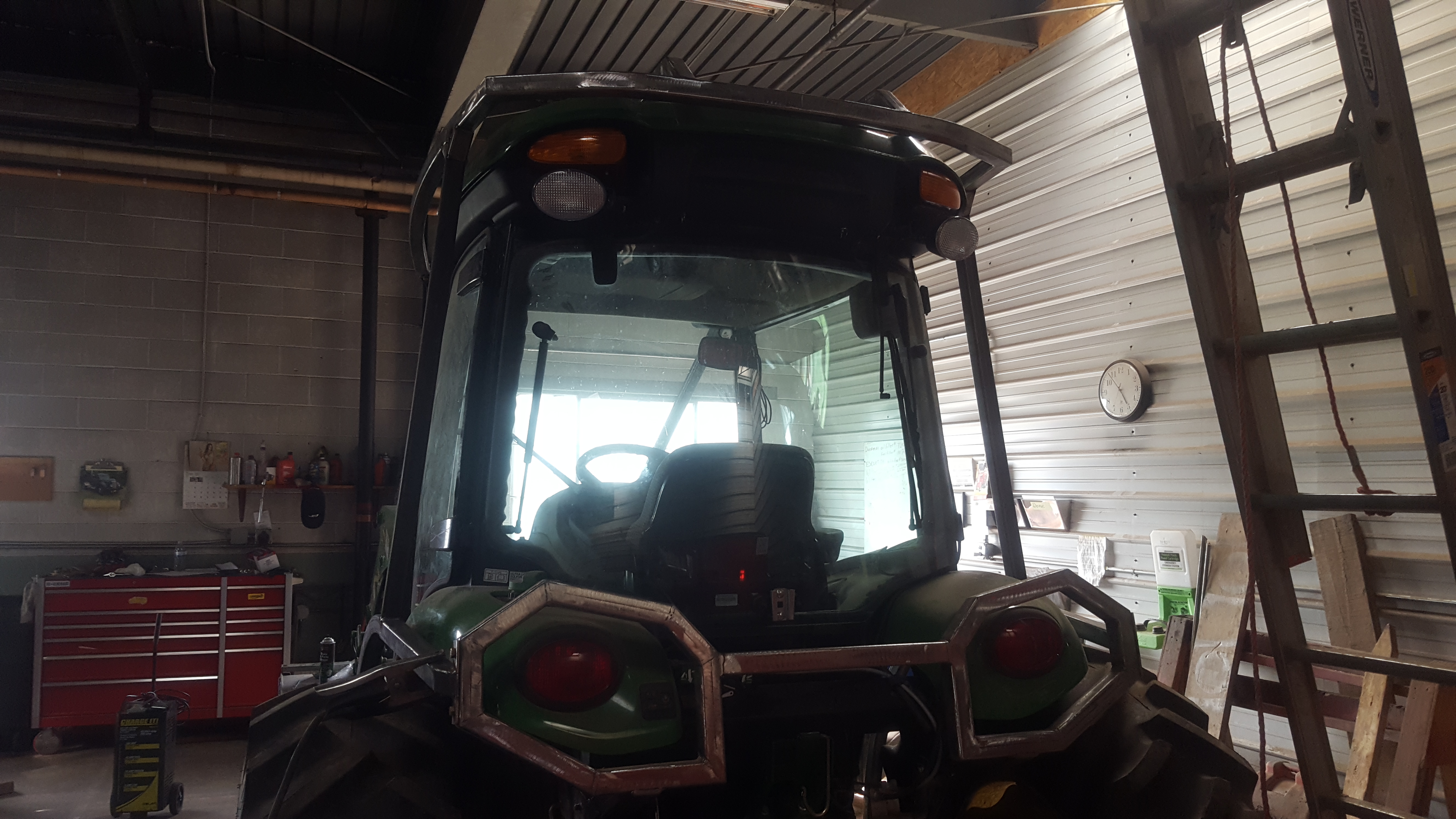

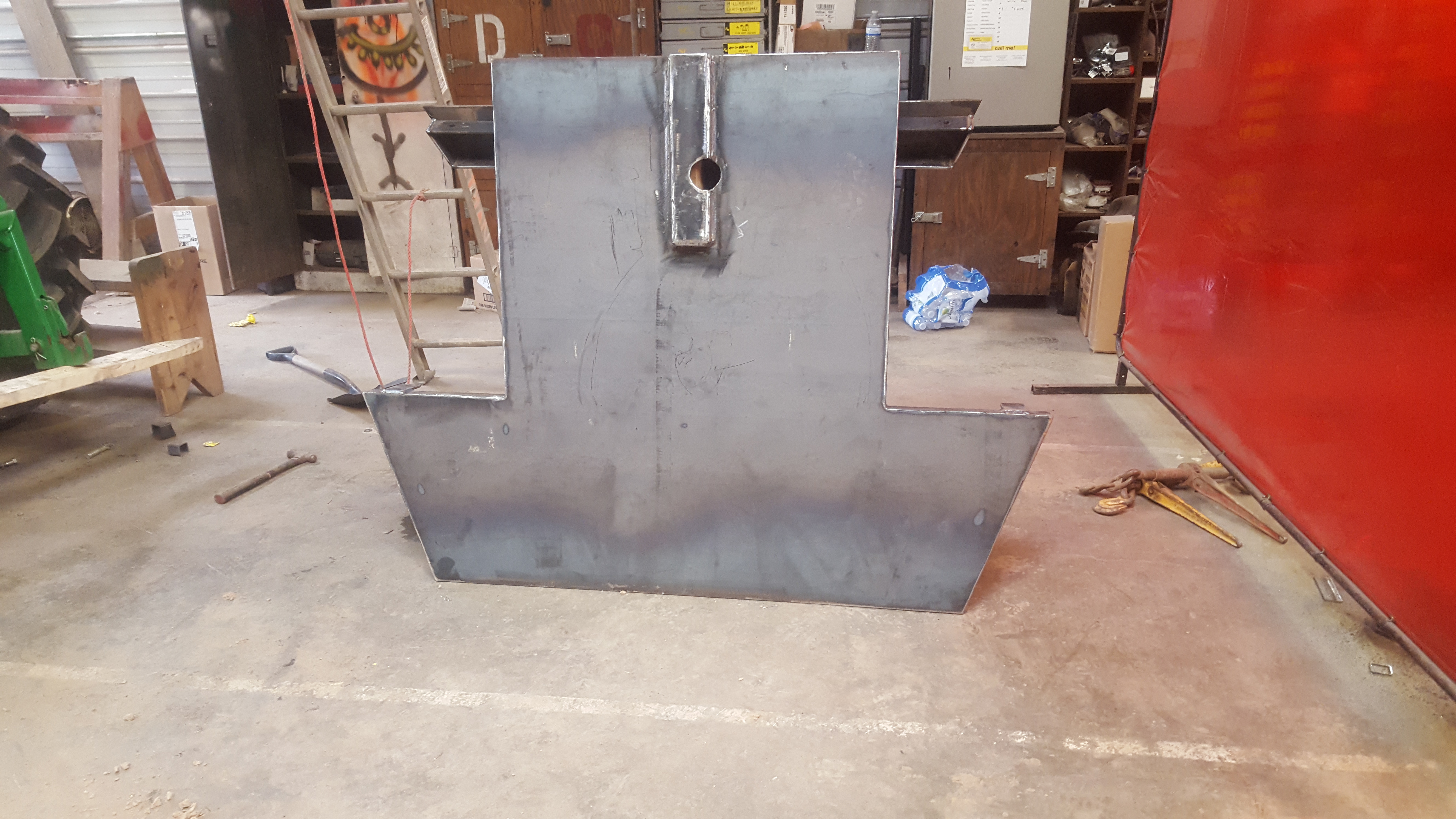

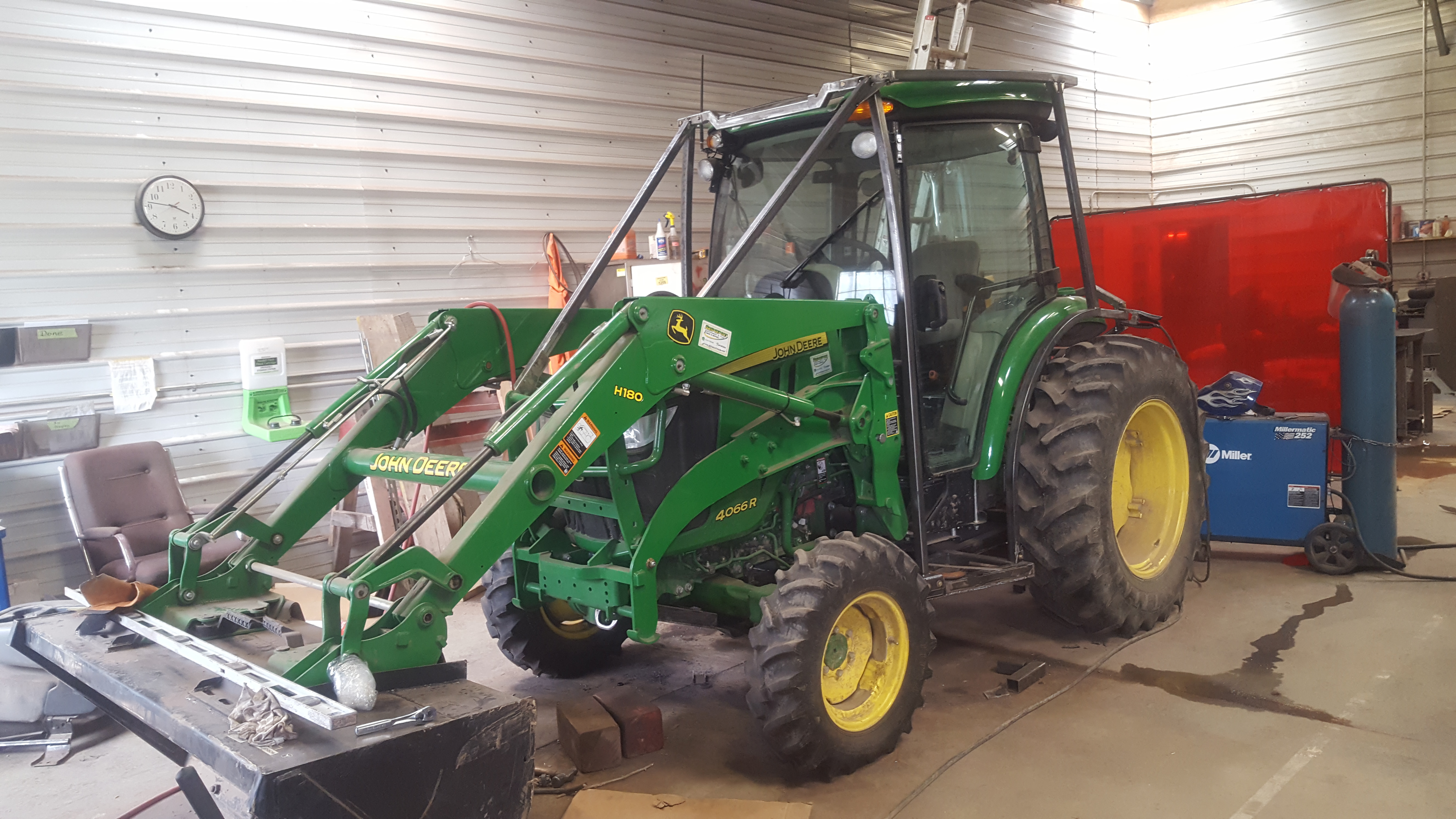

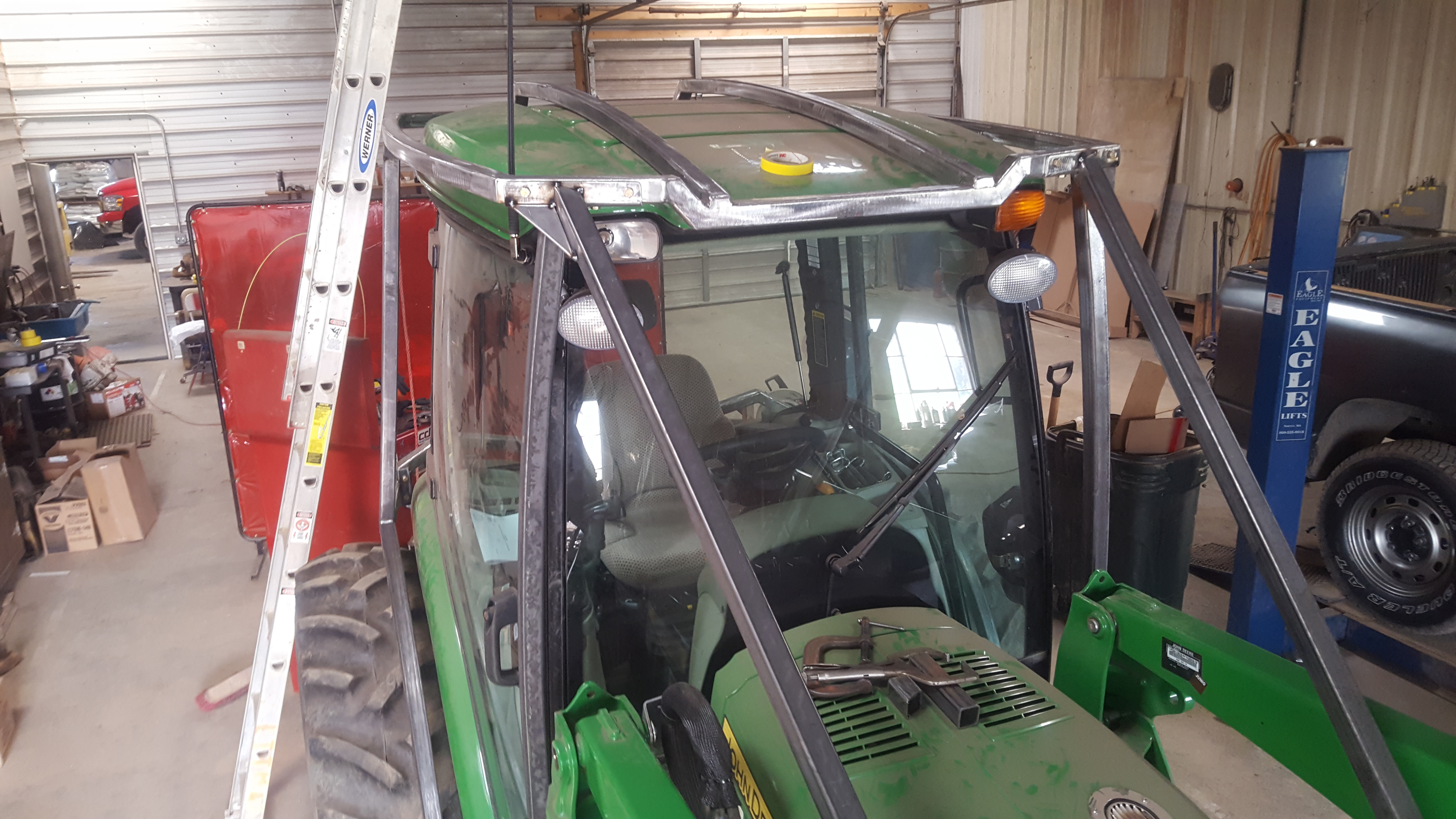

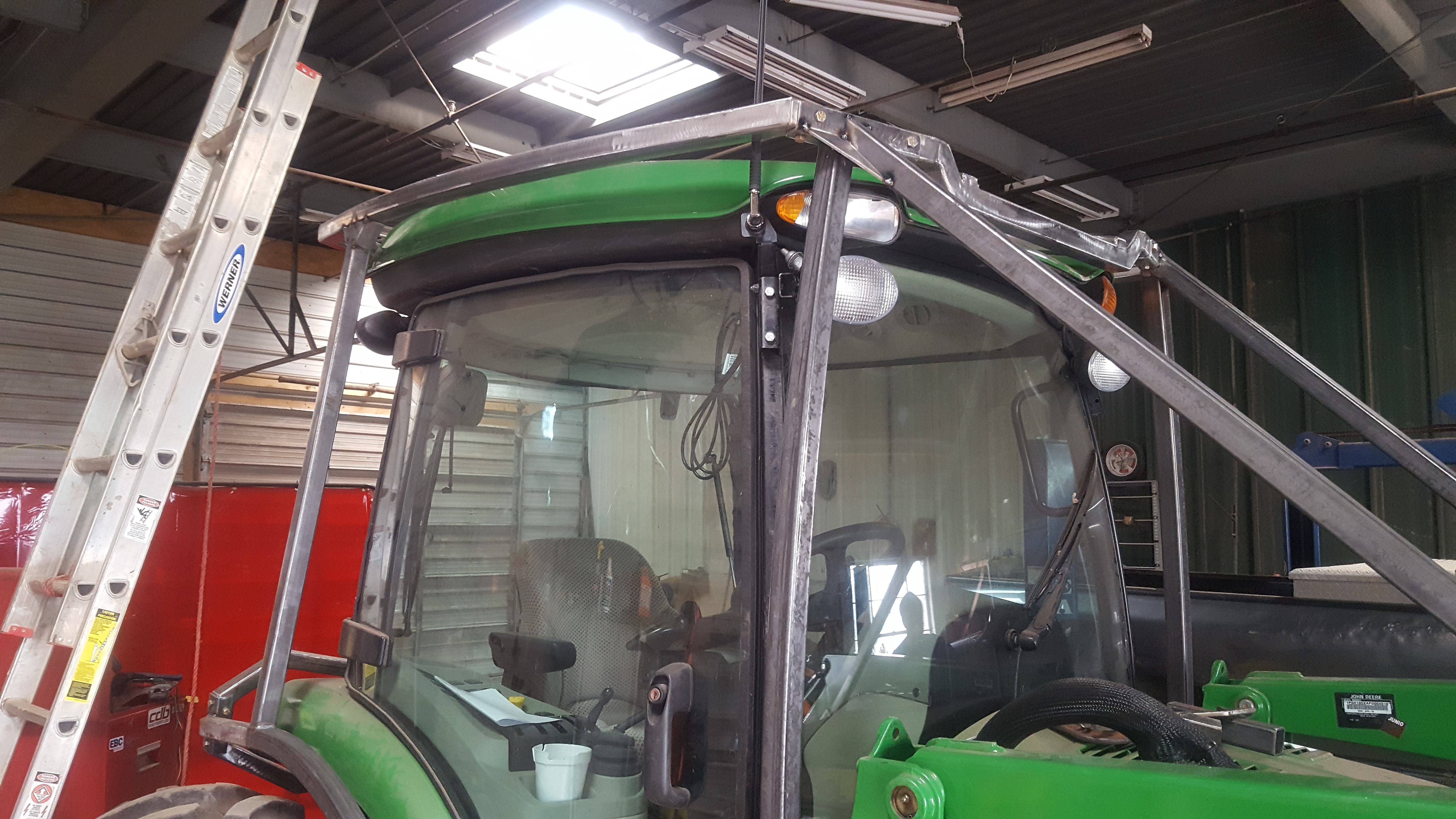

Having a hard time uploading pictures. I have many more, details of mounts and such, I'll add more as I can. This should give you an idea of what I came up with.
   / Cage and skid plate for John Deere 5205 #9

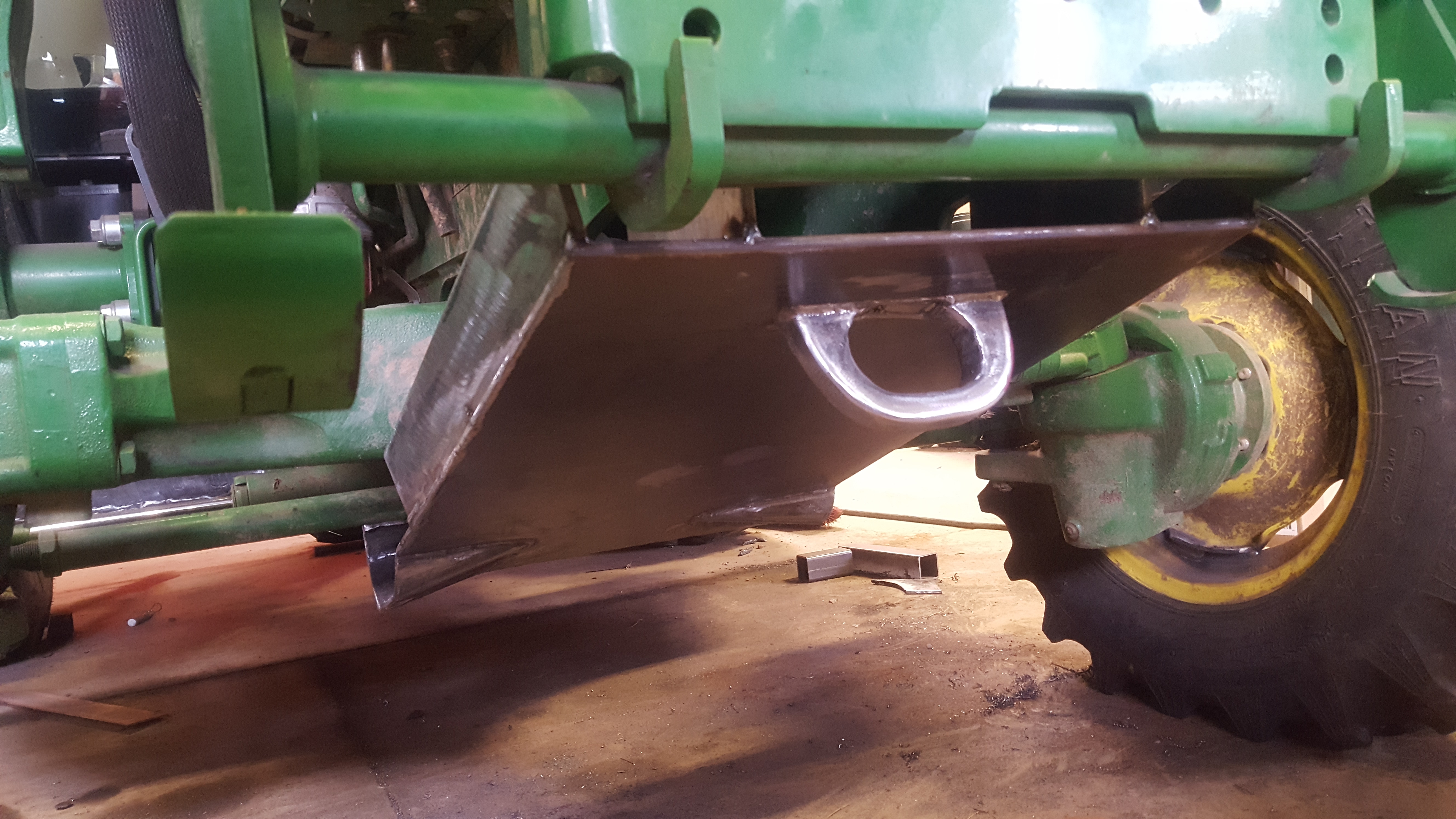

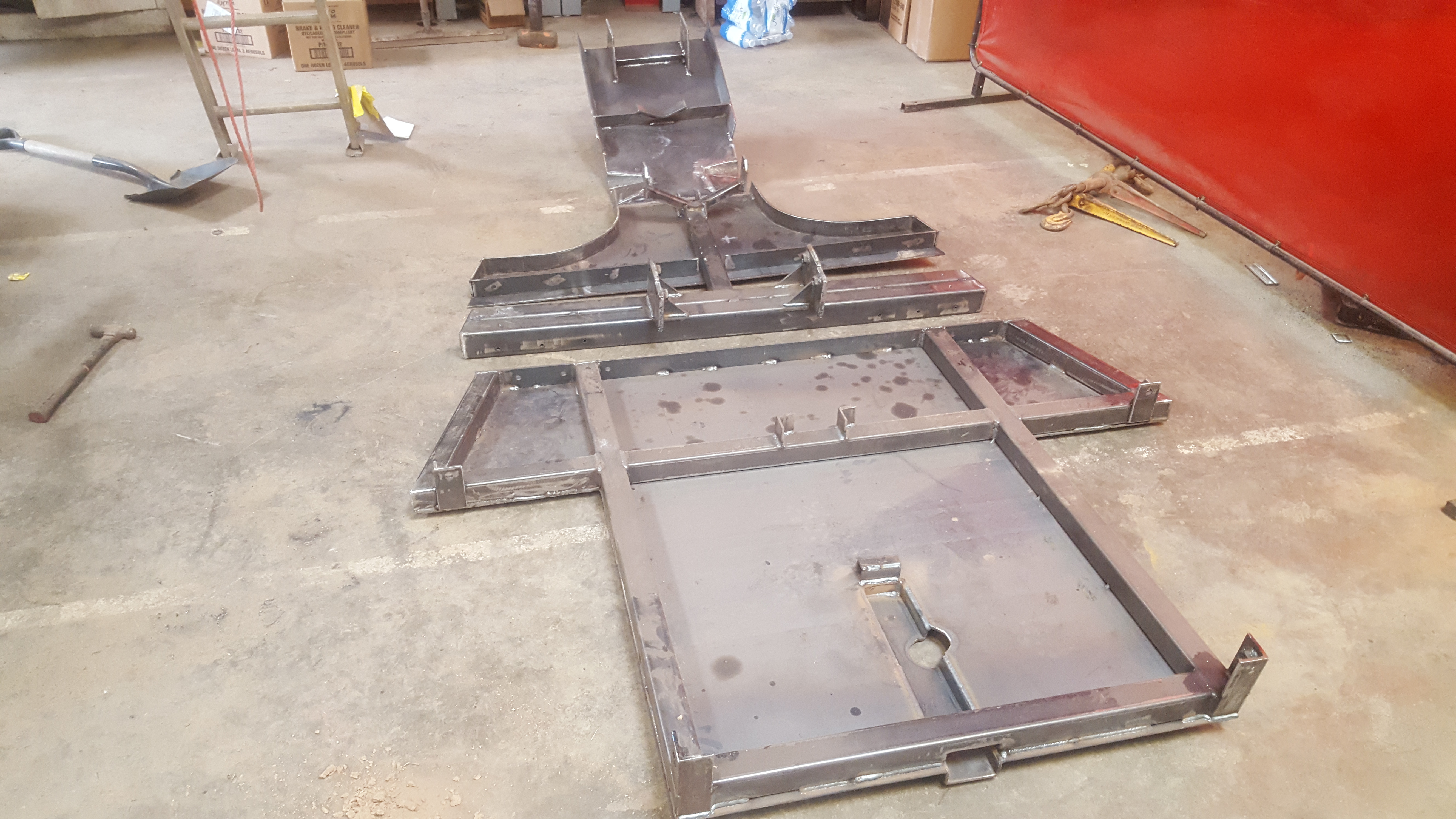

The skid plate was done in 2 pc, with a heafty crossmember at the seam between the 2, just under the front edge of the cab. It does not tie into the loader mounts like my 3005, but uses other unused mounting holes on the bottom of the motor/frame. Each section of skid plate bolts to the crossmember, and to mounting points on the tractor at each end. As you can see, it is full length, and cut-outs for full articulation of the front axle, steering components, and tires were made. Extra pressure point 'stands' were added at key locations so if it did bend, it hit solid points of support, not crushing things like steering cylinder hoses, drive shafts, etc.
I was in the process of changing jobs as I was finishing this project, and never saw it painted, but it was complete otherwise.

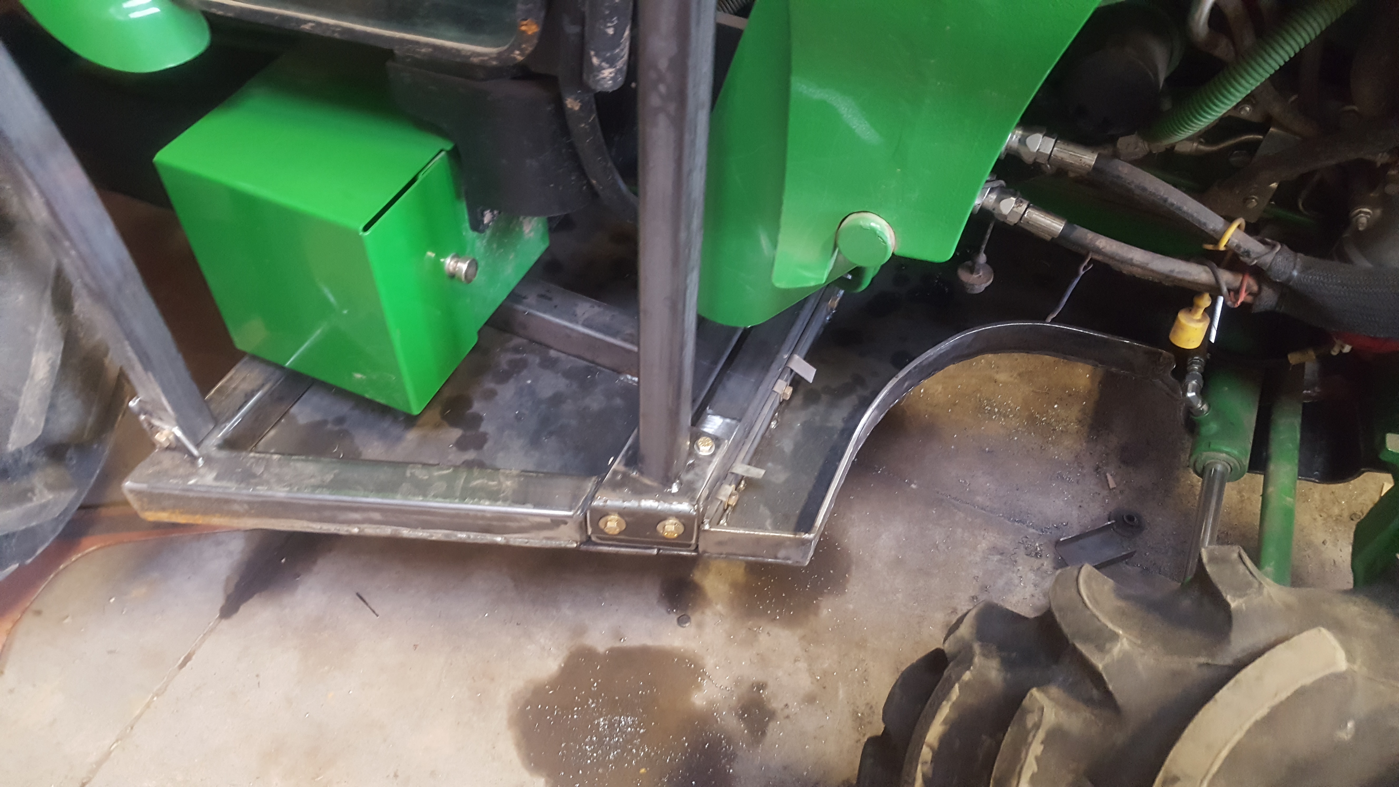

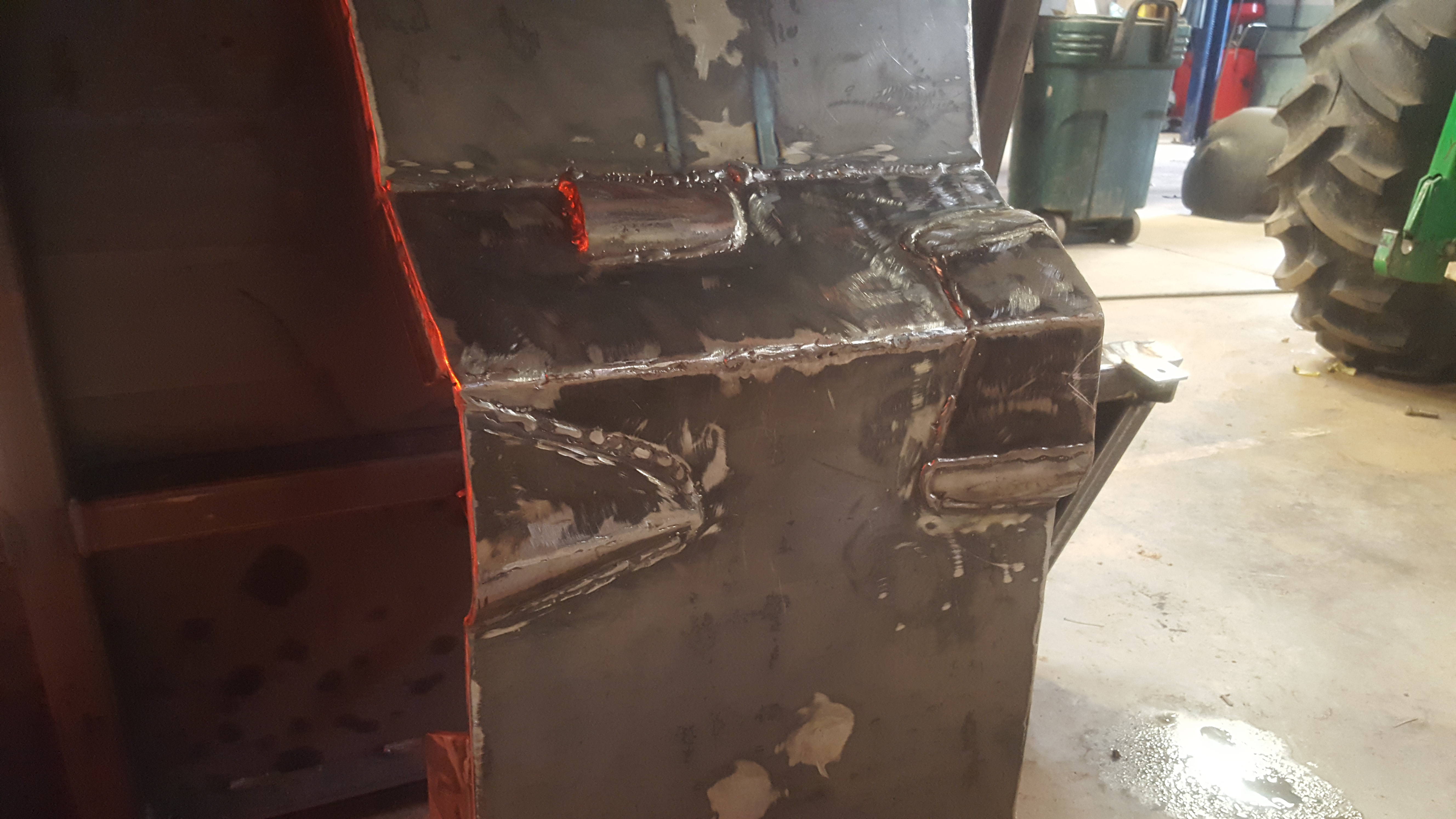

The crossmember served as support for the skid pan, and cage, with the ability to remove the pan or cage without removing the other, aside from the cage wheel well hoops bolting to the outter corner of the rear pan section directly in front of the rear wheels, but the pan can be removed for service if needed.
