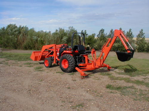

Just completed a CADDigger 708, mounted on a Kubota B2910. Total cost $1500. I bought the steel locally and the hydraulics from Metkit. It works great!

Nice looking backhoe. If you can, put in a couple more pictures. I was thinking about a backhoe for my B2400, but I think the 708 would be a bit heavy. If I go for it I guess I would have to go with the 608.
Did you cut the plates yourself, or did you have them cut in a shop? Tell us a little more about building it.

Thanks for the complement! I had as much fun building it as I do "playing" with it. I torch cut and ground the plates. The rest is cut using a metal band saw. Large holes were cut using metal cutting hole saws such as those made by Makita. 1" and smaller were done with drill bits. All were done using a drill press. Welding was done with an old Miller Thunderbolt stick welder, E6011 and E7018 rod. I made the mistake of spot welding the cutting edge and teeth to the bucket and the first time I used it to dig out a stump, I left the cutting edge and the teeth in the ground. I then welded them back on solid with E7018 rod. The bucket was kind of a challenge to build. Using the sides of the bucket as guides, tacked the bottom to both sides, then welded on a loop to each end and hooked in a cable type come along and started pulling the bottom around the sides and tacking it as I went. I will post some more pictures later.
