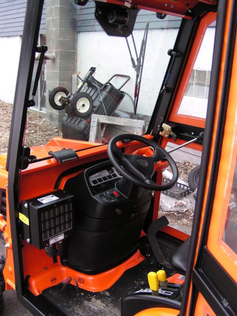

I can't compare the two for you but I will say I am happy with my soft sided Curtis on my BX2200. I have the optional heater which mounts on the firewall of the cab and works fine. Here's a picture.
