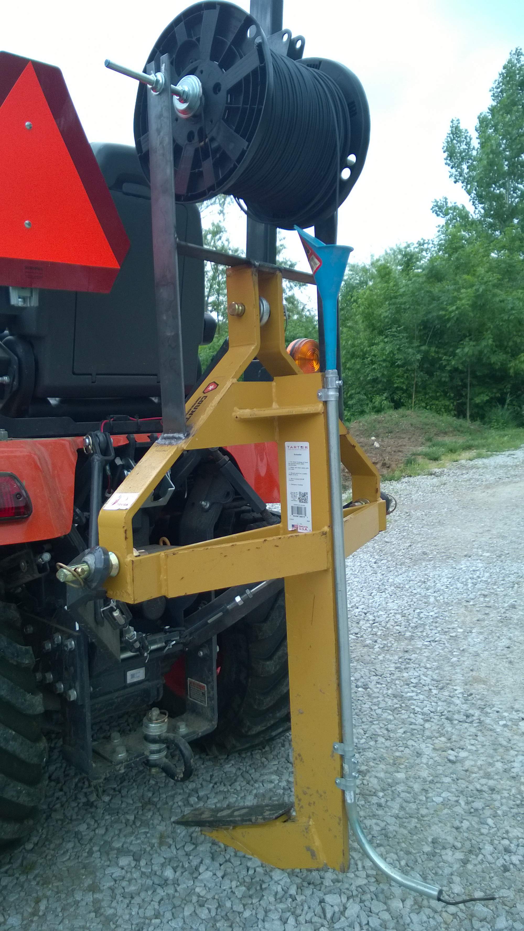

I just ordered an underground fence for my dogs, I want to make a cable trencher for my CUT I was thing about making it an attachment for my rear blade. I have a piece of nice steel, about 4 by 16, at least 1/4 thick, my plan is to cut it so it has a hooked blade in front to help pull it underground, then a few pieces of angle iron to attach it to the rear blade, with a piece of tubing to run the wire through, are there any obvious flaws with this approach.
I want to attach to rear blade for simplicity, I don't need to setup the whole 3pt system and so I can use it as a weight to make sure blade stays in the ground. I have about 1000ft to run about 1.5 acres.

I recently fabricated a spool mount and wire guide (from EMT) for my subsoiler. It works great. I ran about 1,300 feet of heavy gauge (14 I think -- whatever was the biggest "underground dog fence wire"). Took about 15 minutes to run.
I spend a lot of time fabricating, drilling holes in the house, running PVC under gravel, running PVC into house, etc. The actual burying of wire using my subsoiler (again, 1,300 feet) was the easiest and fastest part of the job!

I went much simpler several years ago: Had a steel rock pry bar (straight from end to end). Drilled a hole to attach a chain for pulling. Bent a length of copper pipe and clamped it on the back side with hose clamps. Had my wife pull the thing with our lawn tractor. I steered the pry bar by hand and fed the wire as we moved along. It only needs to be a couple of inches deep. Don't over think it!

Here are some pics of mine. You can see where I added a spool mount on top of the subsoiler and added an EMT tube to guide the wire. The EMT is held in place by a few EMT straps... and is loose enough so the EMT and rotate, allowing the tail to follow the trench as you turn.
