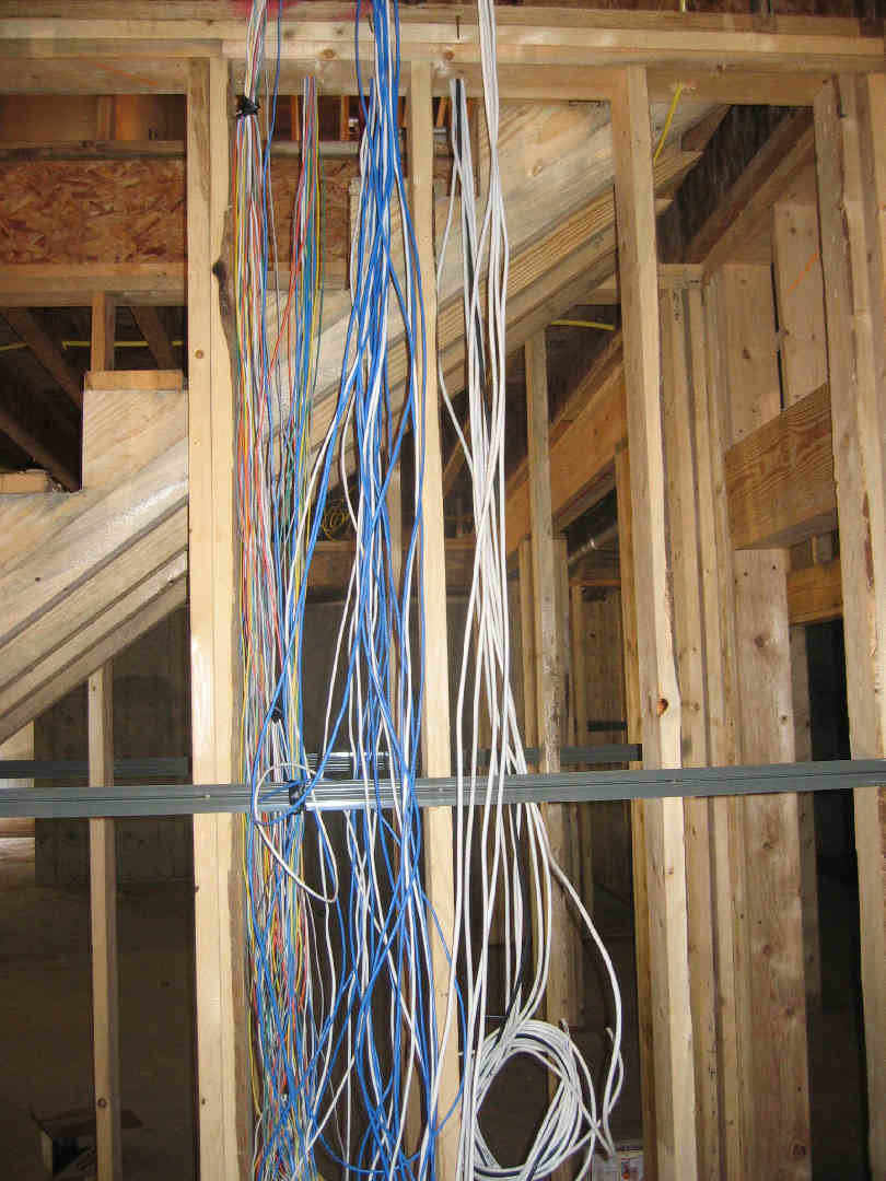

I've already posted this picture on a thread about my home construction, but I think it illustrates what you are asking about. All of these wires will end up in an enclosure (actually 3 enclosures) to allow distribution of satellite, network, phone and security signals.
