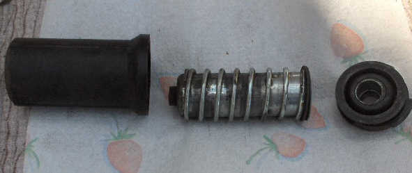

/ CABLE NAME
#22
This is the Hydroback broken down.

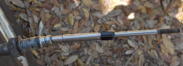

/ CABLE NAME
#23
This cable goes through the Hydroback. and hooks to the linkage.

/ CABLE NAME
#24
I cleaned out the Hydroback, and lubed the springs, body of the Hydroback, all linkage. and cable with a Teflon lubricate. I have to call Terry and discuss where the starting point is. I am going to put the PT up on blocks to safely adjust the Hydroback. It wasn't difficult to take apart and clean every thing.
