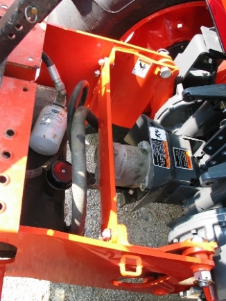

This shot is of the new backhoe mount. The Woods 9000 now looks kinda small on the 5030 (which is a bit bigger then my old 3710 even excluding the cab). All this fancy new paint makes me think about repainting the 9000 - I'll add that to the "list" /forums/images/graemlins/wink.gif
This new mount does away with the long "gun carriage" mount that was used before and instead uses a new box frame on the backhoe along with a very compact frame that runs from the rear loader mount, below the rear axles and bolts on where the ROPS would be in a regular rig. I have to pull 2 big (1 1/4"?) bolts to remove the backhoe - but that's it. Much better ground clearance though I lose a little bit of digging depth. I'll let you know soon how the dismount goes as I was working on a few stumps today.

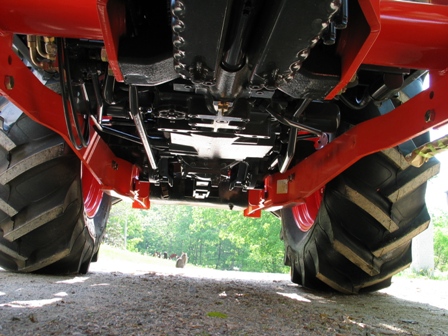

Here's a bottom view of the new tractor. I'll probably never see it this clean again! Orange rails to the rear are the new backhoe mount. I like how they stay close to the wheels so the actual impact on clearance is almost negligable.
Note trained attack cat in driveway guarding Dad's tractor.

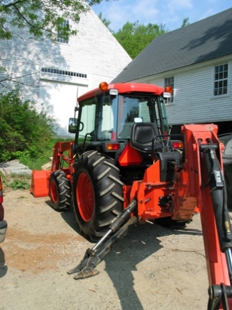

Here's a rear view with my now rusty looking Woods 9000 mounted. That glassy cab can be regarded as the BDS - Blackfly Defensive System /forums/images/graemlins/shocked.gif - works great.
