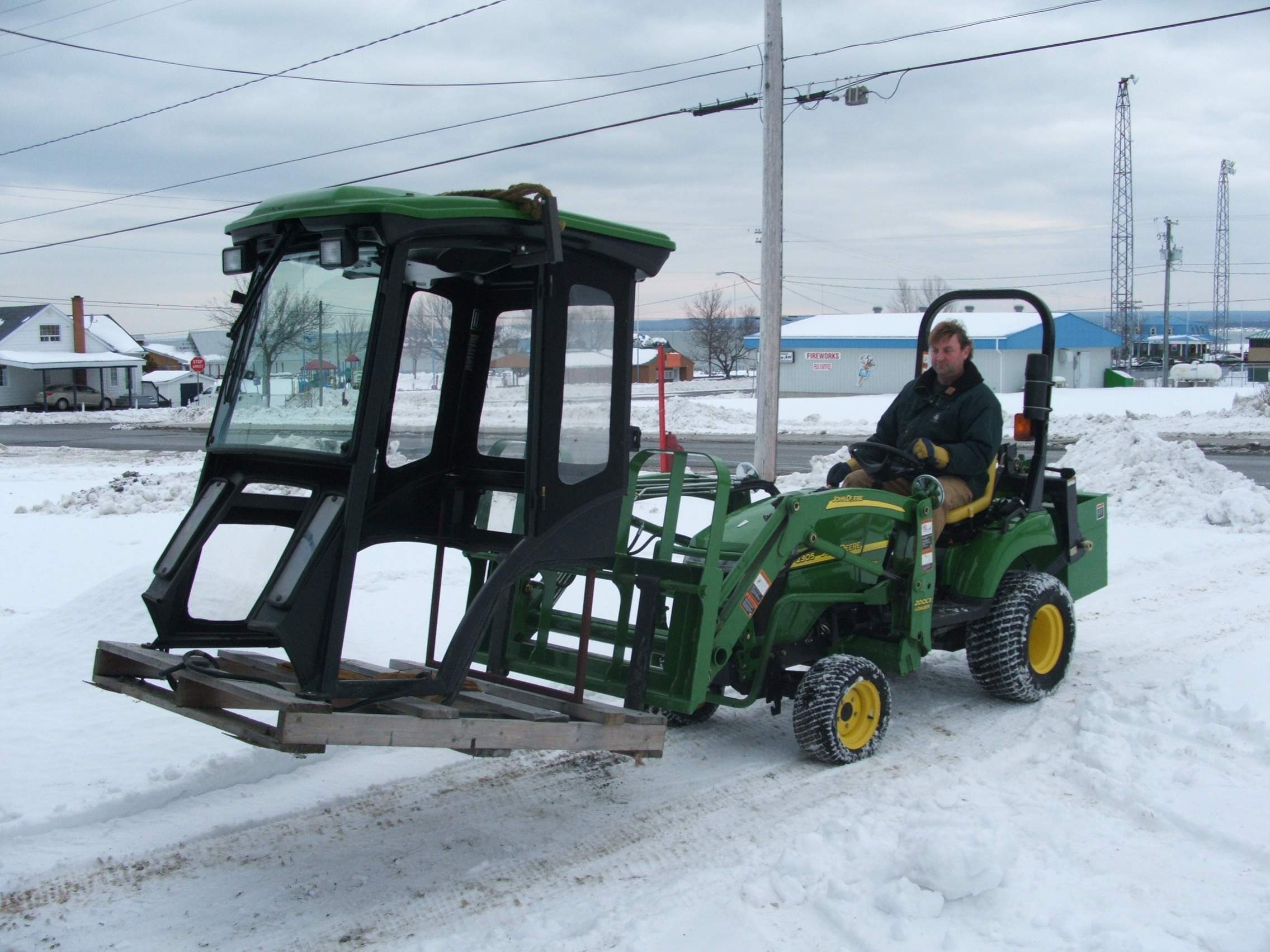

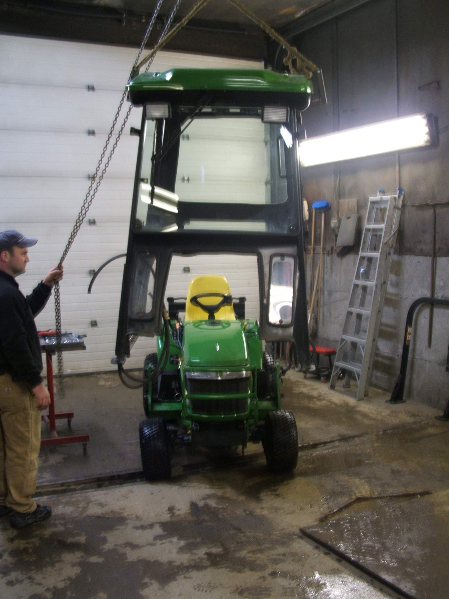

I remove mine every spring. The initial installation took a full day, but now it takes me half a day when I'm alone. I use a pulley system to help out. Keep in mind that my cab is ROPS so I have to remove the one on the tractor first. It also have the electrical and hoses connection for the wiper, lights and the heather. Henri
