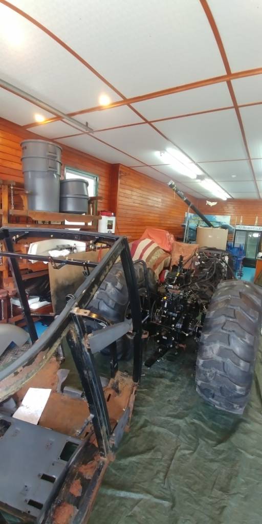

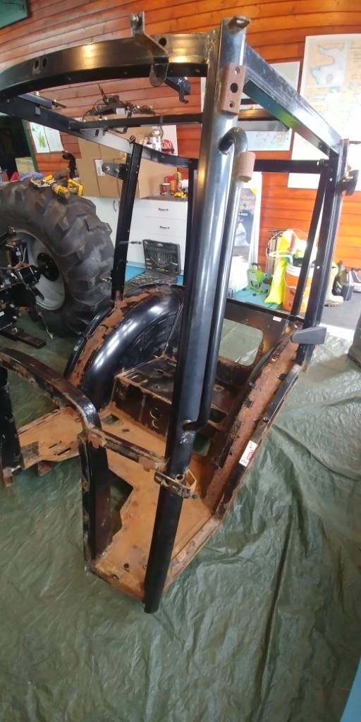

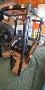

Mahindra 5010 cab hst
Previous owner used for snow clearing wasn't big on preventative maintenance....
Have cab stripped down and removed to be sandblasted and coated - either bedliner or epoxy .. Heads up to check the bottom of the middle cab post - its not sealed on the Mahindra so all that nice salty water rusted the inside of the cab fenders ....
Gong to cap off the bottom of the middle post before painting.
