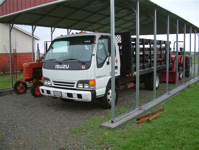

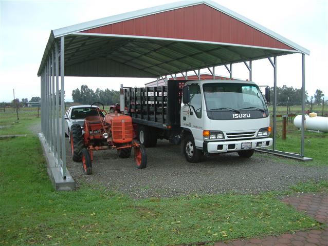

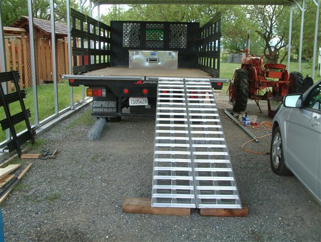

I like Isuzu's also. Mine is a 2004 NPR/EFI stakebed (8x14 ft by Supreme). Has the GMC/Chevy 6.0L LQ4 V8 gasser, 4 speed auto, PS, A/C, 4.777 to 1 rear end. GVWR is on the small side, 12,000 lb; but I've seen NPRs with 18,000 lb GVWR. GCWR is 18,000 lb for my NPR. I had it weighed on the scale at Petro--7100 lb with 3/4 tank of fuel, my tool box, an 8000 lb winch and me. The wheelbase and overall length are about the same as my 2001 F150 short cab/long bed PU. Gets about 12 mpg unloaded.
NPRs of all kinds (box trucks, stake beds, dumps, utility beds) show up all the time on eBay. That's where I found my NPR (49,500 miles, $11K).
