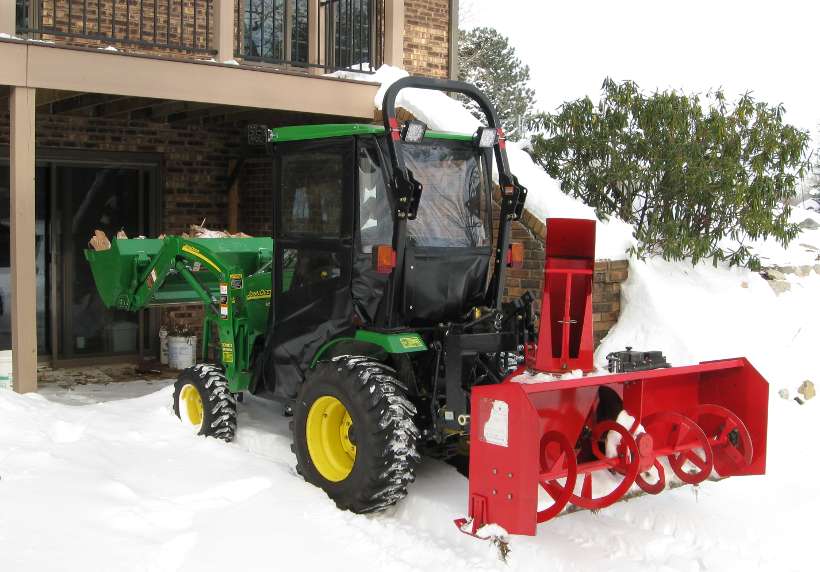

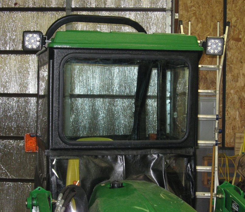

The doors, like the rest of the cab, are steel tube frames with vinyl covers. Everything braces together and is very rigid when installed. I've used mine two winters and it looks just like new. The hinges are pin and sleeve. The doors have just enough flex to bend and install, so they are easily removed. It is a soft cab but I find it very tight and don't notice any troublesome gaps and drafts. On my 2320 I get a surprising amount of heat off the engine. I don't have any other heater. Obviously you can't be in shirtsleeves but I've used in for extended periods of time in -10F temperatures wearing Carhartts and a stocking cap and been comfortable.
I haven't had much fogging problems. I have the glass windshield which has a plastic/ABS frame and is quite substantial. The rear window can fog if I get too close to it while snowblowing. If I keep my face a little away, no problem. I get snow on the back window sometimes but if I tap the window it usually falls off. I didn't get the windshield wiper or other options and haven't needed them. I did add front and rear LED work lights (from E-bay) and golf cart rear view mirrors.
