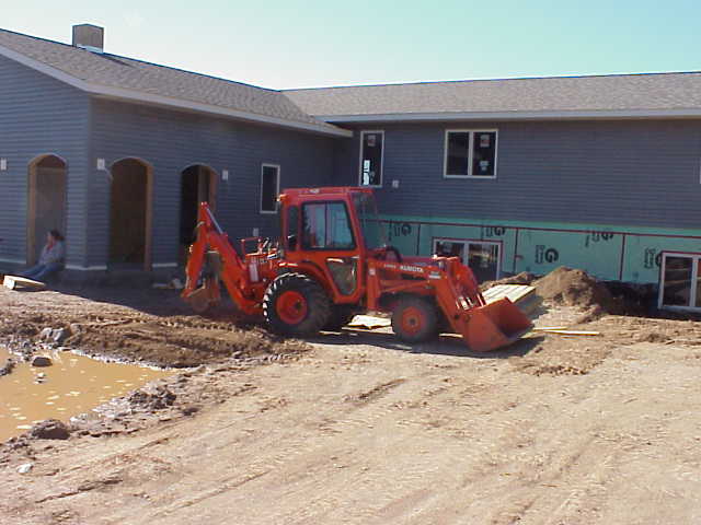

Got my new Sim's cab recently. Fits well, good visability, lotsa room inside cab. I had to remove the rear glass (6 bolts) to use the BH (I'm 6'2" and had the BH seat all the way extended and it did contact the glass.) It has a heater for these cold MN. winters. It came with the fuse box and wiring. Very good color match. Tinted windshield. Electric wipers. I'm happy with it. It is what I need and want and not suited for everyone.
thanx

The cab was part of my original purchase package. It came from the dealer. It was also dealer installed. It is mainly 5 steel panels (fairly heavy steel) all bolted together. The heater is mounted to the front panel, below the windshield glass and to the left of the steering wheel, and it's pretty much out of the way. Two heater hoses come from the engine compartment to the heater and they have shut-off valves inline with a drain petcock. Two adjustable louvers to direct the air flow. Most of the wiring harness is concealed within the cab structure itself. There is an electical control panel with fuses overhead, within easy reach, for lights and heater. The front wiper has the switch right on the motor. I wanted a cab because I live in a cold climate and plan on using this machine all winter (even though it has it's own stall in the heated garage). A lot of posters here live in a less harsh climate and really have no need for this additional expense. We are having 85º weather in October, but I KNOW we will get cold soon.
More than happy to answer any questions.

Nice looking rig. Do have the folding ROPS on your tractor?
I guess my real question is: How high is the tractor with the cab? Will it fit under a standard 7' high garage door?
I have to fold my ROPS to get my B2910 into the garage. Before I had the backhoe mounted, I had the standard ROPS and I could drive that into the garage with a few inches to spare. I might be interested in a cab sometime IF it will fit into the garage.

I think it's 82", if I remember right. It's at my mothers house, which is next door to our new house, so I can't just walk outside and measure it. The cab was put on while I was on a fishing trip and the dealer has a folding ROPS for it, just hasn't installed it yet. I had 8' doors put in my new garage, just to make sure I had clearance. I really believe you would be in trouble with a 7' door. What tires do you have?

I finally got around to measuring it and my ruler says 81" on the nose.

A ROPS is still required for safety. Even the all-steel cab is not a substitute for the factory ROPS. The picture of my tractor does show the wrong ROPS. I had the rigid ROPS in the pic, not the folding. The folding is about 6" taller.
