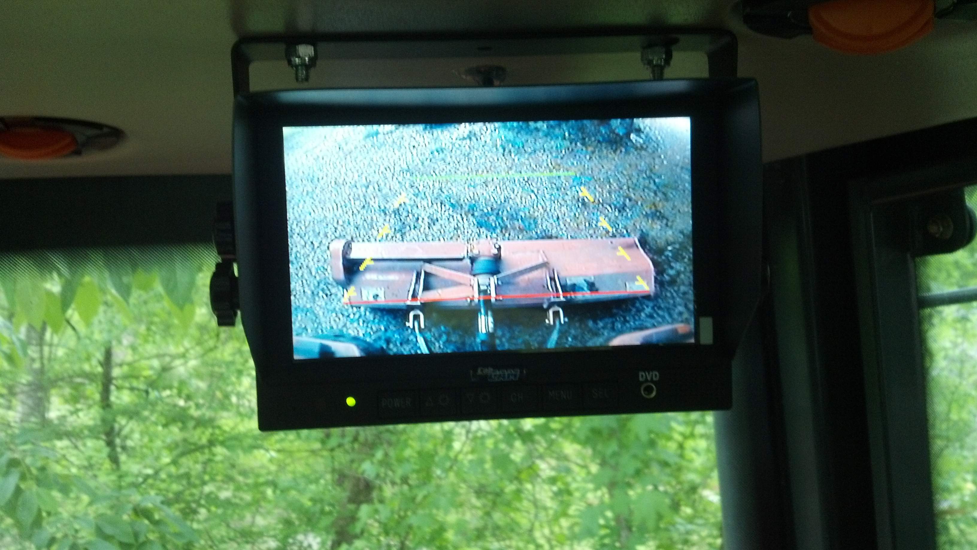

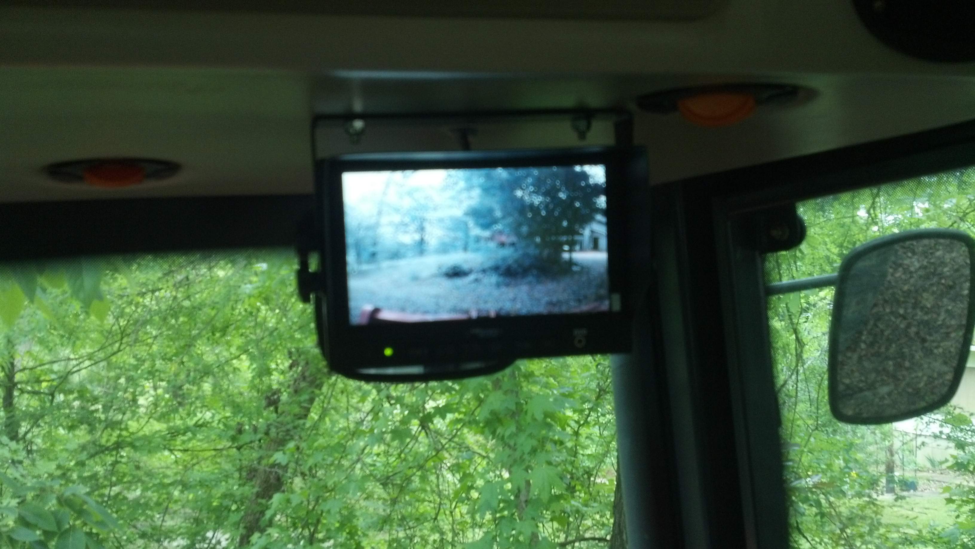

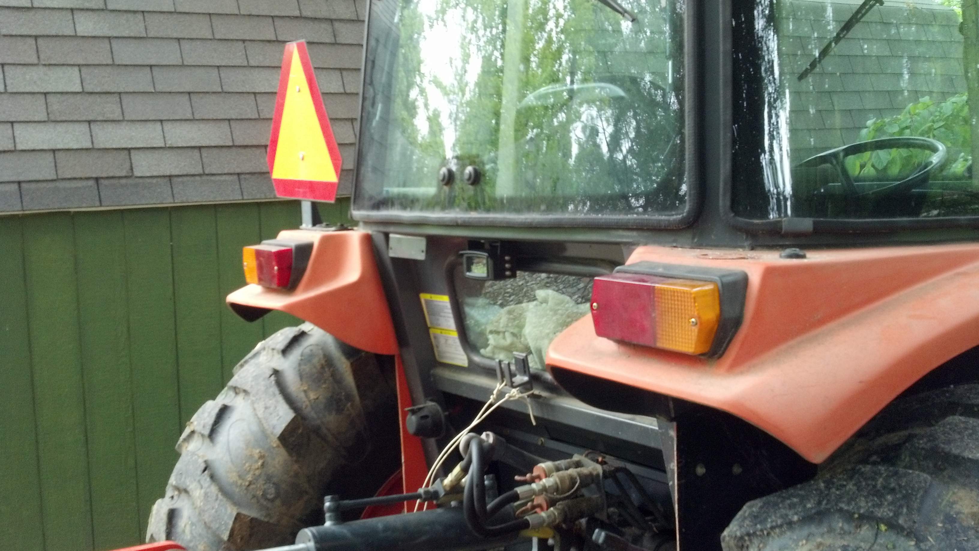

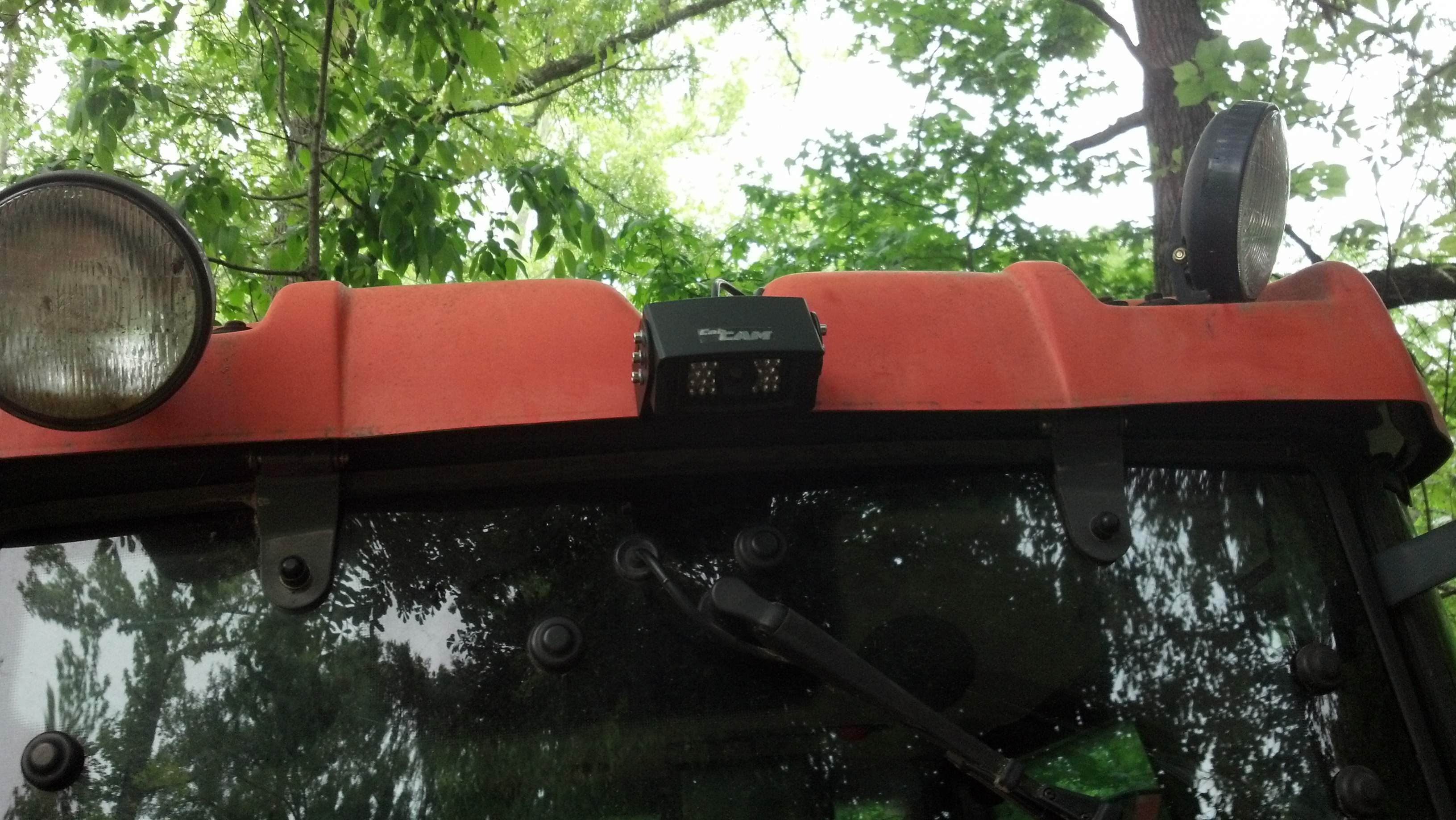

Ive compleatly worn out my neck from looking behind me while bush hogging fields over the years. And now that ive got a Cabed tractor seeing behind me is even harder especialy with a flail mower, its sits to close to the back of the tractor. so i bought me the back up camera called "Cab Cam" and installed it. i got two cameras with mine but i probly only needed one. so i put one camera set so i could see strait doun at the emplement and one cam looking strait back. It even works in the dark.

the hardest part was mounting the cameras to the out side cab some cabs dont have much area to mount to because of all the glass. A remote camera would be good too as long as it was powered by the tractors electrical system i wouldnt want to mess with batteries for a camera.

How hard was the install?Are they both hard wired?
yes they both wired. the one in the roof was easy. but the lower one i had to drill holes through the metal to the inside of the cab and i had a few problems before i figured it out. I learned not to rob power from my radio power supply because the cameras seem to make interferance for the radio so i had to use another power supply in the roof besides the radio.
