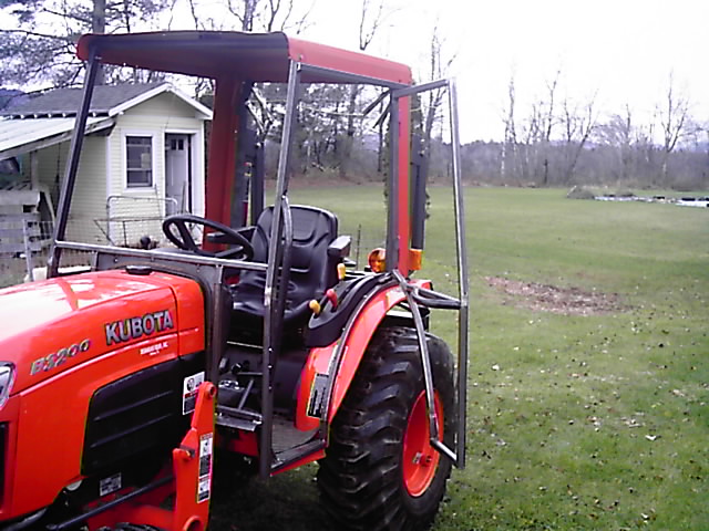

When I built my cab I simply welded a bushing to the door frame and with matching shaft added a 1/8 X 1" flat inside to serves as latch and handle and a similar flat to the outside.
Outside one has a fancy plastic knob for looks.
Only trick was having it weight balanced so that it stayed in latched position.
So inside is horizontal while outer is vertical with knob at bottom for weight.

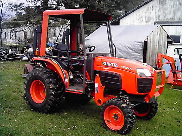

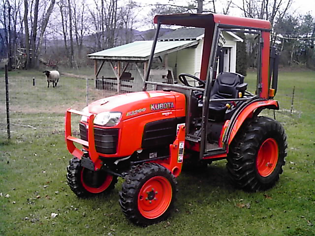

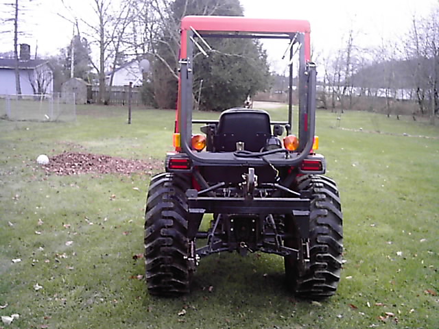

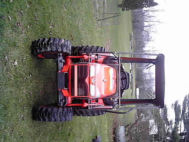

Ok here is a few shots of the cab. When I get it all done I will start a thread with as many pictures as I can.
Robbie

Very nice. I'm working on a similar frame off of a B7200 that I purchased from a driving range, It was used to pick up golf balls and had expanded metal welded to the frame for security and safety from the golfer's drives. After cutting and grinding down a couple hundred welds, I'm finally getting down to making mounts. Mine has the same "suicide" doors as yours does. They just used some bushings and a simple slidebolt for a latch. A bit crude, but seems to do the job.
I'm considering using an orange colored lexan for the lower half of the cab so I don't have to be so concerned with scratches;about $100 for a 4'x8' x 1/8" sheet with a $20 cut charge. I'm thinking that 20 bucks may be worth it to let someone else cut it by my patterns.

What are you using to cover the area on the front of the cab below the windshield and over the pedals?

I'd consider adding a right hand door in case you tip the tractor on its left side like in photo 2. That way you have a way to crawl out without having to try and kick windows out.
I am going to use laminated safty glass on the lower section and the windshield. I would love to use it around the entire cab but I think the curves around the fenders would be hard to cut.
Looking good!
I will have a window that opens on the top section of the right side. A door would be nice but I figured the cab would be much stronger with out it. It would not take a lot to convert it over to a door though.

Hello Rob...nice work so far on your cab. I was wondering if you could tell me how you got the nice curved edge on your door where it follows the contour of your fender? Also, could you show a close up of your door hinges and how you constructed them? Thanks.
