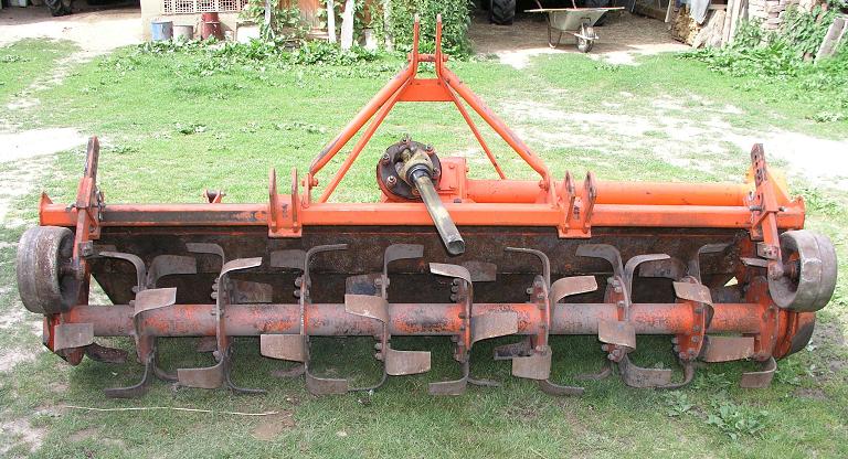

Hello Mark,
Can you, as MFG, explain me a difference in work, benefits of each type, and why and when to use L or C tines, please?
My Howard HR20-230WU (bought used) has L tines installed, and you're right, C is an option. THX.
