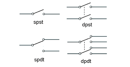

FYI:
SP= single pole (pole loosely means how many (independent) "circuits" (or "power sources") there are)
DP= double pole
ST= single throw (how many "outputs") ST has one contact that opens/closes
DT = double throw (each "pole" has a "normally open" (N.O.) contact that works opposite of a normally closed (N.C.) contact when switch is operated.
...and note, even on double pole switches the two terminals shown on the left can be jumpered together so that only 1 wire is connected on the left.

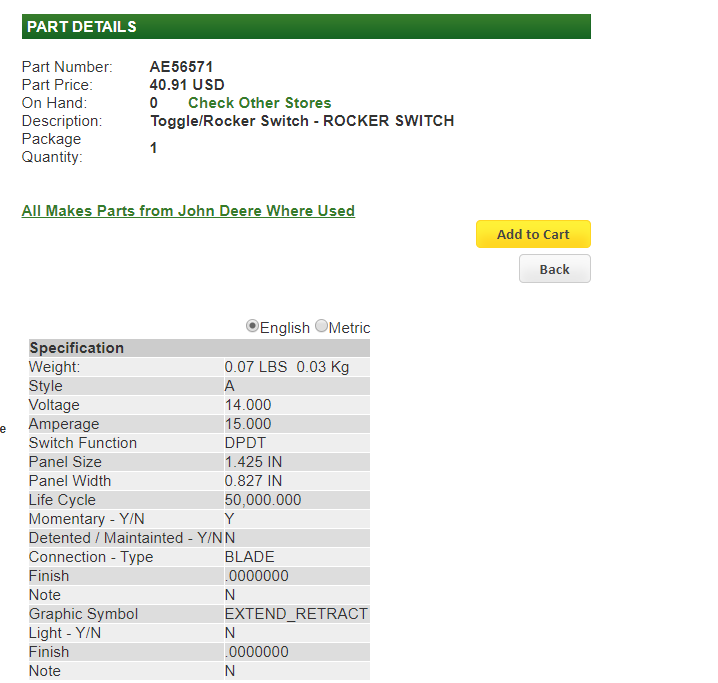

Shown below is a rocker switch utilized on JD rd balers to operate twine arms if bale monitor malfunctions that might operate your balers twine arm actuator. I will guess switch is available cheaper from other source than JD

Also, it sounds like you may need more than just the switch, but Messicks lists the switch for $48.65, part #7723372, "2 in stock"
