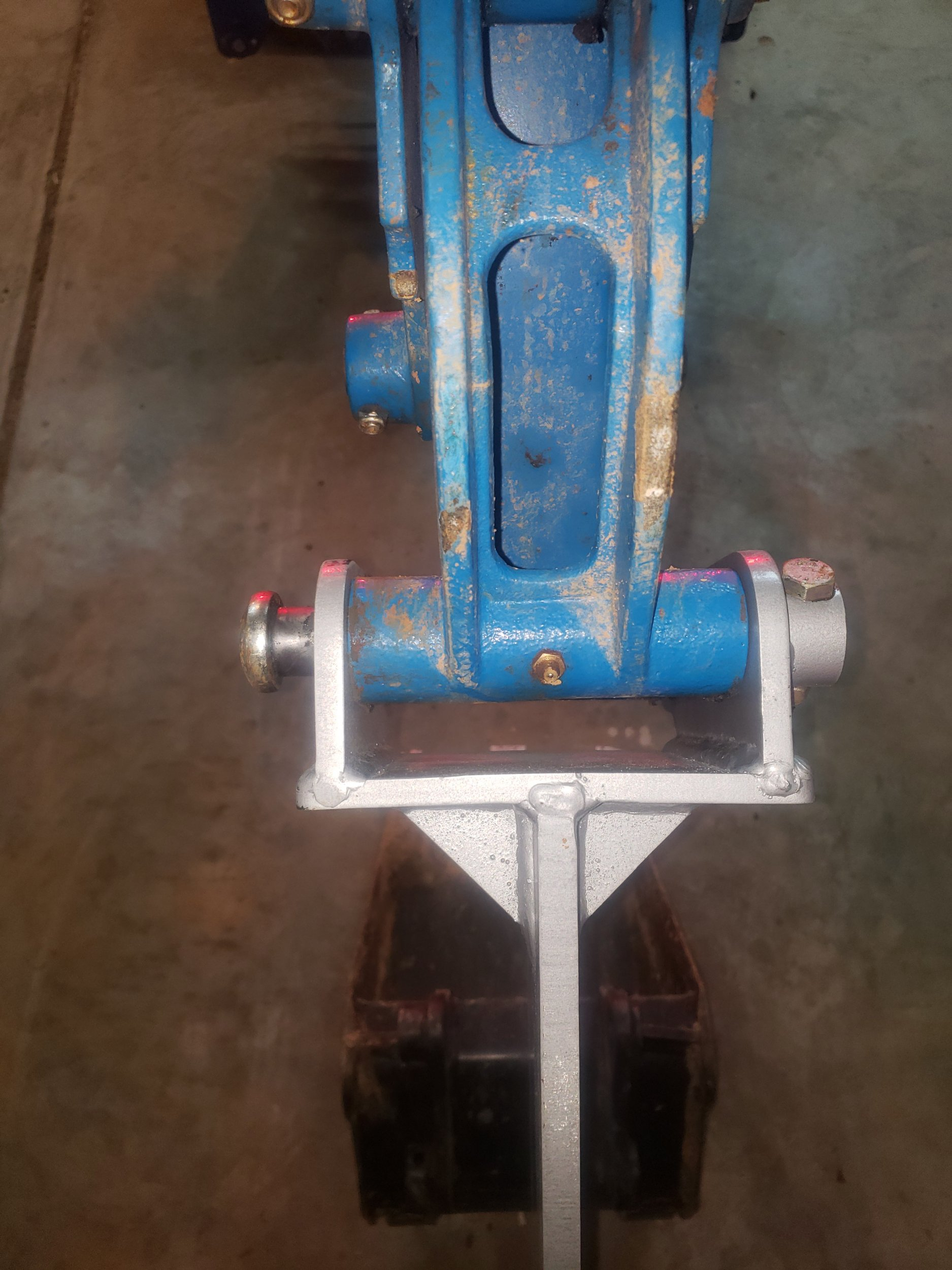

Has anyone mated the BXpanded ripper tooth to an LS backhoe yet? Seems they offer it as JD/kubota but I'm wondering if it'll bolt up to an LS. I could find much use for it, so any help is appreciated.

I contacted them asking for their specs on pin size and location. Maybe it will pin up to my Woods (not likely) but maybe an adapter can easily be fabricated.
I havent heard anything back from BXpanded, and I doubt I will, but it was worth a shot.
If I do hear back, I'll share my findings here.

I heard back from BXpanded. My original question was:
"Can you please tell me the pin size and locations for the ripper tooth? I'd like to either make my own adapter or see if it will simply pin onto my Woods Backhoe. Thank you!"
I wasnt expecting much, but after a few emails back and fourth, here is the answer I got:
"Here are the sizes we can offer:-
BX:
1”Pin
Inside width: 37/8 “
Center to center Pin width: 5”
B:
1”Pin
Center to center Pin width: 61/2”
JD:
1”Pin
Inside width: 5 3/8”
Center to center Pin width: 5 5/8”
Hope this info helps. I plan to measure my backhoe and see if any of these gets close. Like my question said, maybe I can make an easy adapter to allow me to use a BXpanded ripper.
I am quite impressed with their customer service so far. Same day response to a non-customer asking a potentially hard question to answer. Kudos to BXpanded!!

Update***
I finally got to measure and order one. The measurements for my backhoe seemed to be very similar to the jd 260b so I ordered it. When it arrives, ill follow up
   / BXpanded ripper tooth
Here it is, installed. As you can see, the pin hangs out a bit, but it won't slide because of the pin locks. Everything is perfect for the ls MT122/25 series. I ordered direct from bxpanded and told them I have a JD 260b for correct fitment. Thanks to the poster above who contacted them! Time to get some stumps and roots out!!! I hope this helps someone who is not sure what to order, but wants a ripper.
