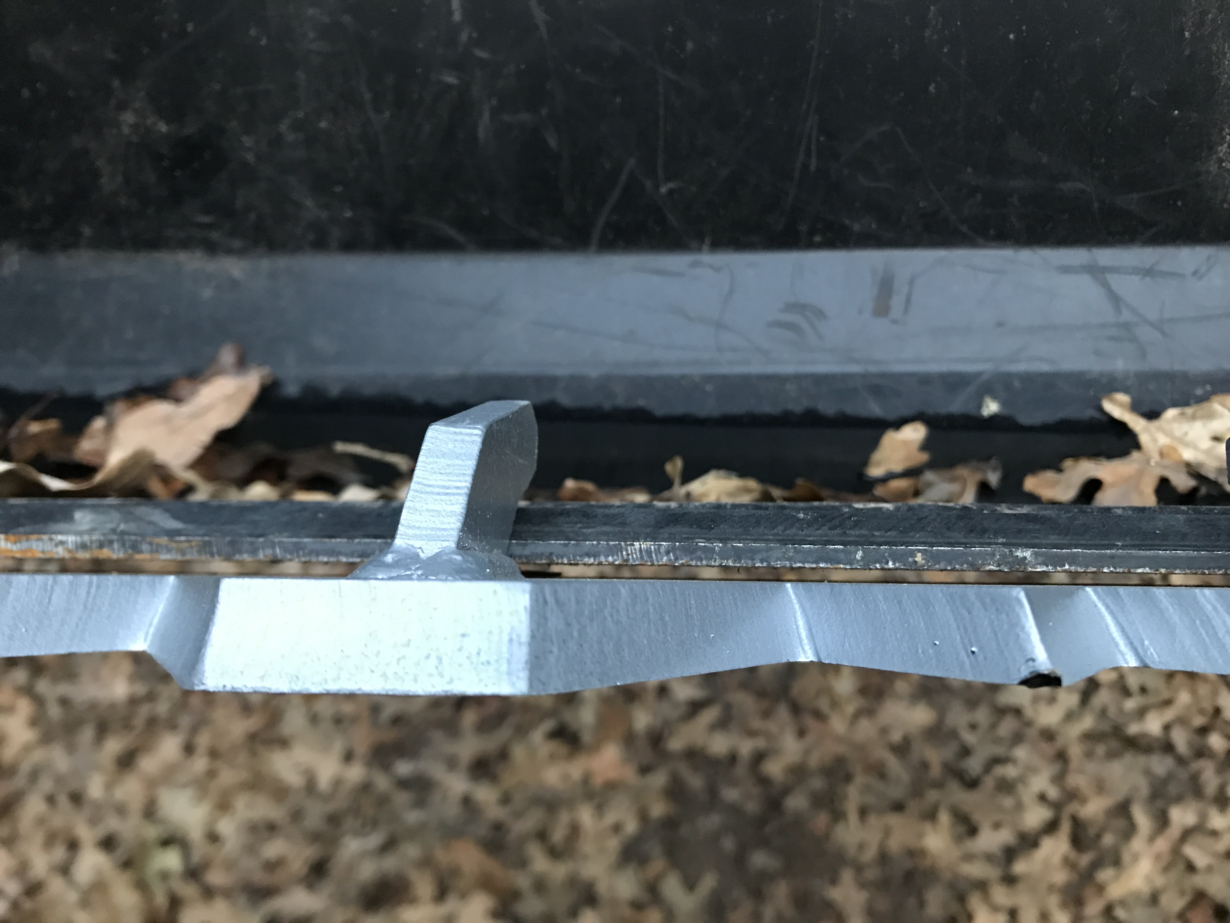

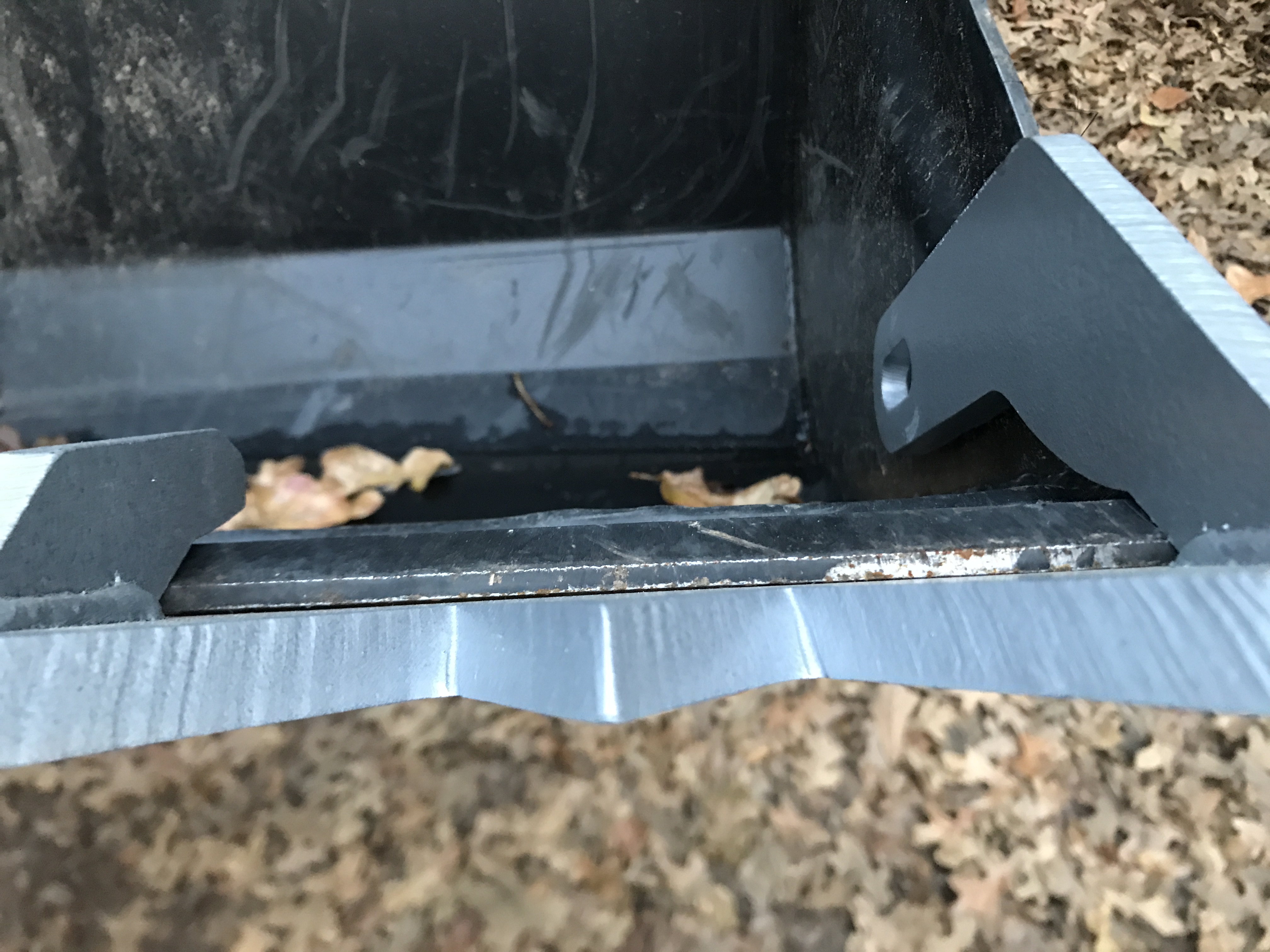

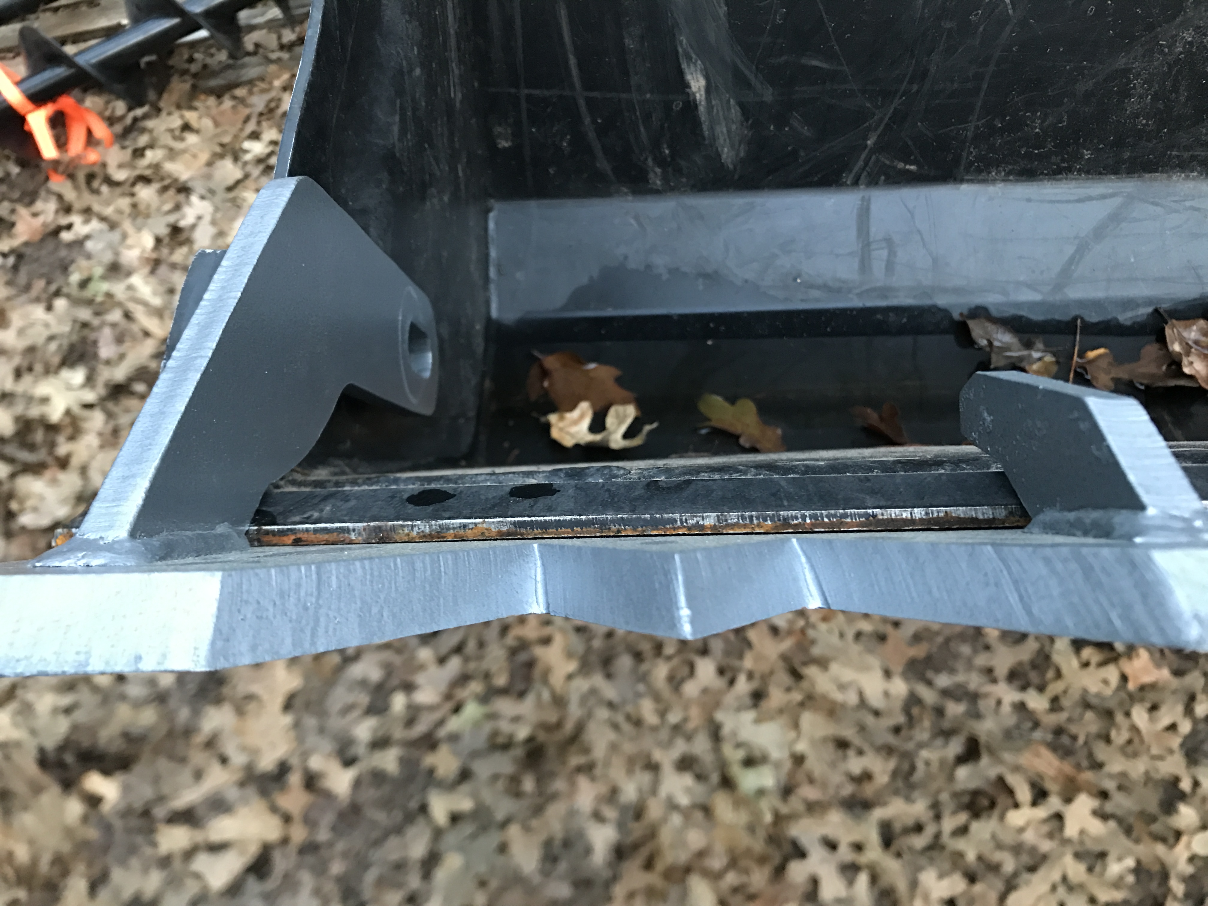

Howdy y'all, I just got my PTB delivered this week. With dark coming so early it's been sitting for several days. I have been very excited to get it installed. I got off a little early this afternoon so I had time to swap the forks and bucket to at least put it in place. I was a little disappointed with the fit and finish. The ends fit perfect but the middle has about an 1/8" gap between the bucket and bar. The bucket edge it perfectly straight, only about 13 hrs on the bucket. Is this normal? I put an eyeball down the edge of the bar and the "cleats" on top of the bar are obviously not in line. Am I being over critical? Is it going to wear in? I've got a lot of work for the bar lined up and don't want to wait a couple more weekends to send it back. Any advice would be greatly appreciated. IMG_0501.JPGIMG_0502.JPGIMG_0503.JPG

Try using a piece of 2 x 4 or 4 x 4 and slam the PTB on a little more, so that the Gap disappears.
   / Bxpanded piranha tooth bar #3
The instructions for the PTB say to use a couple c-clamps to hold the tooth bar flush up against the bucket while marking and drilling the holes on the side of the bucket. If you clamp it per the instructions, do the clamps draw it up flush with the bottom edge of the bucket? If so, then do that and mark the holes and drill them.
If so, then there could be a bit of a weld where the cleat is welded to the tooth bar that is keeping the bar from sitting flush. Pull it off the bucket and check that. If that's the problem, a quick swipe with an angle grinder should fix it up.
   / Bxpanded piranha tooth bar #4
I had a similar issue when I got my PTB. My bucket edge would not seat fully into all of the cleats. I put dykem on the inside of the cleats then put the PTB on as far as it would go using a hammer and block of wood. This allowed me to identify which cleats were causing the fit interference. You can do the same thing using a black magic marker, if you don't have dykem available.
I then used a die grinder and a carbide burr to relieve the inside of the cleats that were causing the fit interference.
I did this a few times until I got the fit I wanted and then clamped the PTB to the bucket and drilled the mounting holes.
It took me about an hour to do this and I thought it was a lot simpler than going through the hassle of returning it.
   / Bxpanded piranha tooth bar #5
My one time experience was the the PTB was straight and true. No doubt that your results may vary but don't be too quick to say the PTB is off. Did you true and square your bucket? Regardless, you are expecting a glove fit... but we all know a little persuasion is key. Good luck.

Yeah I beat it pretty good with a 2lb dead blow. the issue is the cleats go higher and forward toward the middle of the bar. thanks for the input.
When I clamp the bar in the middle it pulls it up flush, there's no slag holding it off of the bucket. The cleats are mis-aligned with each other. When I release the clamp it reopens the gap in the middle pic.

Good idea, maybe i should grind a little on the teeth on the ends to allow the ones in the middle to sit flush. Thanks.
