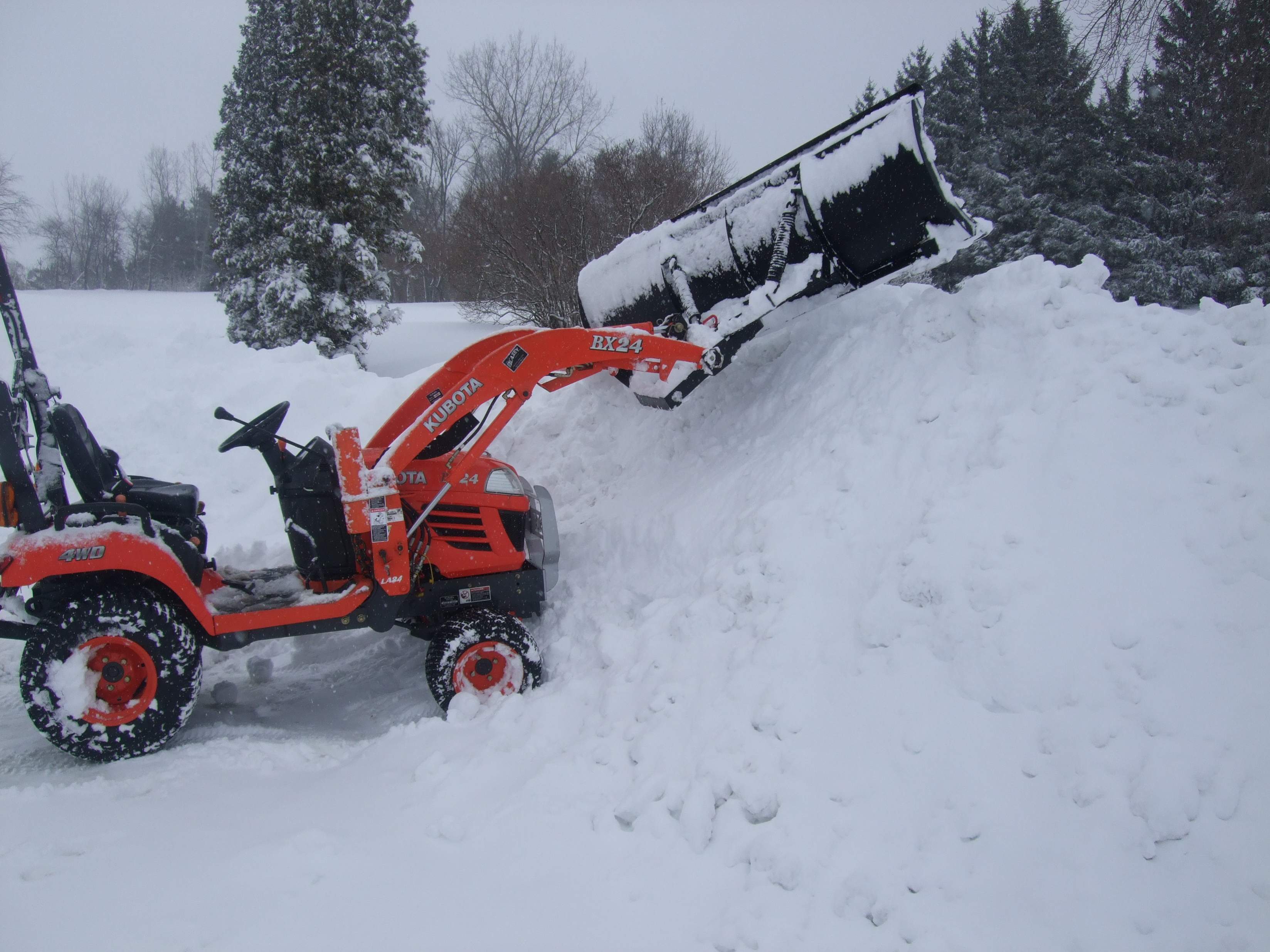

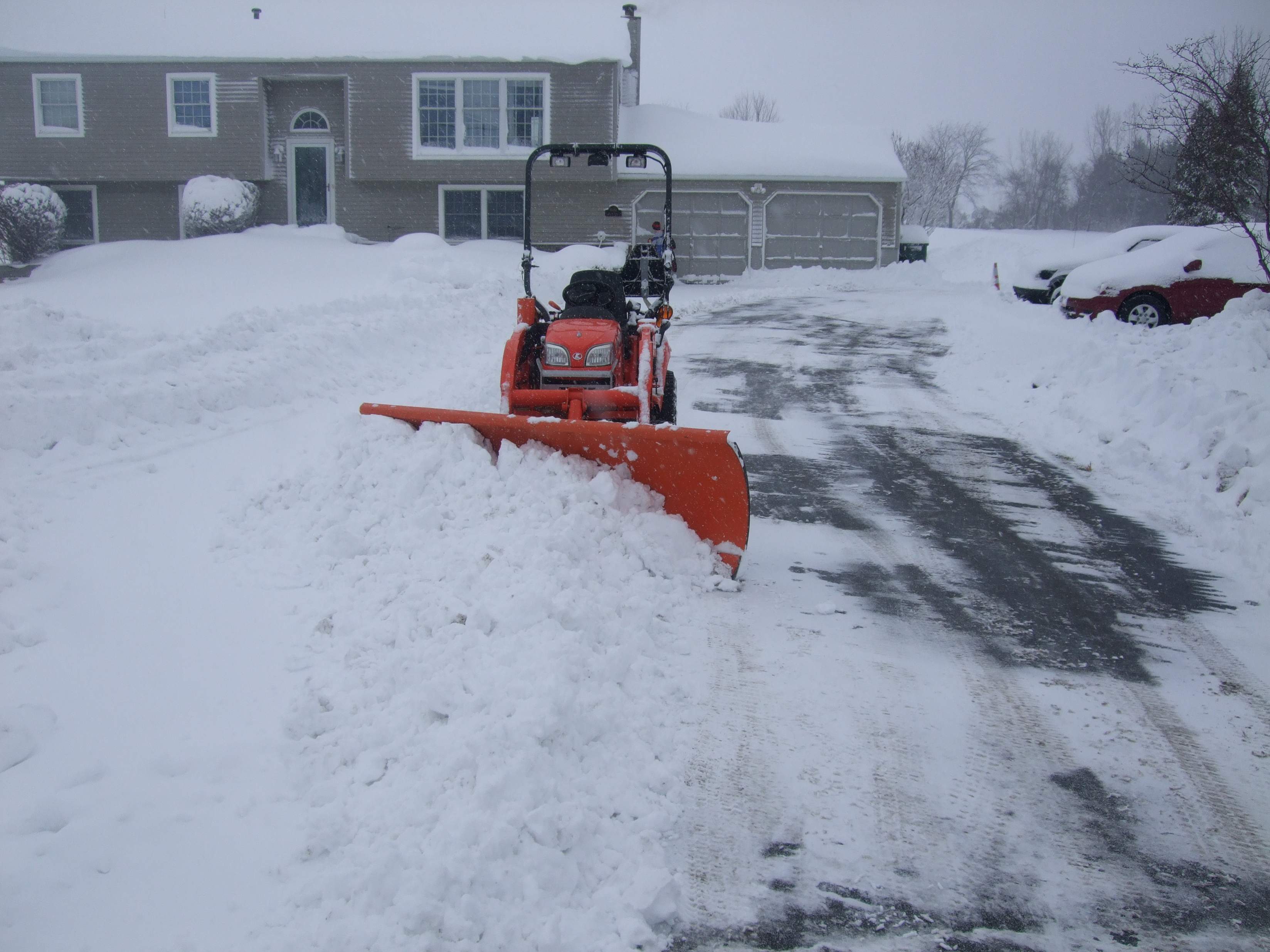

The reason why you run out of room to push snow with atv is because of limited up travel. When pushing snow to a bank, you should be making a ramp. Over time the snow ramp becomes packed down, you can literally push snow up the bank and over. I did that with my el cheapo tractor and fixed plywood blade for one season.:eek: Now I have a truck plow mounted on my FEL arms and I can push snow up the back and over if needed. Oh this was done with a BX. :cool:

Harry, looks good!
