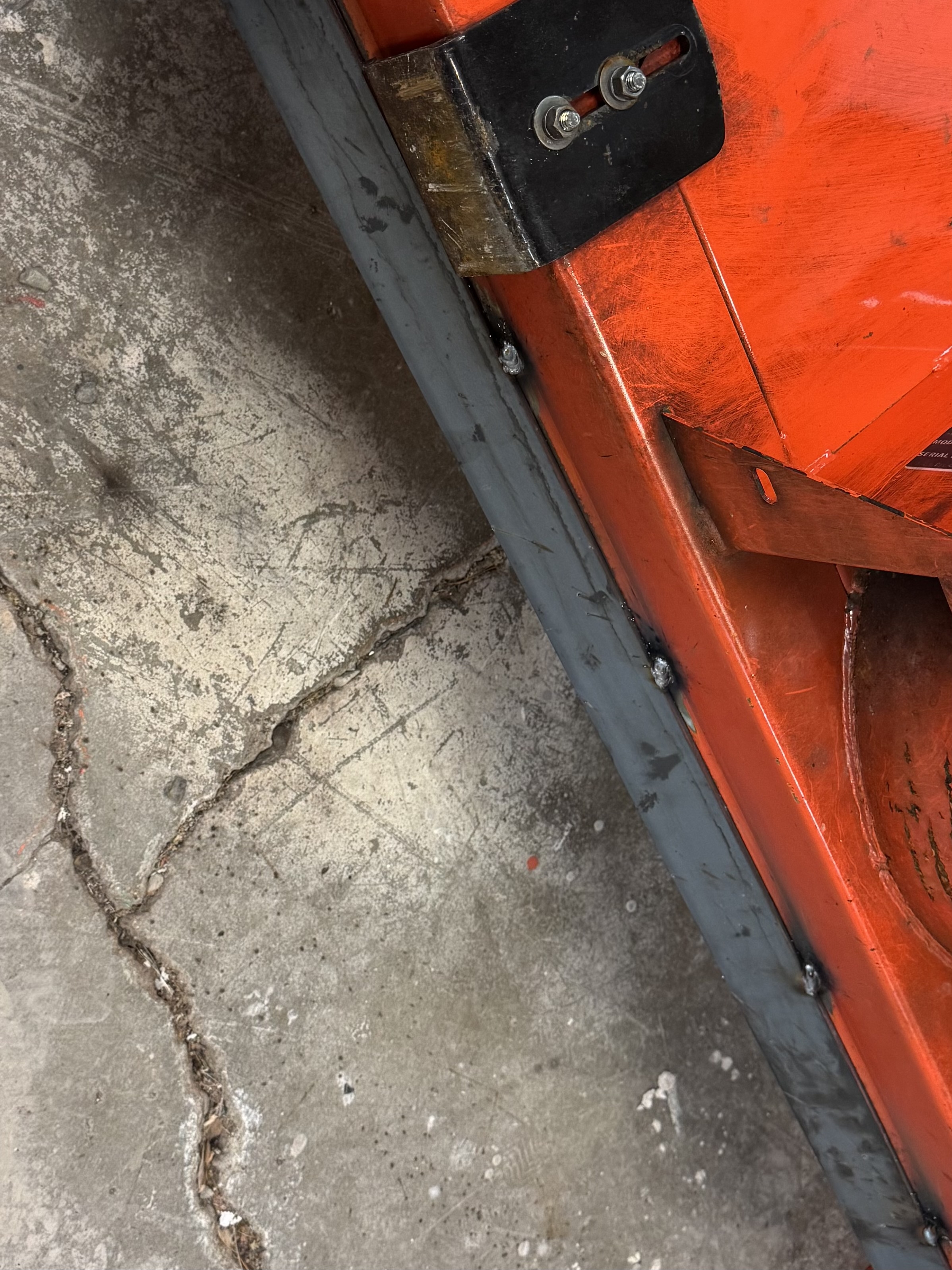

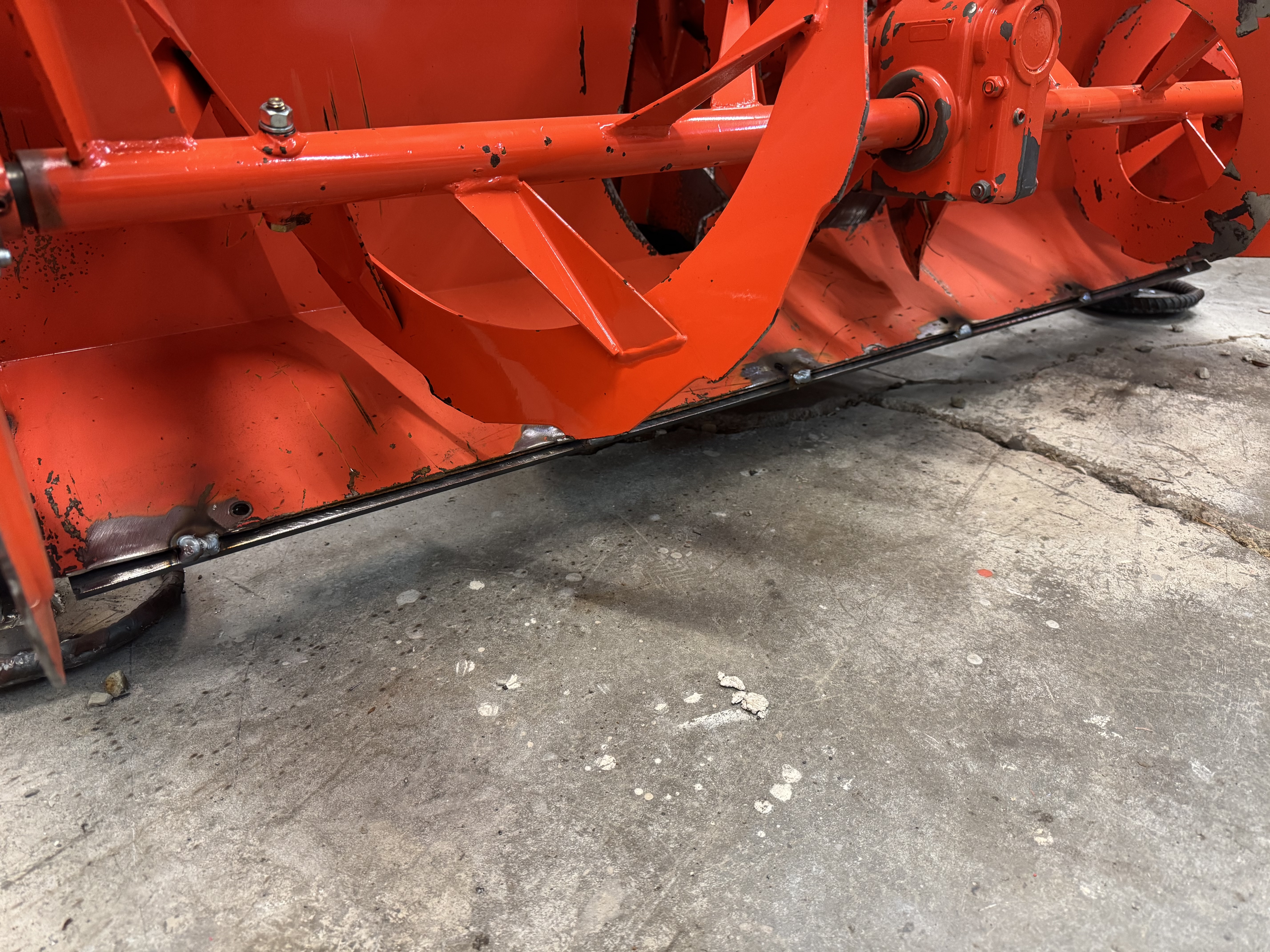

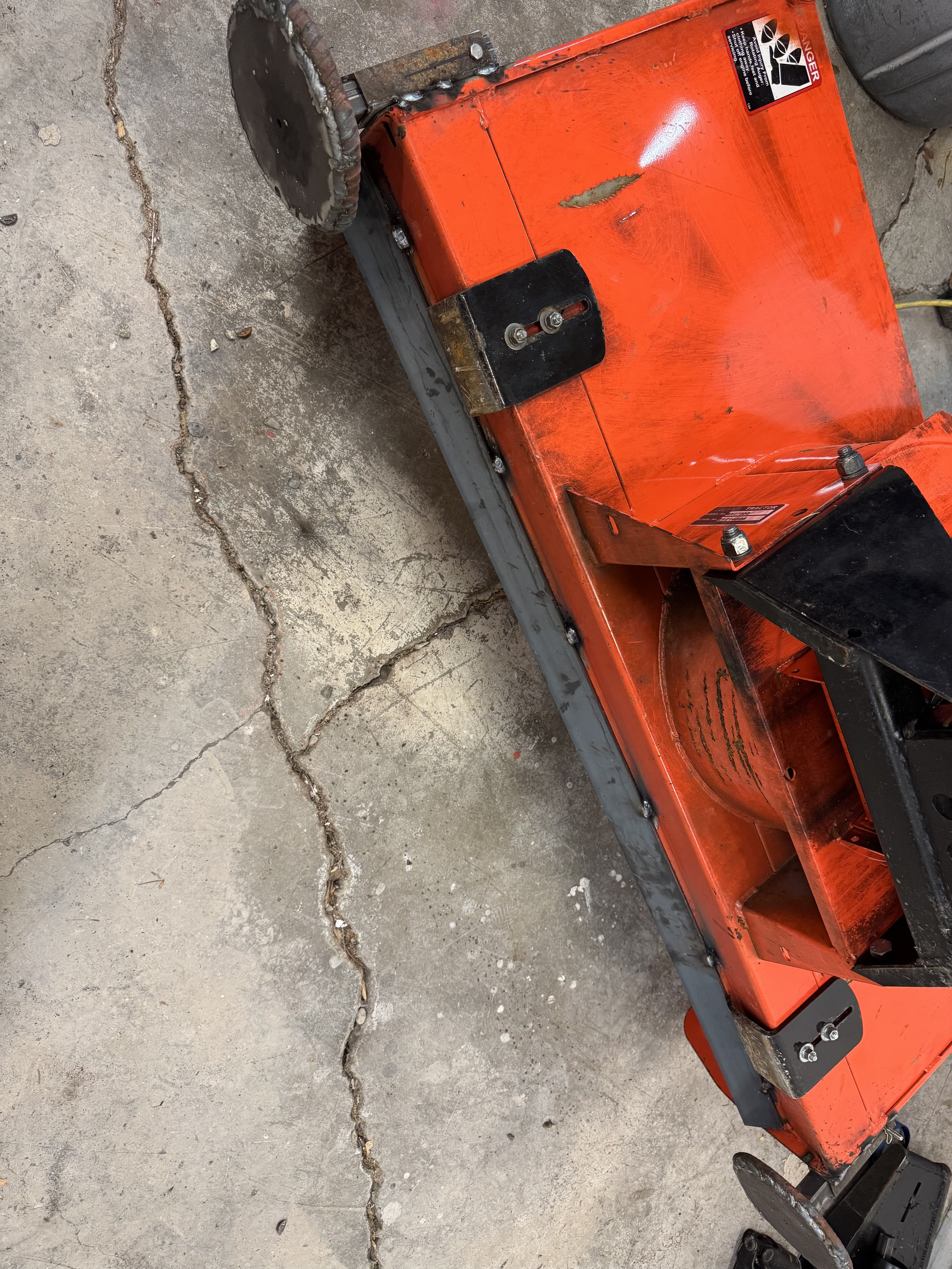

Just posting photos of the welded cutting edge. I do 1” welds set for deep penetration spaced where the bolt holes were.
If necessary a grinder could remove it in 10 minutes.
The outer skid pads were also just added for use on gravel. Made by welding rebar onto a plate. Three holes for height. Not tested yet.
