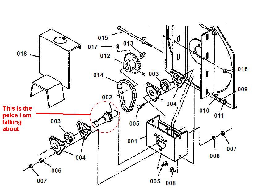

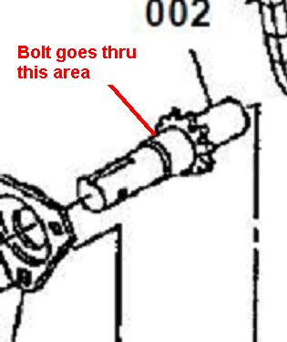

I was replacing my bearings on my bx2750 snow thrower and I noticed on the lower sprocket there was a bolt going throug the sprocket and shaft. I looked at the parts diagram and do not see that bolt. I bought the snow thrower used. I am wondering if that bolt is suppose to be there and if it is, is it suppose to be a shear bolt? If I remove the bolt the sprocket just spins on the shaft. Not sure what is going on!!!

I do see it on the 2750d My model blower is bx2750B Also where the bolt is on the B model is not in the same place as on mine on the D model it is just thru the shaft and the union mine is thru the shaft and sprocket.
   / bx2750 sprocket question #3
The newer version of the part(s) in question involve a single component, not two bolted together.
I had an older parts listing and when I tired to order both parts, the counter staff looked at me like I was crazy.
Your older version would require the bolt.

Looking at my manual it states:
Part 15 Hex bolt 1/4"NC x 2" part number 75599-01140 Code 0100010
Pat 16 Nylon Lock Nut 1/4" NC Part number 75599-31911 Code 1000003
