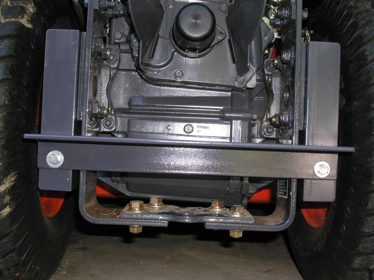

Here's a few pic's of a hitch one member made to attach his Cyclone Rake to the tractor frame (vs 3PH). This moves the CR closer to the tractor making the overall length less (good for tighter areas) and solves the issue of the CR going up and down with the MMM. Now I just need to make one for my BX/CR. :laughing:

Thanks for the help guys.
Chris, make 2 and I'll buy one from you!
