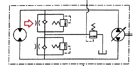

Does anyone out there have the HST hydraulic schematic for the BX25/xx60 line? I believe that the WSM contains this.
I posed this question in another post but it was buried and I doubt many saw it.
Thanks.

I definitely agree that getting a WSM is a good investment. However, even though I am looking for the HST hydraulic schematic for the BX25/XX60 series, I do not actually own one (I have a BX2350 instead) so It would not make sense for me to make that investment. I am only looking to see if Kubota re-incorporated a certain flow restrictor into the HST that was present on the BX23, but removed in the BX24/XX50.
Actually, I'll boil down my question even more. Pasted below is the HST hydraulic schematic for the BX23. Can someone with a BX25/XX60 WSM confirm whether the flow restrictor indicated by the red arrow is present or not? If not, is there something else in its place?

   / BX25/xx60 Hydraulic Schematic
Here ya go;
Awesome - Thanks a lot Artisan for talking the time to scan and post that. :thumbsup:
It looks like the BX25 HST schematic is unchanged from the BX24 series which is baffling because they definitely did something to resolve the reverse stop issue that was present in the BX24. I thought it would be evident when comparing the schematics. I was expecting to see something on the forward side of that circuit.
At any rate, thanks again for posting that.
